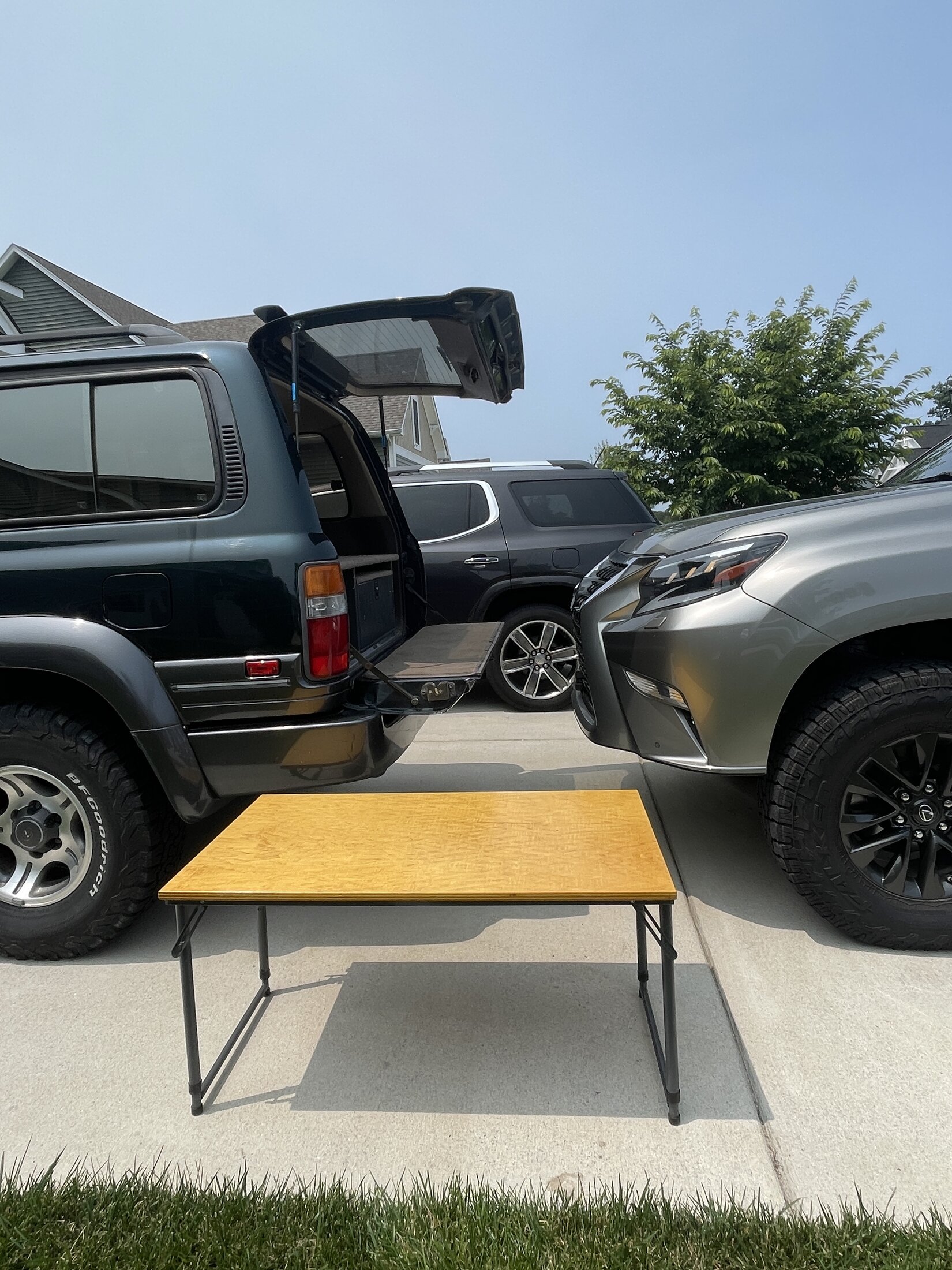

Is that a table I see hiding away? Looking good man
Correct….folding polished wood table slotted in there….i admit the drawer/table setup was already there, I just had to finish the top platform. I prefer mechanics to carpentry 😂

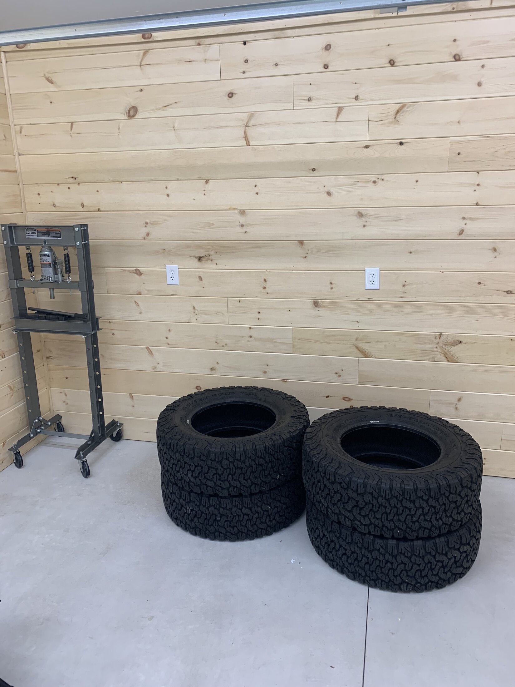

Picked up some new rubber for a screaming deal from a mud member out of the beach area this morning. This guy has built a bunch of awesome cruisers over the years. I got a ton of good advice on how to outfit my truck and am looking forward to confirming those thoughts with the 100 series guys next week!View attachment 3919199
Awesome Jay! Lots of options with your platform for sure. Id also look at other build platforms 80’s 60’s and even jeeps and Landrovers.

Did you build the table ? Lets see it. Im a sucker for tables lol

Nice! Look forward to chatting
Size?

Table came with drawer setup when I bought the rig. Pretty nifty, adjustable legs and all

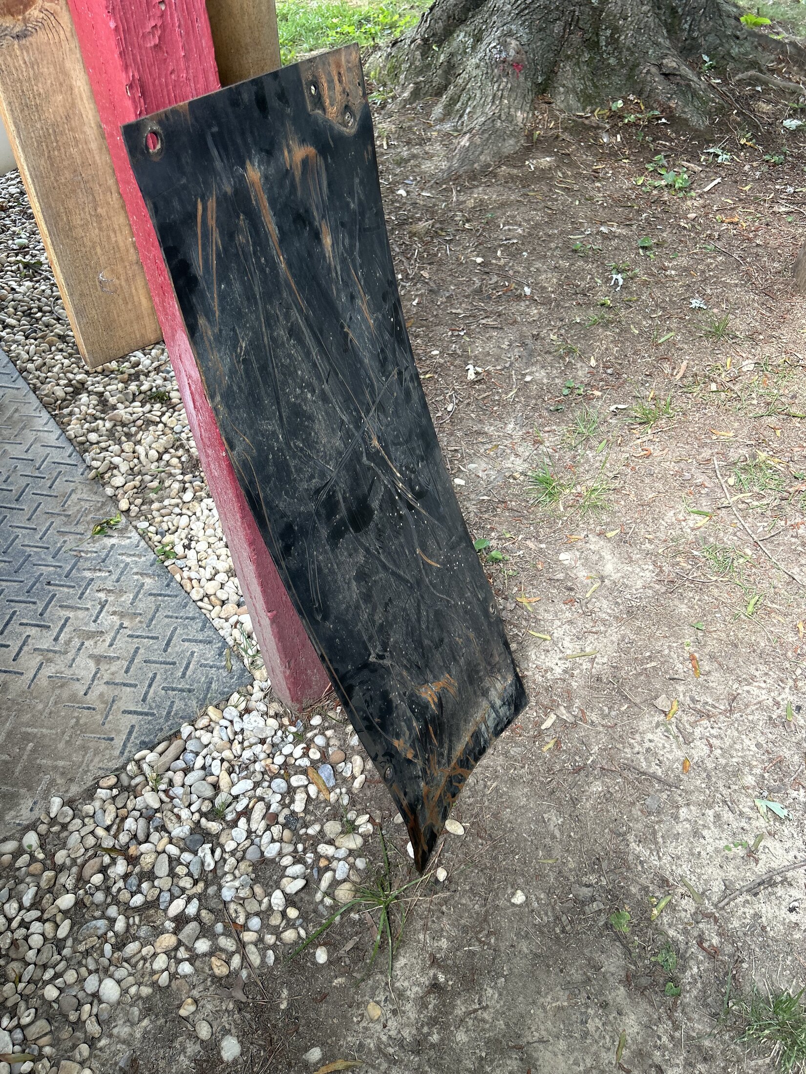

My trans/front driveshaft skid. should have made it thicker from the get go. Remaking with 3/16 and will tie the TC skid into it as one piece now

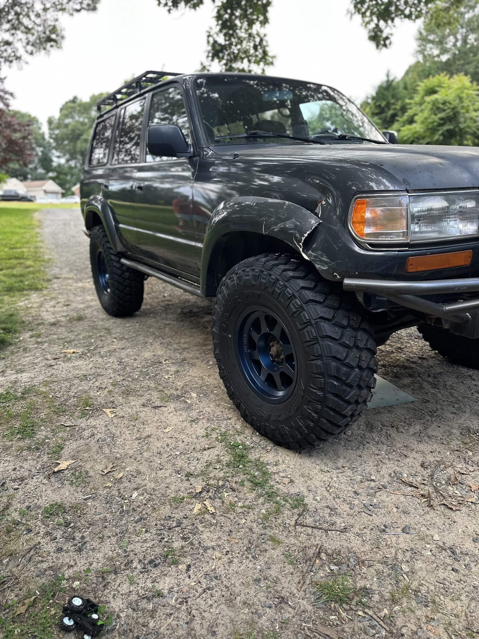

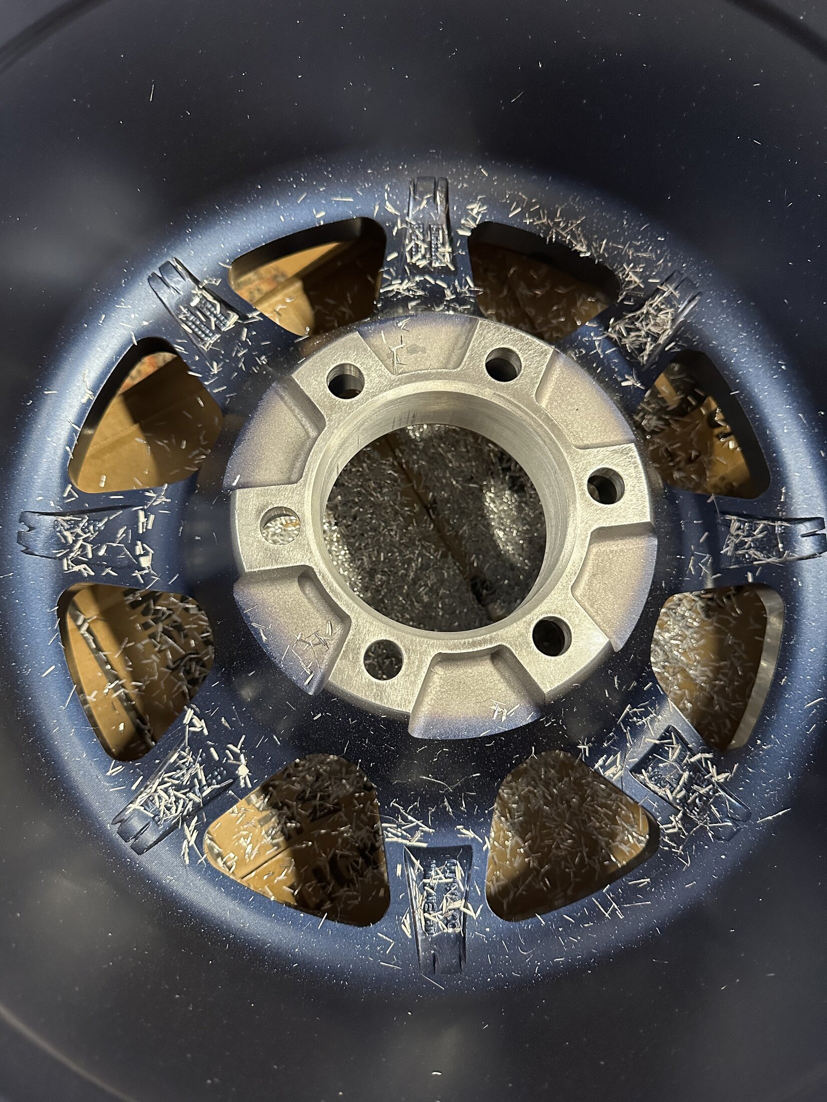

Got some Method bead grips awhile back and finally got them mounted. I’ve always liked their blue but they don’t make a blue bead grip that fits without modification. There is a lip on the inside that prevents the wheel from sliding over the hub. Took a top bearing flush cut router bit and removed said lip. What a thing to do to new wheels ha. Wheel no longer accepts the center cap but does slide right over the hubs.

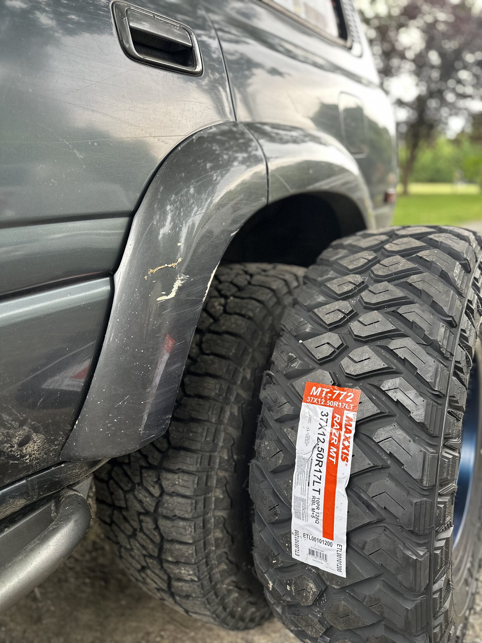

Rob was so kind to order me a set of Maxxis Razr MT’s and mount them up for me. 😎
Really looking forward to breaking these in at Potts.

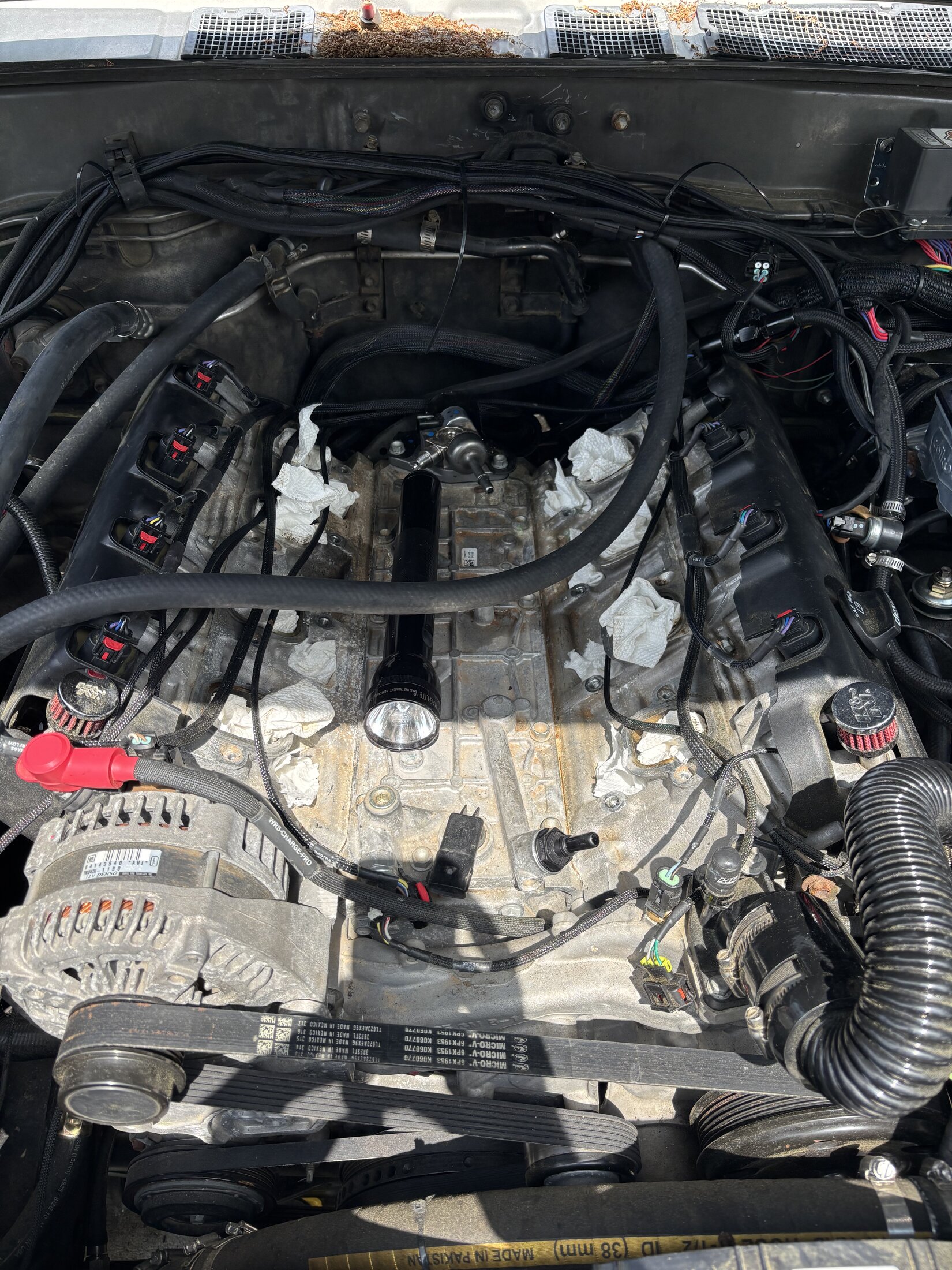

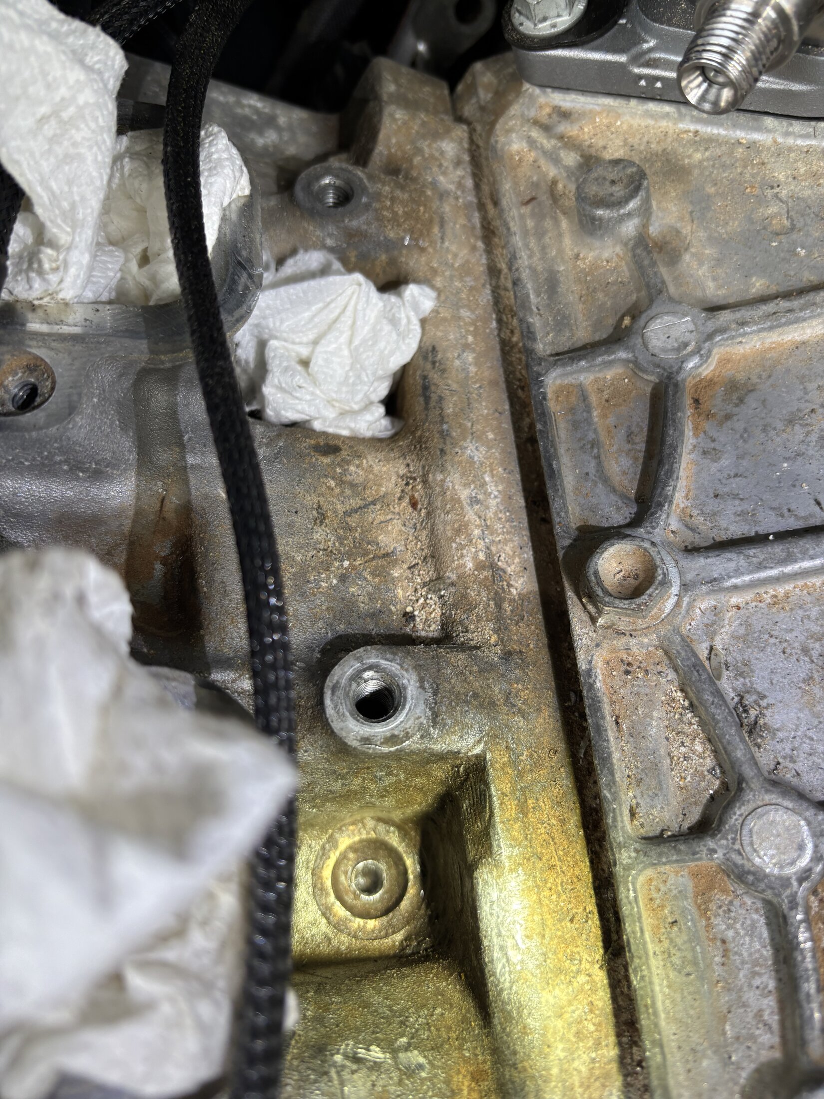

View attachment 3923252View attachment 3923253View attachment 3923254
Oh my.... looking forward to celebrating this....I mean you tomorrow
you might want to pull the plugs spin it over so it will not hydroloc. and also clean the cylinders out.
Now you’ve got me thinking about maybe really tearing into this thing and doing the DOD/AFM delete. A little spendy for the cam shaft and new parts. What do you think?
Not a bad idea. They do have lifter poblems with that DOD.

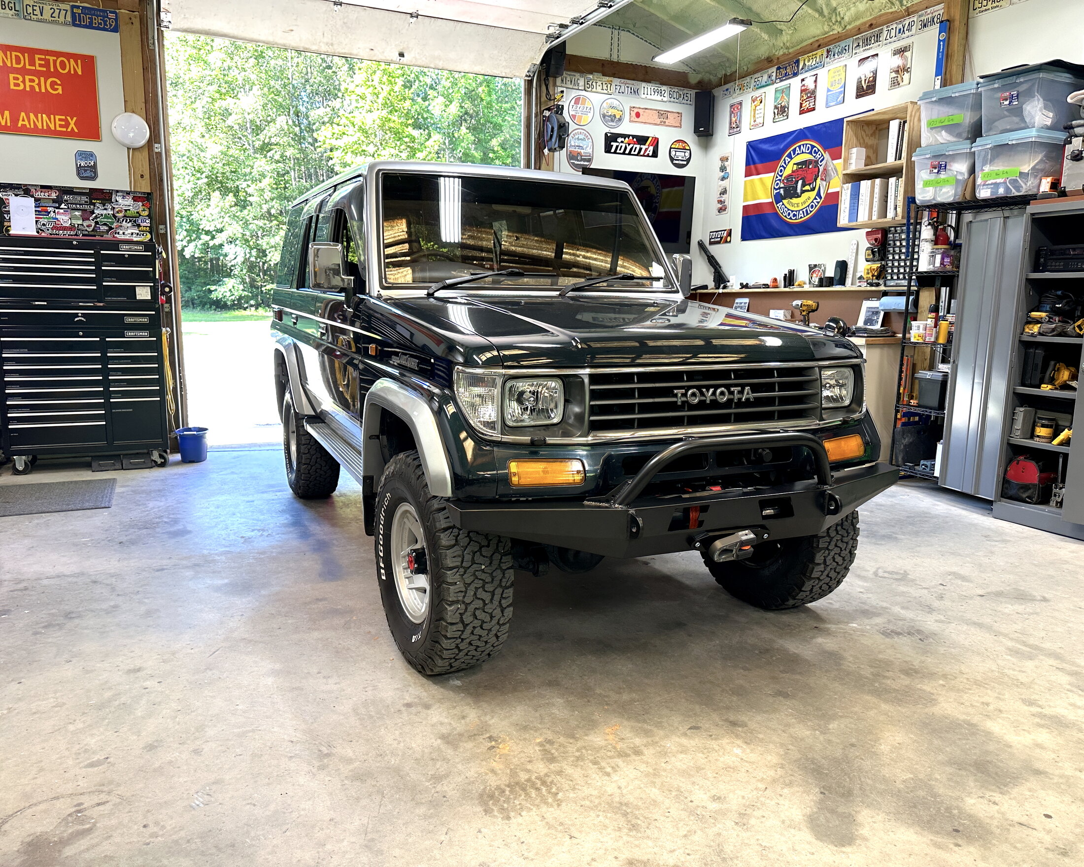

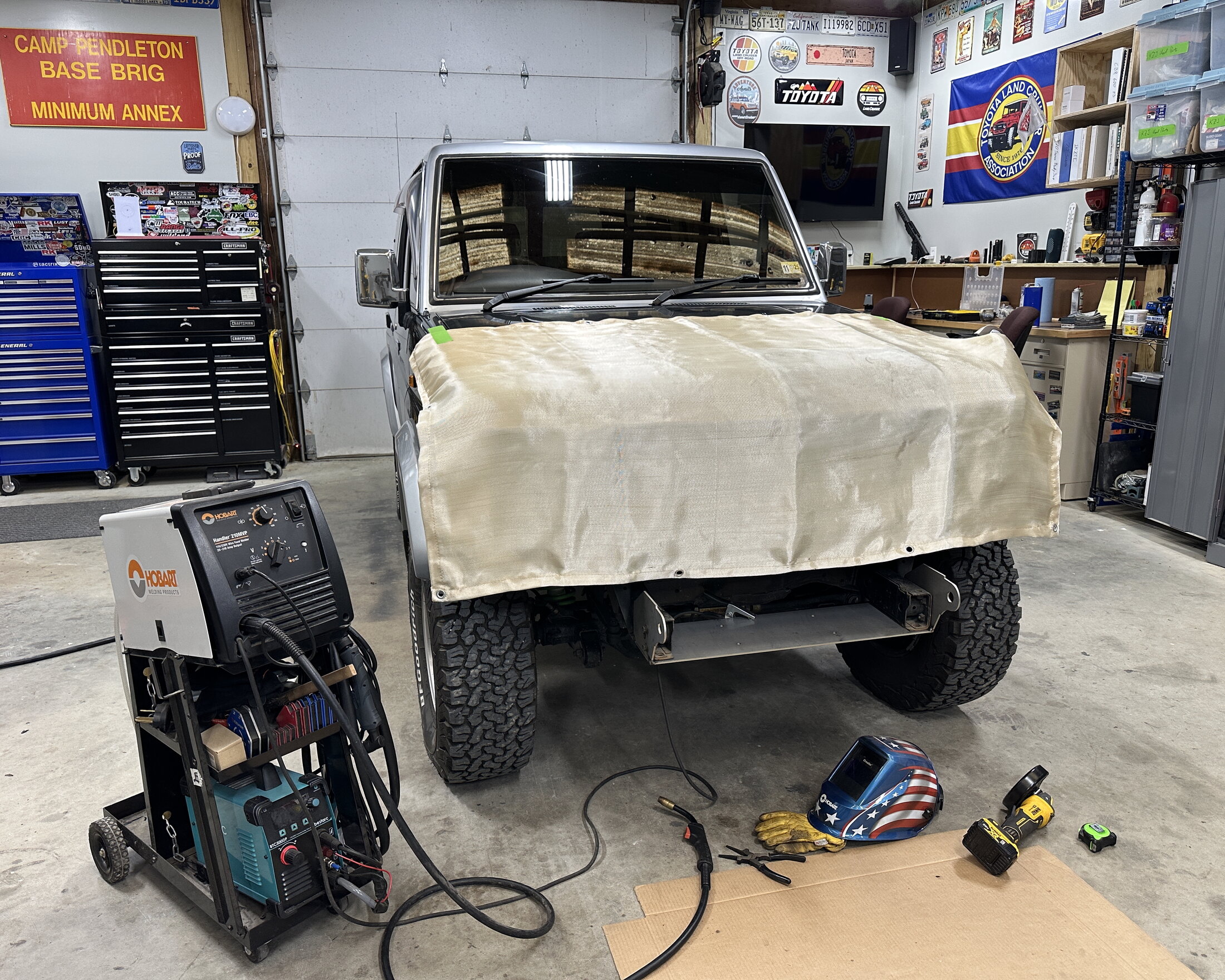

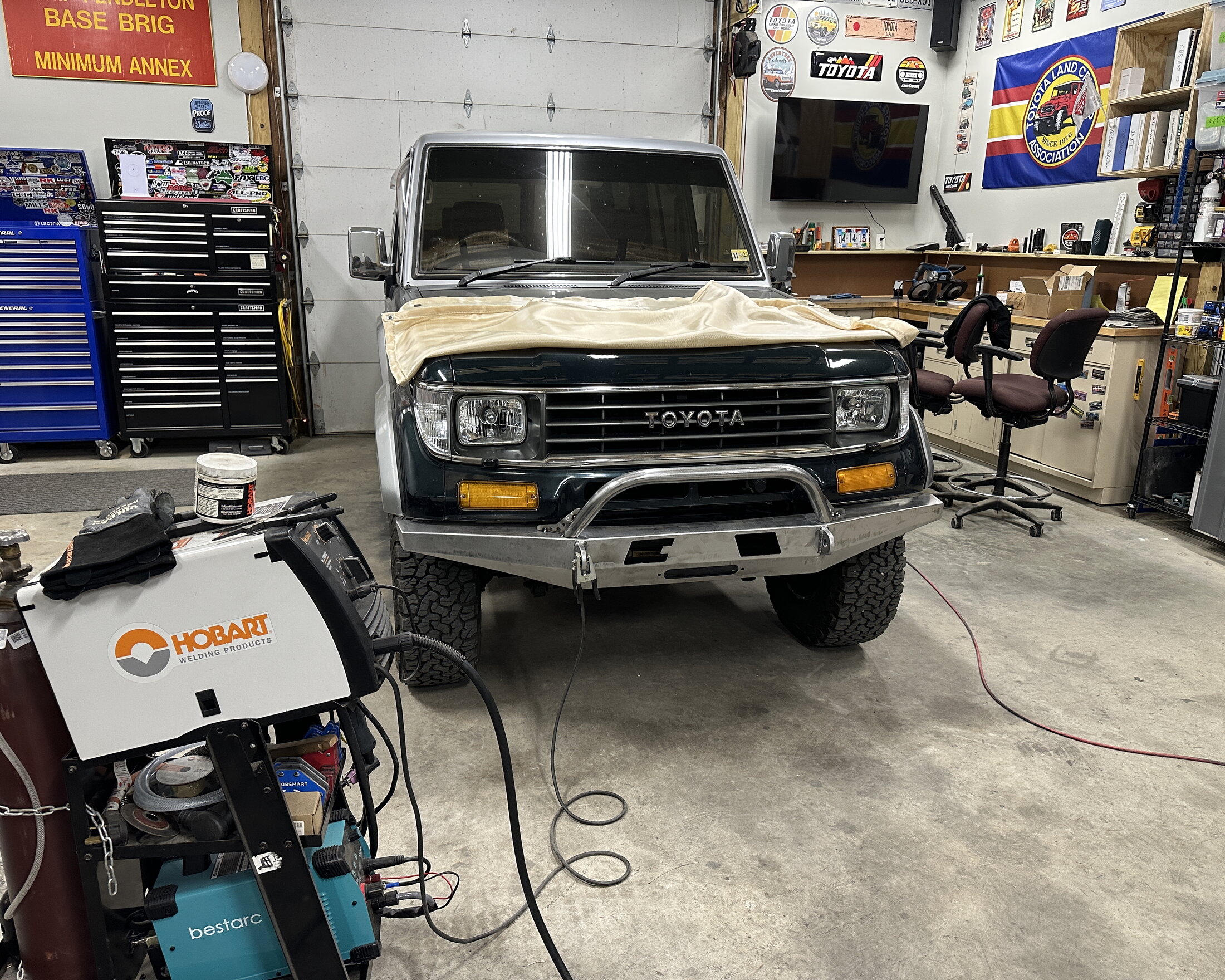

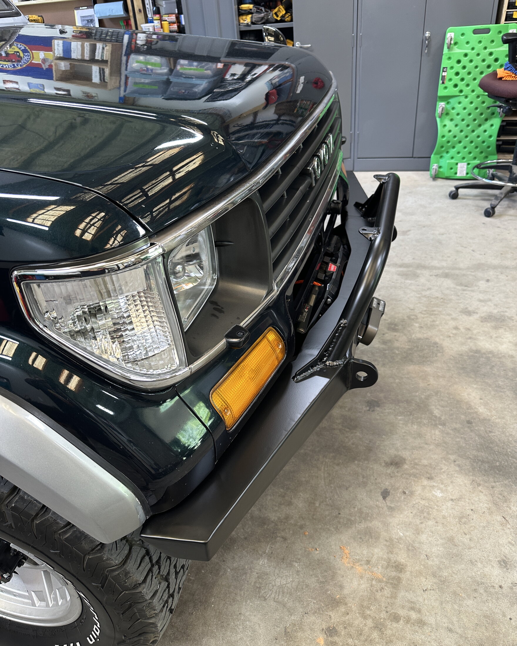

Been working on a Coastal Offroad bumper for my 78. Just got it back from the powder coater. Still need to finish the control box relocation under the hood.
When are you going to bring that to a meeting? I am sure everyone would like to check it out!
Hopefully sometime soon. I work at Quantico so the schedule just hasn’t meshed up for me yet.

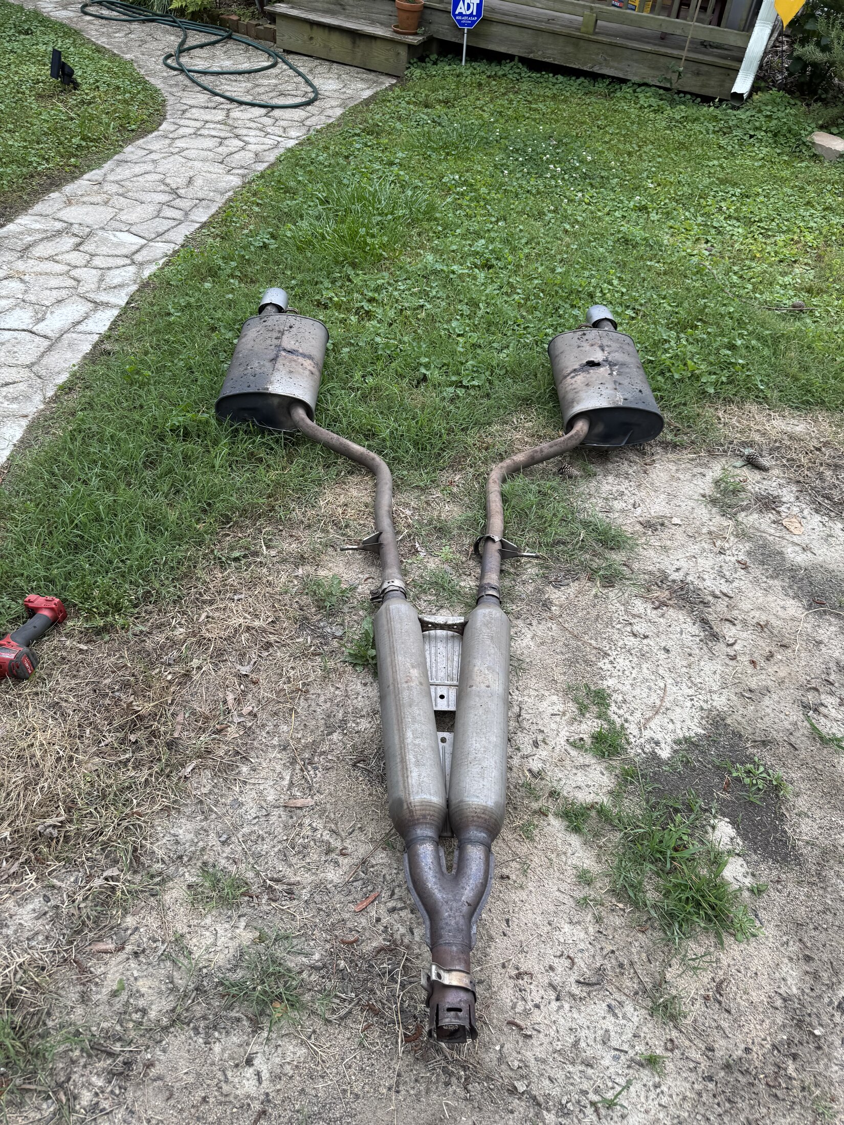

Not a cruiser but finally found a decent set of replacement mufflers and a midpipe for my LS430…It’s a lot quieter outside now not that you could notice in the cabin before. Just a bit rusty. lol. Only took 2 hours to pull and replace so easy job. Now just to fix the busted bumper when the rest of the parts arrive
