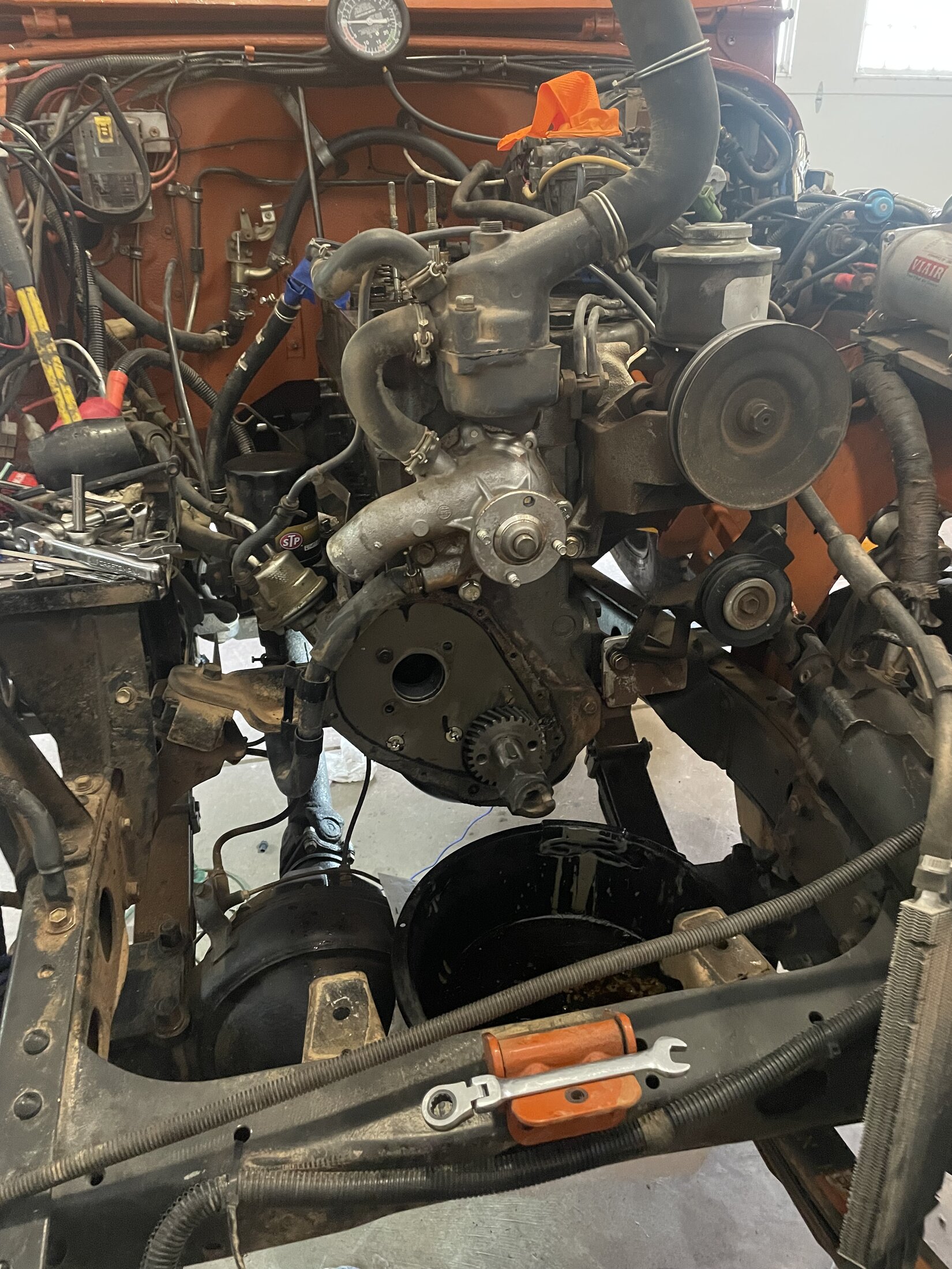

Been wanting to replace the cam on the 2F. Going back to stock profile so I can get my vacuum decent, before I go TBI. Finally got a time. Need to press cam out of timing gear and press in new cam tomorrow at work. Then start reassembly.
Very nice!

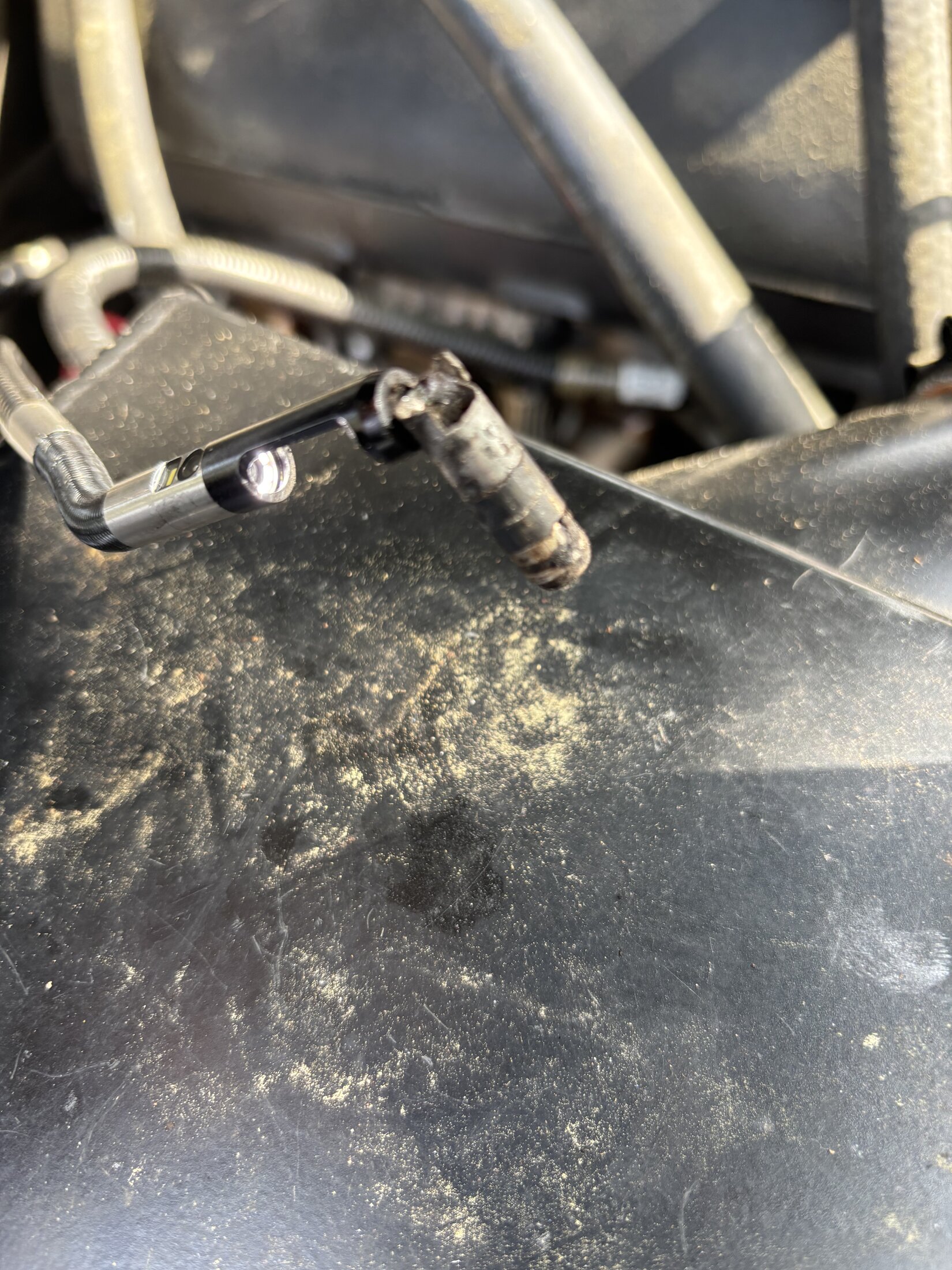

Is that the injector tip?
Yep that is the injector tip. There was no conceivable way to pull it out, so i had to tap it through into the cylinder and get it out through the spark plug port with the magnet / borescope.
Wow nice work glad you got it out. Good name for it lol

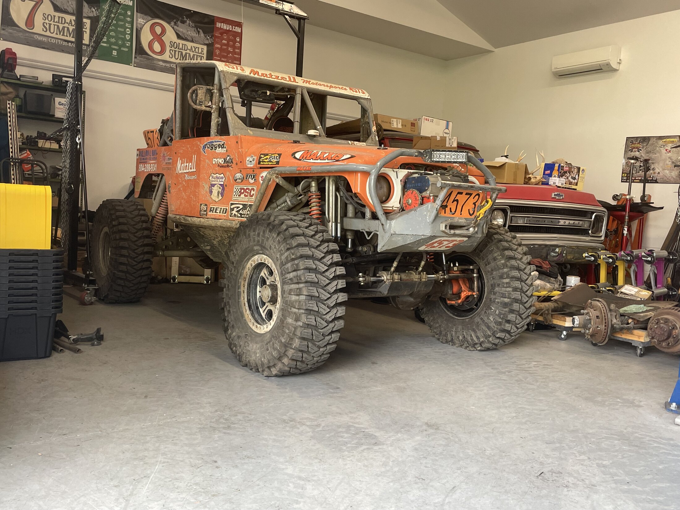

I moved 4573 back into the garage. Now to clean the rest of the trailer out. Gosh I have missed seeing it. Plus I opened it up going down the street to the amusement of my neighbors😁
Better get to work quickly on the expansion!
Damn dude! Thats what GX people upgrade too...
