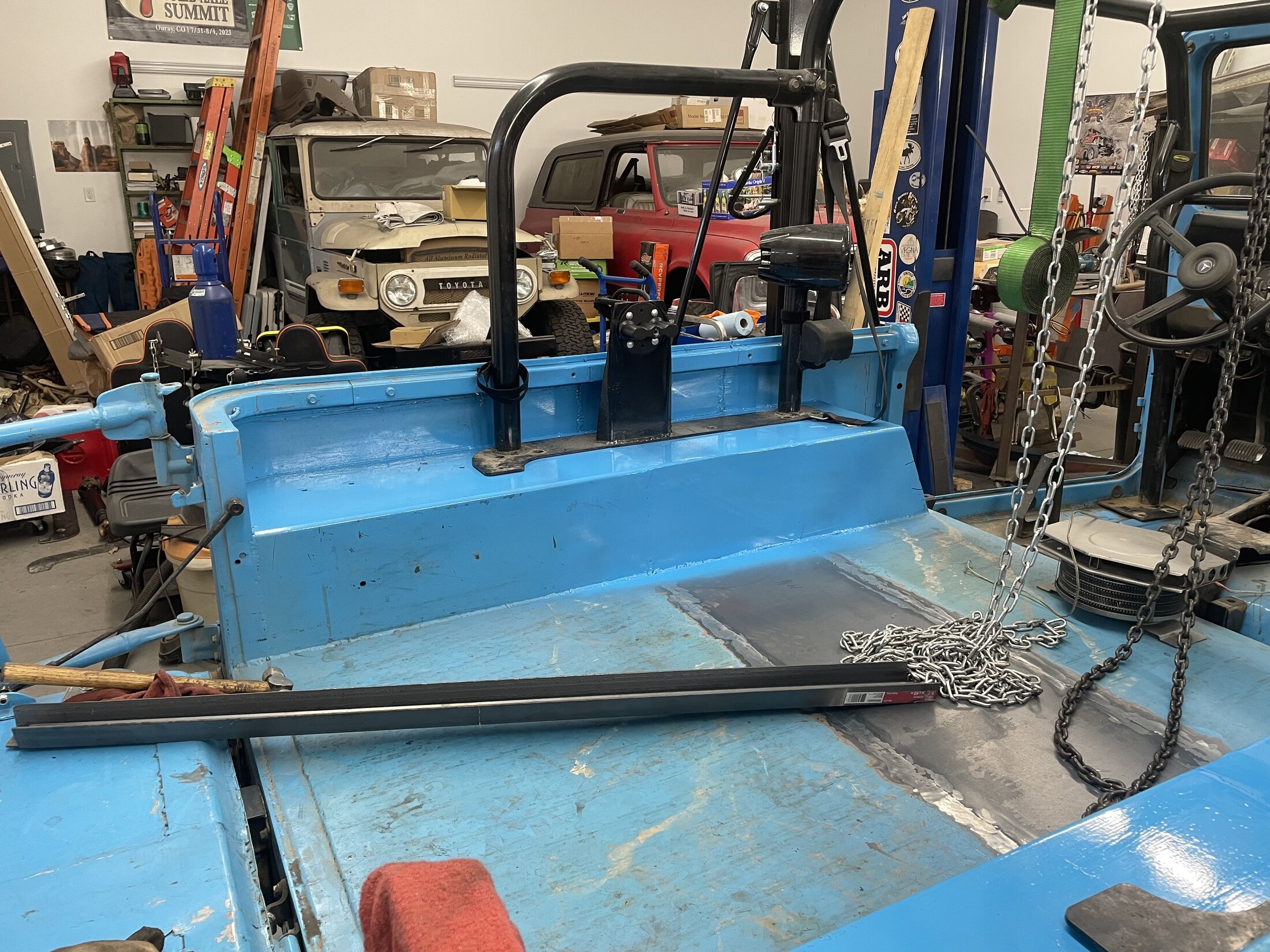

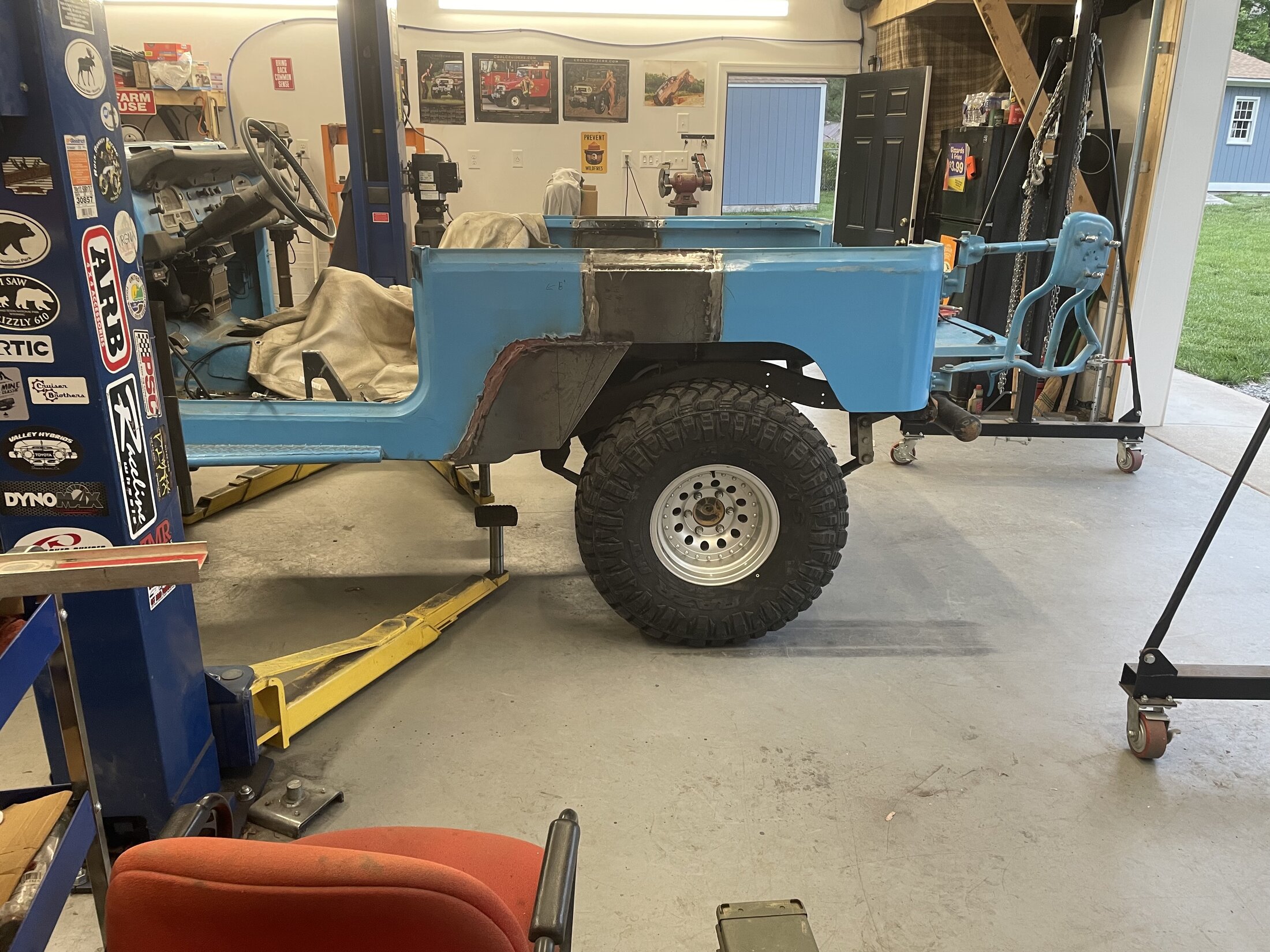

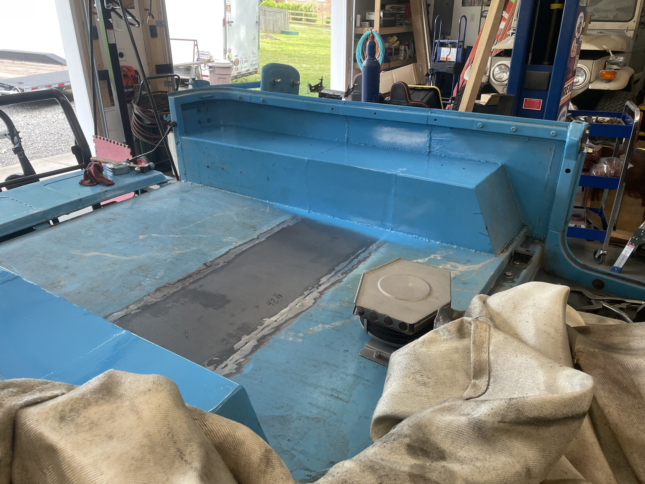

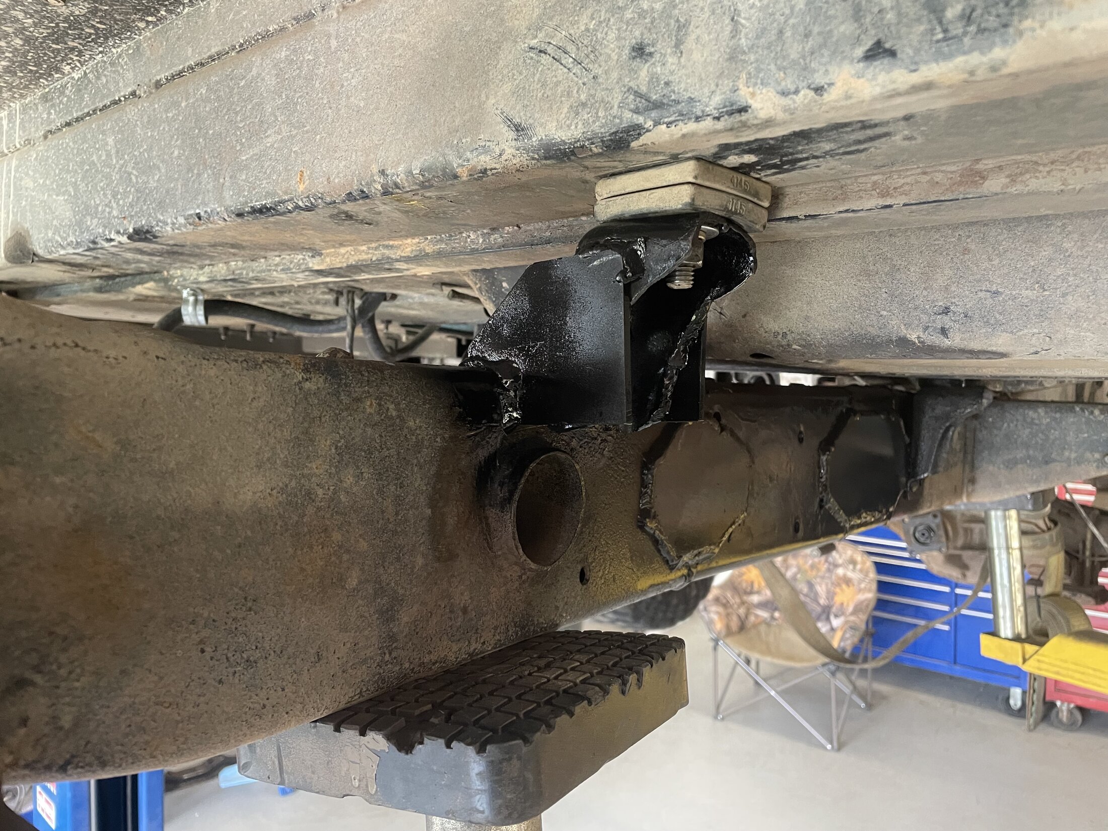

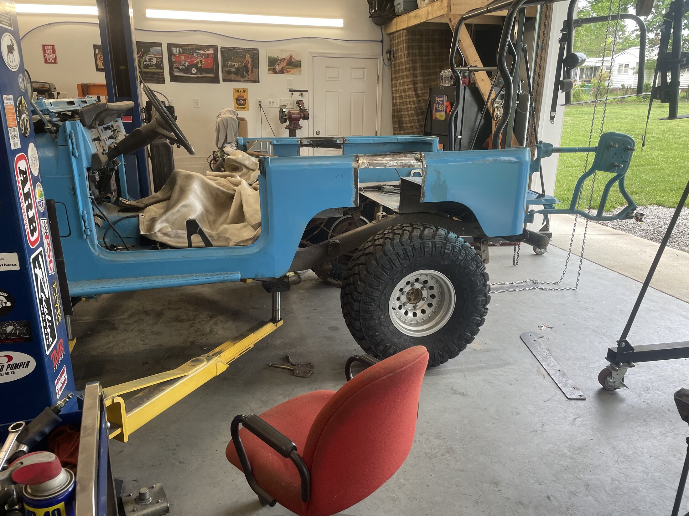

So I burned the frame in and added fish plates to it. Then started to line the body up. Had to stop and install a roof rack on Betsy's 4runner with the help of @Land Shark

Good progress made, slow but getting there. Two good long days this weekend. I have been posting in my build thread over here:
