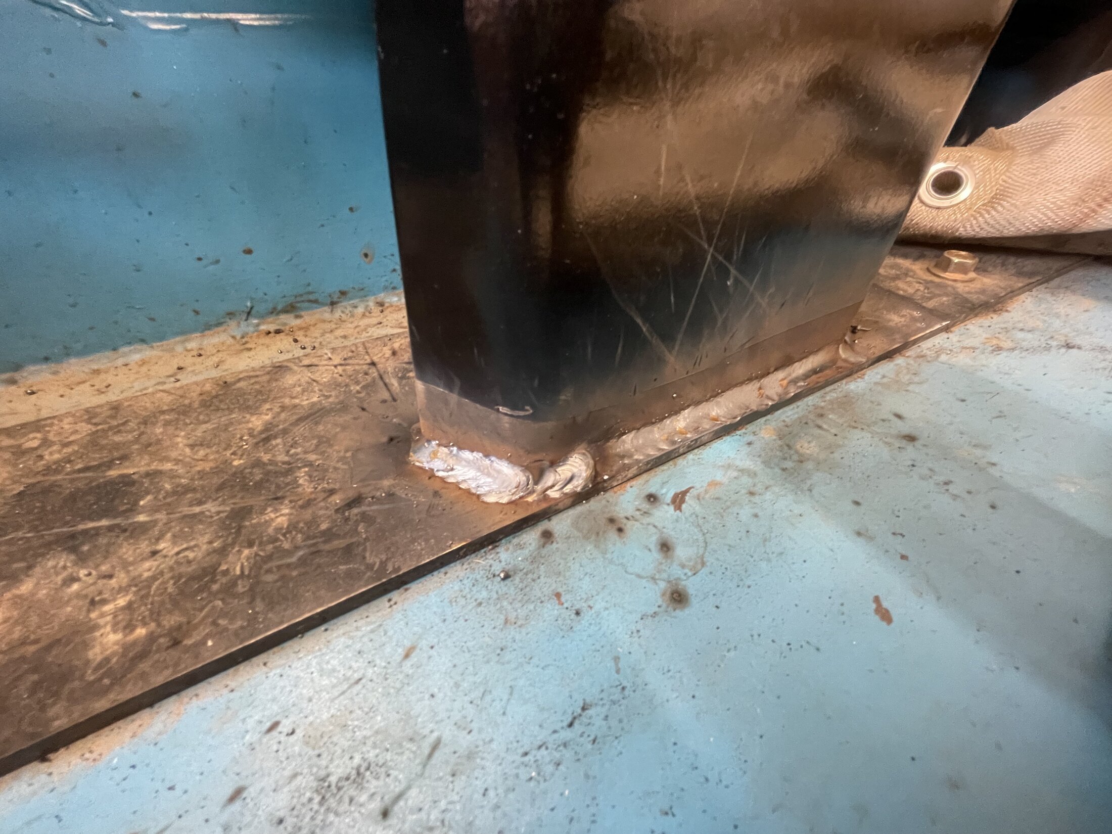

I took the mount I got from @Land Shark and made a mount to install it in the 40 along with a 3 gal has jug. Now to get the adapter to add back a 2 gal water, but it may be too heavy? I may need the extra fuel at SAS 8 and Moab next year.

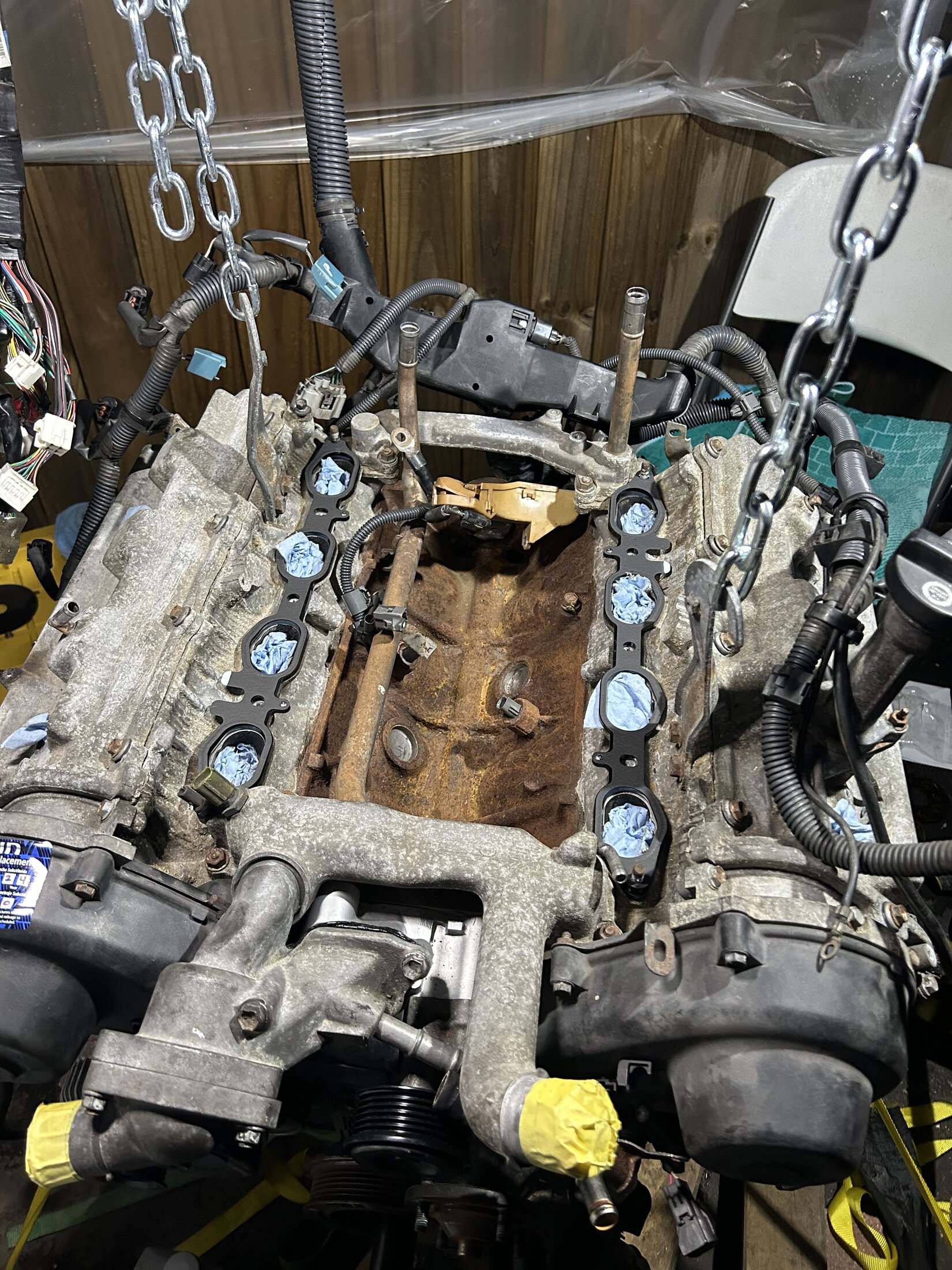

Now that I determined engine is all good I'm jumping right in. Timing belt job way easier with engine out. I'm scared when I have to do it to mine in the bay. Find the banquet

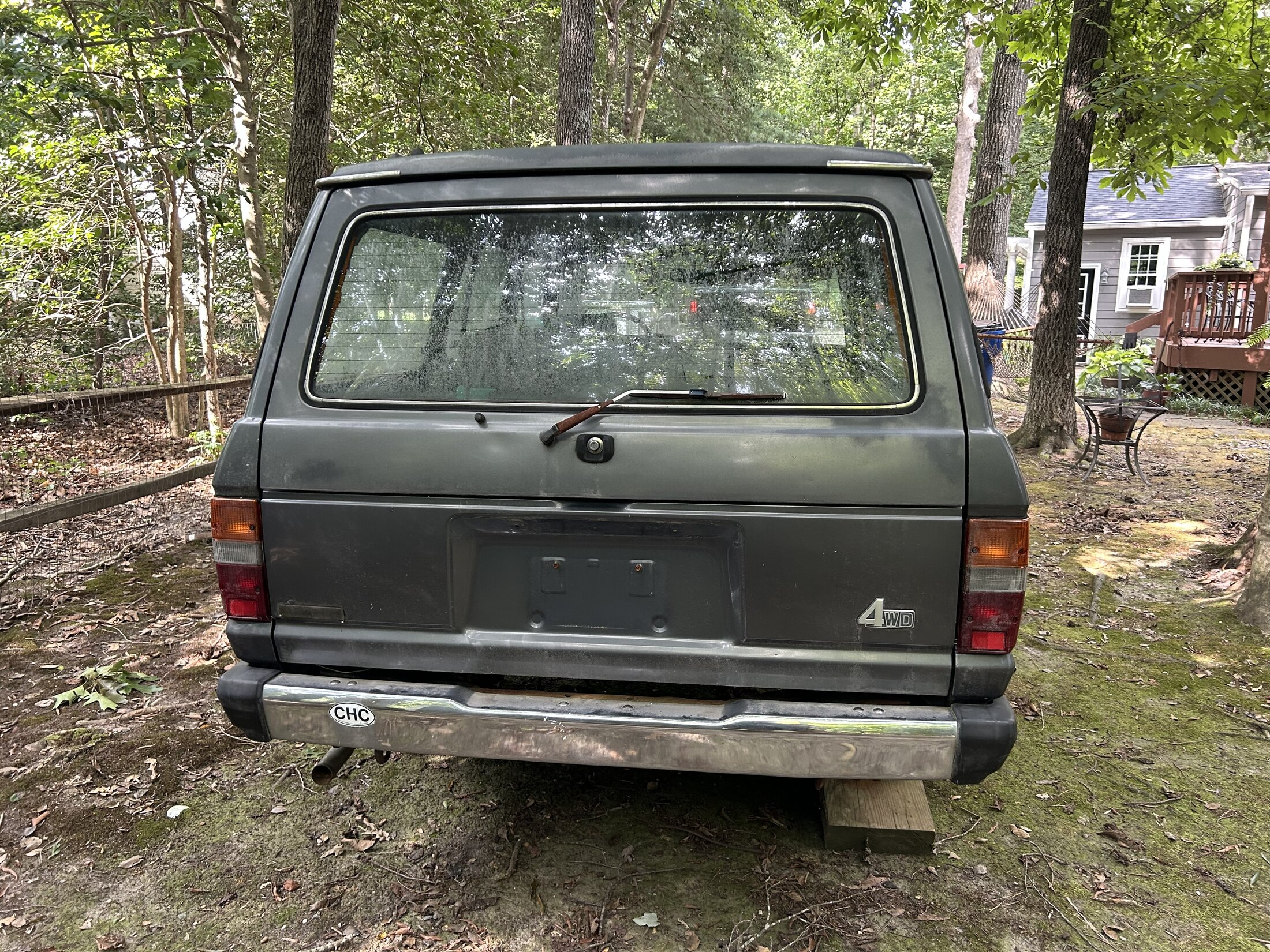

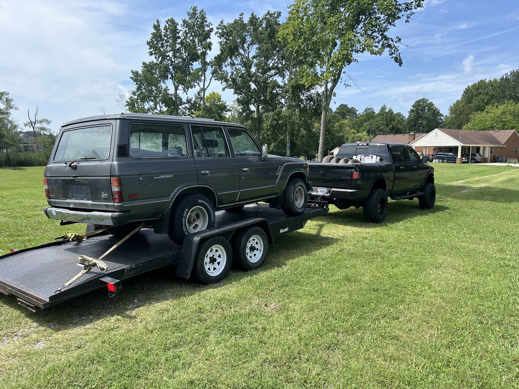

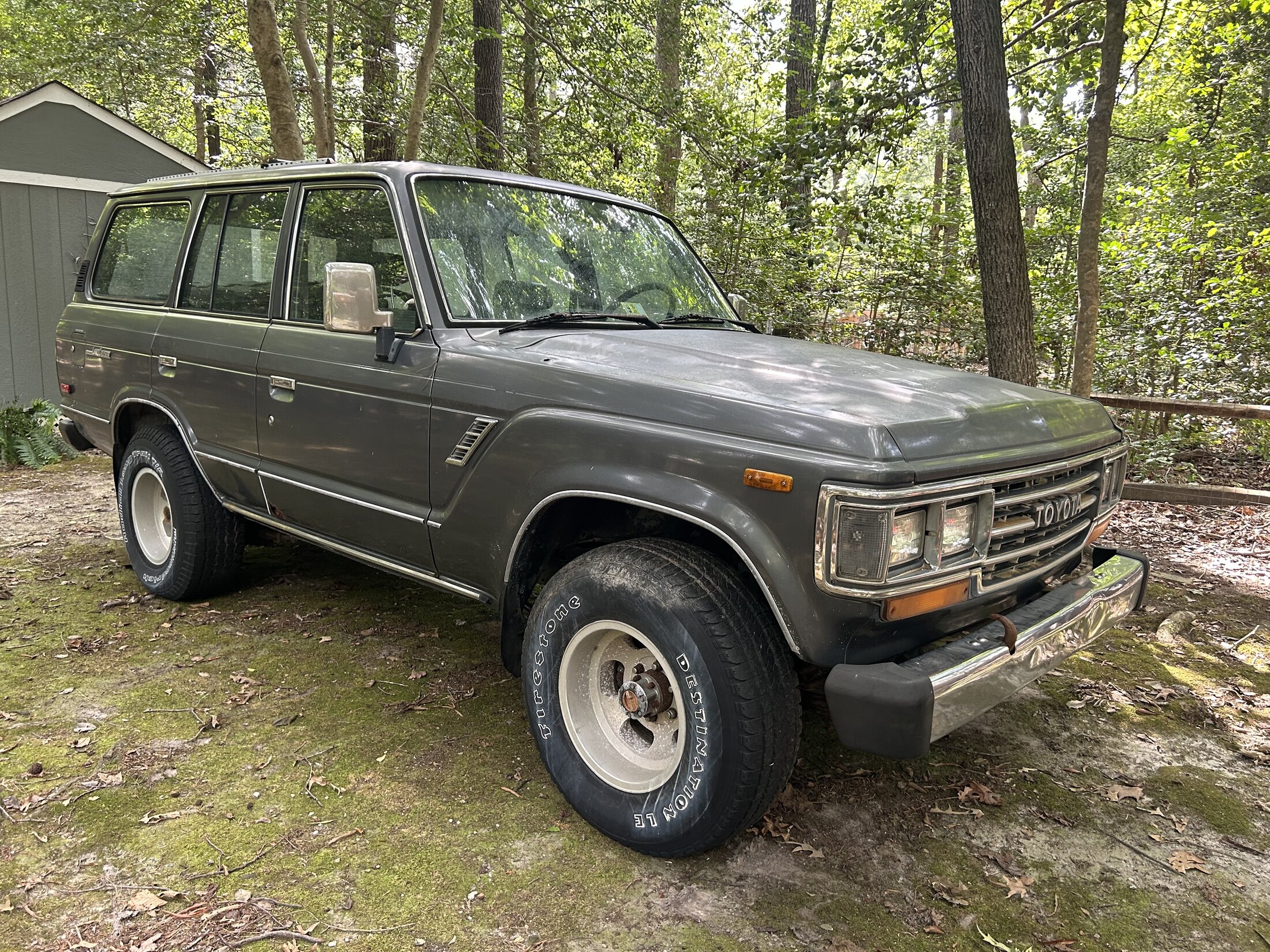

Blaming/thanking relic run for giving me the 60 bug after seeing moonshine and cruiser Matt's epic and super capable builds.
1989 somewhere around 300k but no dash so unconfirmed. Long term project hoping to put an LS and spring over axle but who knows!! Super pumped. Little to no rust on the frame and only some spots on the body worst being the floor pan in the foot areas in the front. Shoutout to my neighbor who helped me with his truck and trailer. Real hero.
