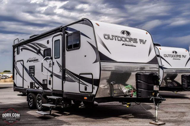

Trailer is 23ft long by 11 ft tall - outdoors RV 21DBS. It’s slightly taller than most trailers but not by much. Cold tire pressures are 42 F and 44 R.

Wind resistance is a massive factor with our 200s. Is your trailer basically this?
If so, I’n not quite as shocked...especially at higher speed. You’re probably 12,000lbs including an 11ft tall sail in front, with a big square in back at highway speeds.
Just the weight and poor aerodynamics of my built, bumpy 200 went from 19-20 mpg highway (mild lift, AT tires & sliders) to 11-14 (fully built, bull bar, rear swingout tire, and more) highway largely because of wind resistance at higher speeds.

11' tall combined with wind is a killer, and potentially the speed you are trying to drive.

Curious as to what the OP expected the MPG to be? In stock form the MFG MPG figures are 13/17 and pretty much accurate. Then add an eleven feet tall and 7+ feet wide and 6,000+ pound trailer to the lifted truck with larger tires ...... was the thought that this would just shave a couple of MPG towing in the mountain west? The trailer weighs more than the Cruiser after all.
