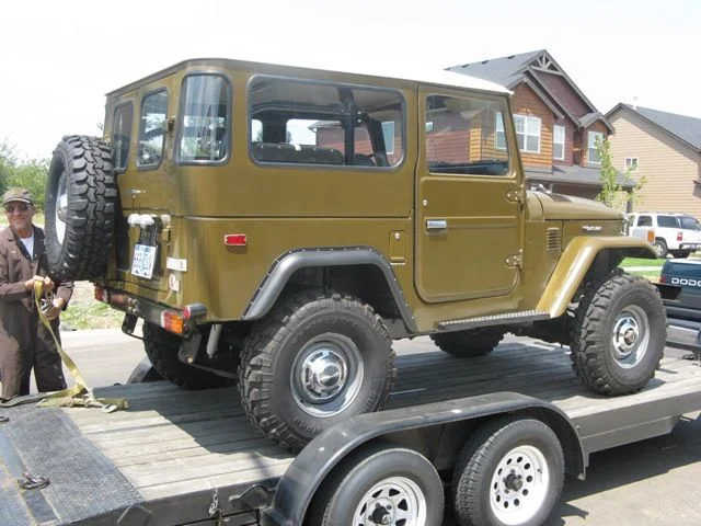

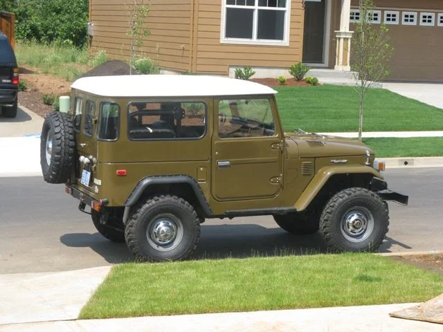

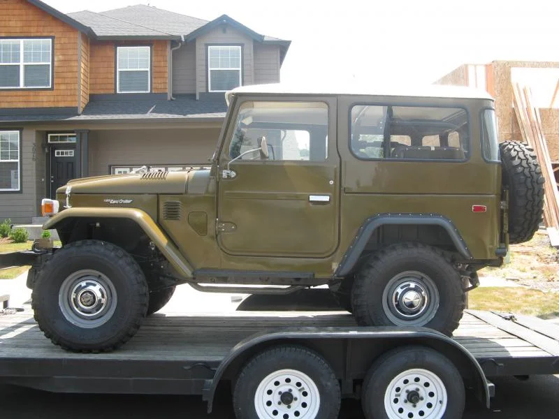

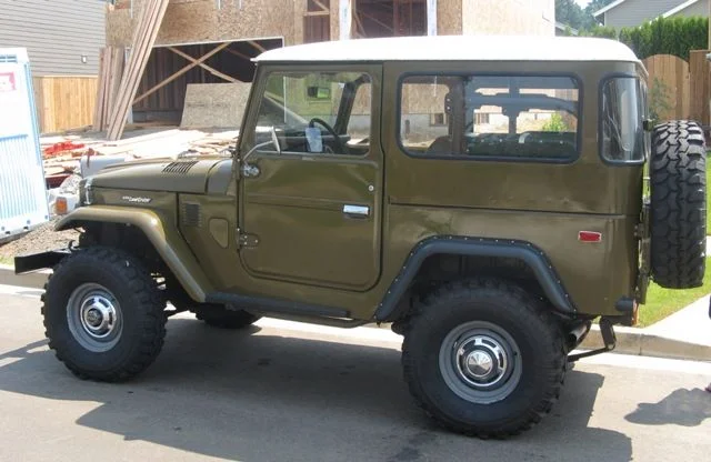

Olive 653 with ACE, and valspar LIC 30 Clear Coat...
more...
Shot with HF HLVP gun... Total cost of paint job was about 250 or so.
Positively sexy!
looks great! what primer did you use? how many coats of each the ACE and the clear coat? and what did you dilute with? thanks!

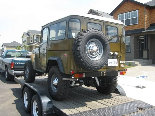

Hrmmm.... :confused:
Thats an OEM exaust system bought new here at Capitol Toyota. I used all factory mounts etc...
And it looks ok too me!
I think mine hangs down a bit, too.
And I like the look.

REPOST: looks great! what primer did you use? how many coats of each the ACE and the clear coat? and what did you dilute with? thanks!
I used the ACE primer. I used Mineral Spirits to dilute.
I painted 3 coats of primer, 4 coats of ACE, and 3 coats of clear. Mixed the clear with enamel thinner and hardner.
Sanded the primer with 220 - 400
Sanded the paint with 400 - 600
Sanded the clear with 600 - 1500
Very nice...
Thanks, thats what I wanted to know.

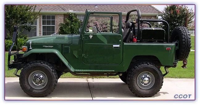

As for the green one above, you know what color code that is?
