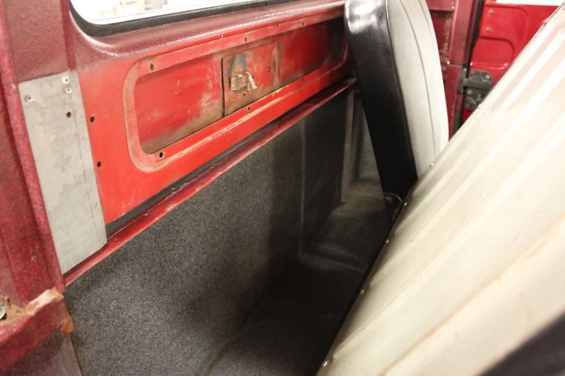

anyone else scared of how the frame was sectioned?
is it red or maroon?
WTMF!?? This is insulting to the entire Land Cruiser race. Looks to be a 40 grafted into a 45 cab with a 70s hilux bed...why doesn't the seller mention this anywhere? "THESE PICKUPS ARE BECOMING MORE RARE BY THE DAY"...huh? Maybe I'll call the guy and ask him a few questions. Nothing wrong with frankenstein projects...but at least be honest about it.
that frame graft is scarry looking, doesn't even line up.. and it looks like a shortened fj40 cab and top.. amazing that they painted the outside but left the rear axle rusty.. interesting to do all that work and to a fj40 when they could have restored a fj45 alot easier..

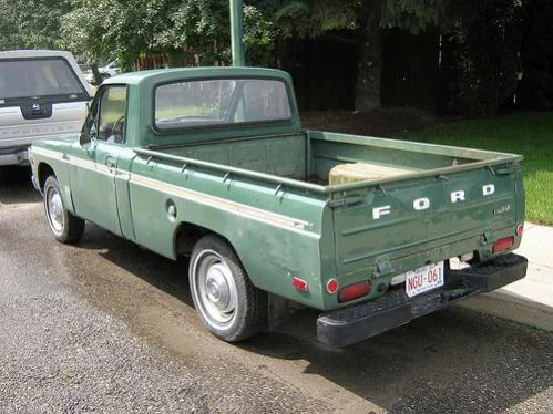

I couldn't resist.....WOW
Nice truck if you were looking for a Ford courier/FJ40 Hybrid sorta kinda thing. How about an FJcourier........or Ford40....
Wrong
So someone cut the back off an early FJ40, spliced a rear section of the lift top door of a 40, and glued on a early Ford Courier bed with some possible frame modifications, then listed it as a FJ pick up, Rare. No reference to FJ45, Nice play on words, stays away from saying FJ40 modified to be a pick up. Well as far as I am concerned the dealer (seller) is selling this vehicle under false pretenses (false advertising). Most all car dealers in the states are required to list any major changes to a cassis or body. The vin will show it as a FJ40 not a FJ pick up if that vin was not changed. Without going on with more legalities', the new owner can and should take it back and get a $17,000 refund or sue if they believed they were getting a real FJ45. This was a good catch to post on Mudd as far as I am concerned, to help NEW folks who are new to Land cruisers to help see what is real and what is not. BE carful and stay away form fly-by-night dealers, buy from Mudd owners. I'm not sure if it did sell, anyone know?

not a 45 cab. that's a shortened 40. look at the fuel filler. a 45 cab would have a normal recessed fuel filler. probably why the frame graft was required. also the vin is FJ4034105. it's an early 65 fj40
