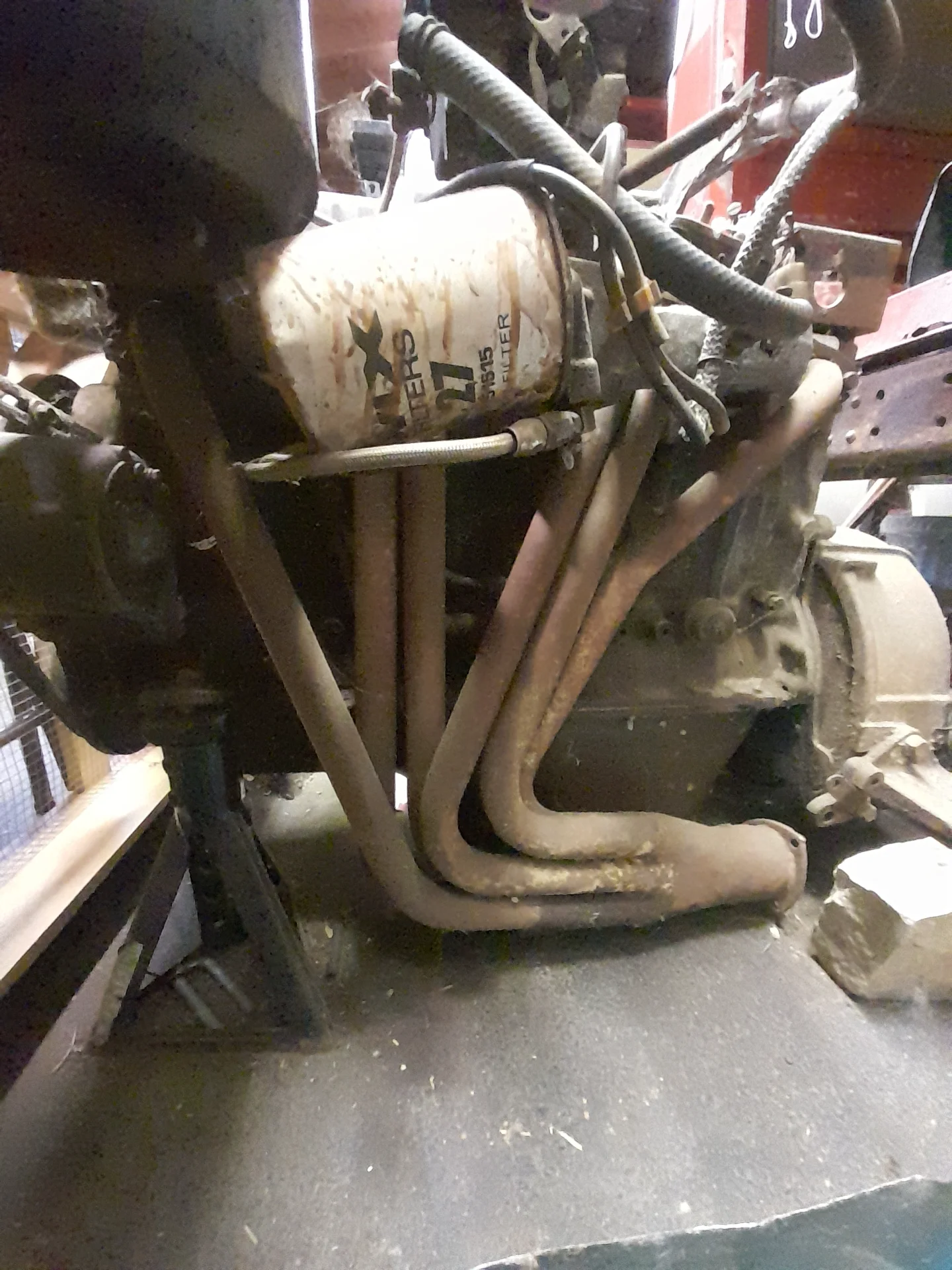

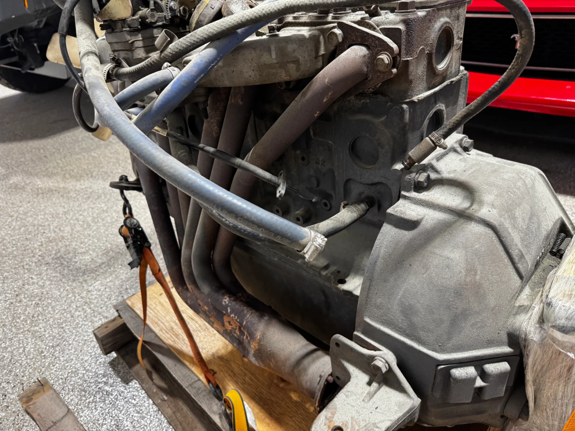

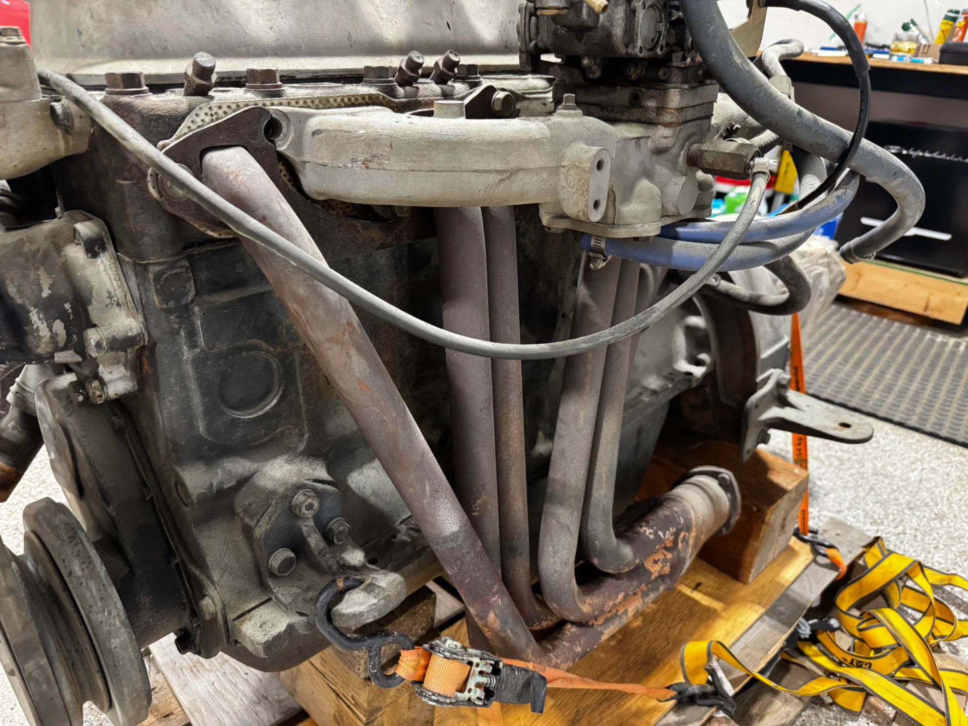

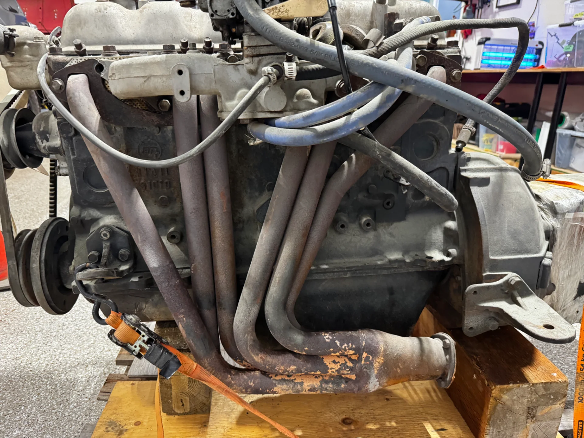

I just picked l up this 2F engine recently. It will be going into a future build. Weber carb.
Help me identify this header please! Is it worth keeping - I sure hope so, it's got me excited!

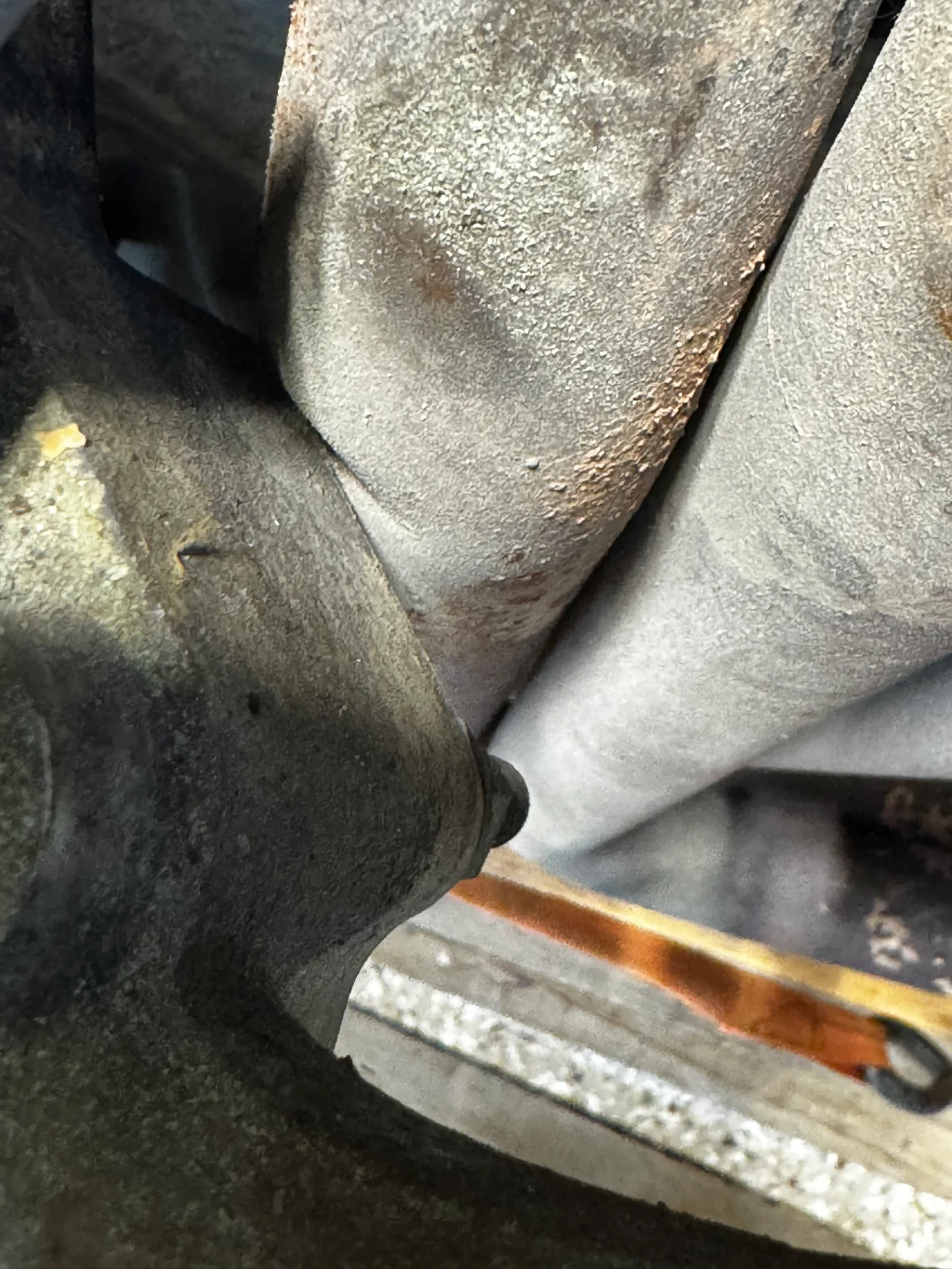

Thanks for the replies. I just noticed there is a spot on the intake that is lacking in clearance and the header is dented in. I assume that's not normal.
My plan is to remove them and restore as best as possible. I'll be searching threads for ways to do this.
