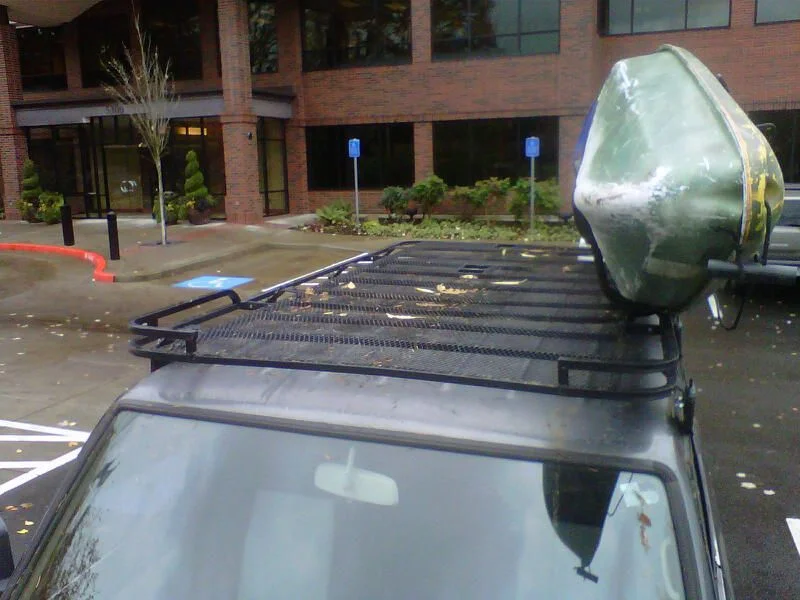

but at least it forced me to drive her and take pics the roof rack I fabbed up a few weeks ago, 3/4" tube can't remember the wall thickness, covered with expanded metal, boxed out a few mounting spots for the Yakima box and kayak mounts. Also did a shake down on the tranny cooler and EZ locker (which sucks).

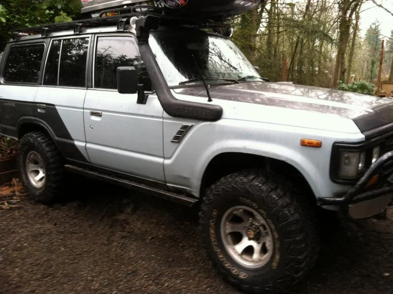

wound up with some alum 8 hole mags in a trade, 4" BS and they barely clear the TREs, they're coming off soon and the 33x10.5s (like the spare) are going back on.
Good call on the wheels. Look kinda weird haha.
Sorry to hear about the EZ locker.
Nice rack! ;)

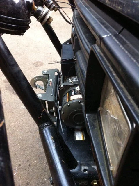

Pulled the trigger on a Harbor Freight Badlands 12k winch, $299 with coupon and $50 for the two year no questions asked warranty. For that kinda money I can afford to break it.
Recessed into the grill as deep as I could to retain approach angle and just because I enjoy cutting sheetmetal.
Not done yet, got 2 grade 8s in the mounting plate but will add 4 more and clean up the rough edges

Does that winch free spool? Can you mount synthetic on it?

Where did you get the feet for your 3/4" tube roof rack? Looks good.
Yes and yes, my goal is to put synthetic and a hawse at some point but we'll see.

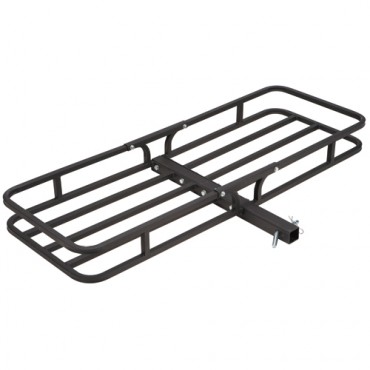

I built it, used some mounts from Mikes off-road I believe. Cut down a HF hitch rack for the corners.
Thanks! I have 8 extra mounts $160+shipping if anyone wants them.

Probably one of the best mods of a HF rack I have seen yet. I was wondering how you bent up the corners. Good job.

Thanks Mace, I wanted something low-pro and relatively light. 3/4 square tube dies are far and few between even with local fab shops so I improvised. The hitch rack was $50 from HF so it was relatively cheap to build as well, the mounts were the $pendy part.
