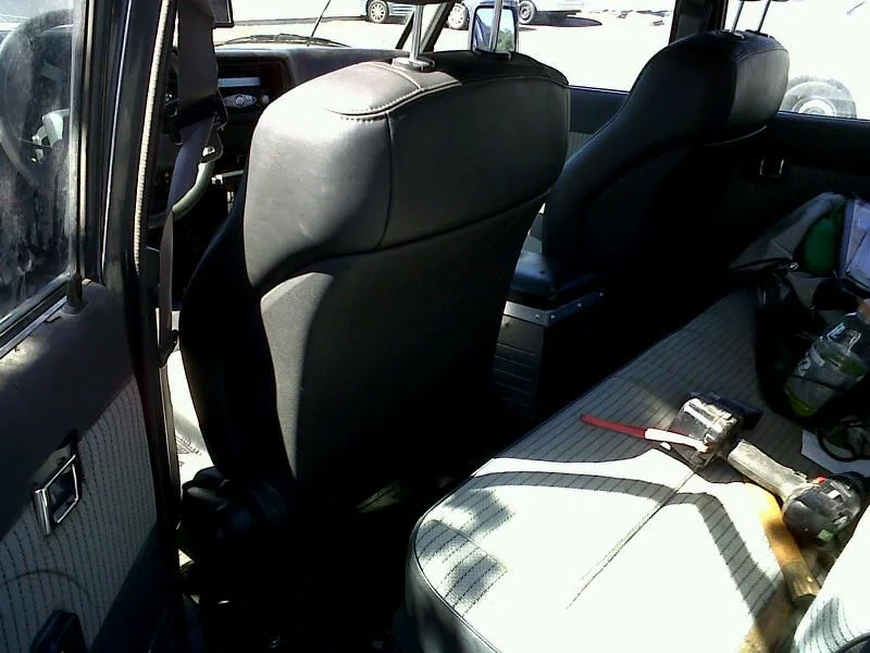

New seats! Grabbed a pair of leather seats from a 2007 J$$p Patriot for $200. Ground off the front brackets, welded front seat mounts from old seats and bolted to factory mounts. Retained rear mounts and drilled new holes in floorboards, bolted with grade 8's and 1.5" washers. Sits a little higher (better posture), I'm 6'4" and I still have some headroom. Next up is getting the rear re-upholstered to match guessing in the $200 range if I lug it into the shop for them. I know it's dirty, I need to hose it out.

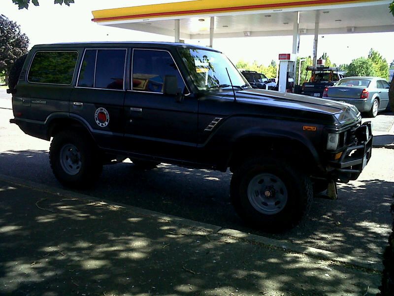

Ok, here are some shots of my rig with the copycat wheels and tint.
siiiick, welcome to the grey wheel club.
here's my tint job, limo in the back little lighter up front.
