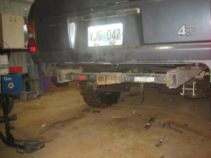

I cut frame back and welded in my hitch/crossmember, replaced the shocks all the way around, then re-did the lower bars on the front bumper. Pics sometime to follow.
Cool. Definitely post up pictures of cutting the frame back.

The pic posted above is pre-welding but you can get the picture. I cut it off behind the rear crossmember, then planted my hitch on top of the frame rails as the new crossmember. I figure I pushed it back about 8 inches and up about 6, should help my departure angle (funny thing to say when referring to a 60 but every inch helps) I'm gonna do a extreme 1/4 chop, integrate the rear sliders into the rear bumper along with the Pathfinder swingout. Pics will be posted.
attachment.php
Gotcha, I knew you removed the rear crossmember in that pic, but didn't realize how much you cut the frame back. Make sure to post pics of your "extreme" quarter chop. I might just copy what you do.
