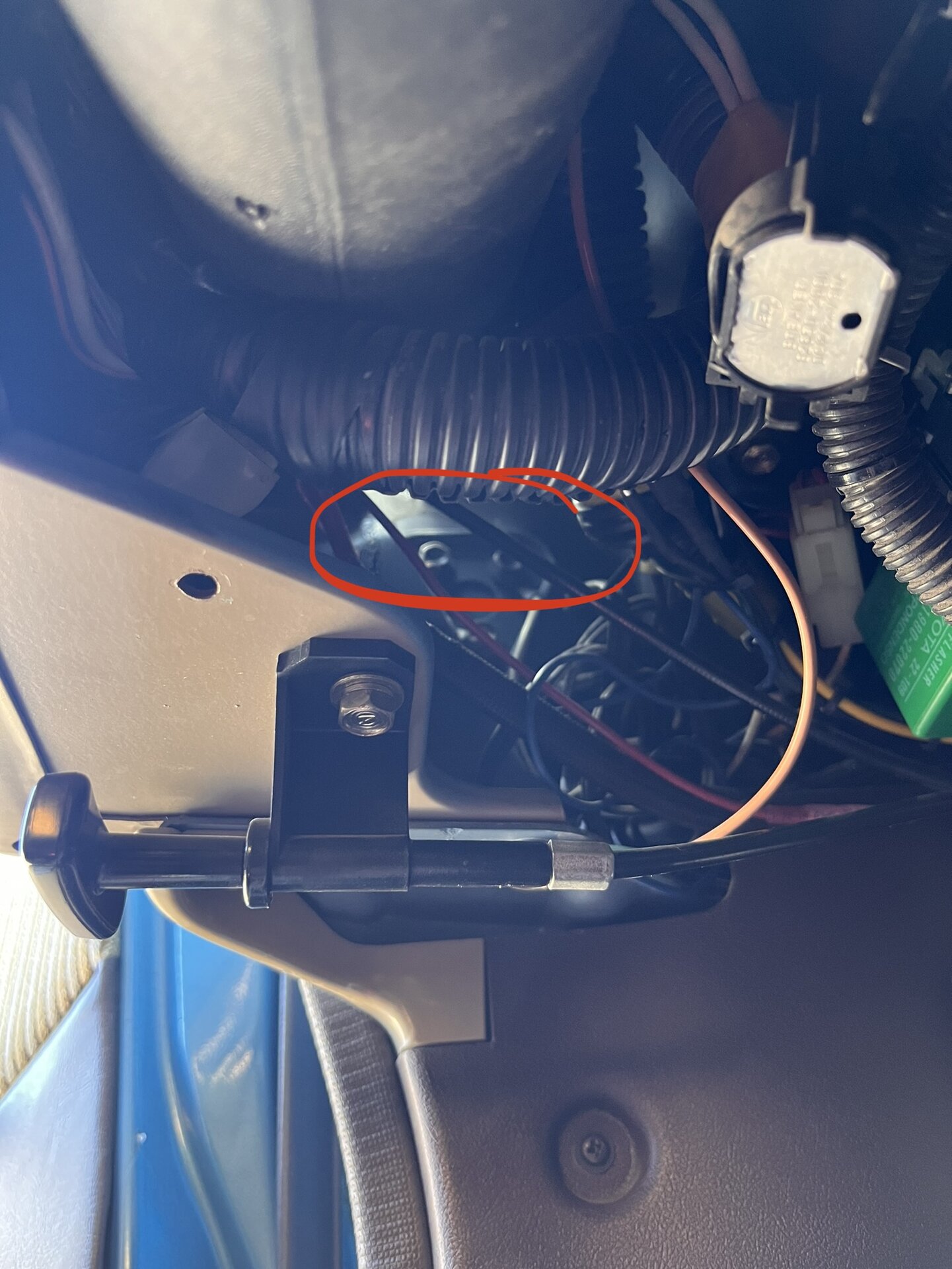

The way I took a picture of it was with a little pocket camera I pushed up next to it. That view is impossible with just the naked eye. You won’t see it like that — but you can see it and get a wrench up to the bolt if needed.
Start from the backside of the choke knob as a reference. No look towards the front of the truck a few inches. Now look as far as you can towards the outside skin of the sheet metal. That’s the backside of the upper door hinge - boom there’s your ground.
I got my bore scope out and found the passenger one, some how I missed that it was parellel to the skin of the vehicle. I now get why it's called an a pillar ground. 😁
I Was looking for it straight up, parellel to the ground. Thus my problem.
Pulled the glove box and put my hand on that one. With that for reference, I did pretty close to what cruiser trash said with my bore scope and (eventually) found it.

You can reach the ground from the point of view the photo was taken. It’s not too hard.
Feel free to share that too - just add that it’s a 1982 FJ60. There’s a surprising amount of variations on these trucks and I don’t know if that ground is present on all of them.
