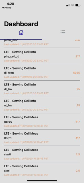

Specifically the “rsrp0" or "rsrp1” values
The cell signal started around -115 to -117. The booster increase the signal to -76 to -85.

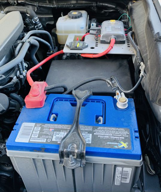

I "re-engineered" a Powetrays unit to fit my LC. They do not currently offer a solution for Land Cruisers. . .I did send Maverick (owner of Powertrays) info on my mod for reference. Below are some photos. I wired my WeBoost to my sPod, as like you, I didn't want a constant power draw. Here are some photos and a link to my booster installation:
If you already have one, it is easy to configure with a Switch-Pros, and it sounds like the same with a Spod. You could also wire it to a switched power source instead of a constant on. I suppose you could set it up with a relay (at the end of the day, Switch-Pros and Spod are essentially fancy relays), but that seems like overkill if you'd just switch on ignition - I don't imagine they draw much power.
