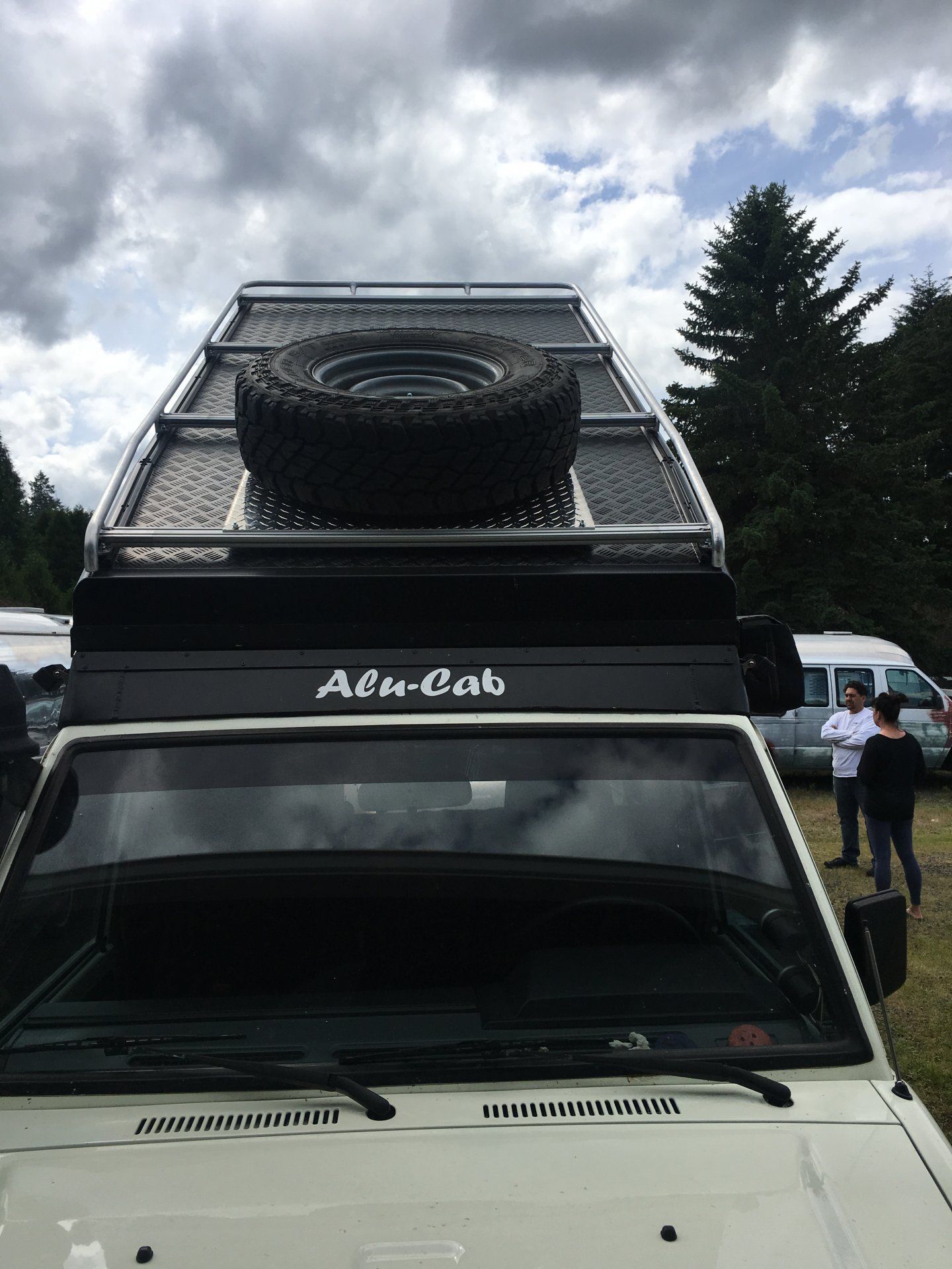

Ordered the 470154. Really appreciate you putting this together. Going on top of my Troopy. I does have rack. Thought I'd mount the antenna on the rear to elevate when the top is raised. Anyone have a suggestion on a mounting bracket? Ideally I'd like to be able to lower it easily when needed.
Ordered the 470154. Really appreciate you putting this together. Going on top of my Troopy. I does have rack. Thought I'd mount the antenna on the rear to elevate when the top is raised. Anyone have a suggestion on a mounting bracket? Ideally I'd like to be able to lower it easily when needed. View attachment 2452227
Here are some brackets made for round tubing. . .they're marketed as awning brackets but maybe you could re-purpose one.
GZilla:
Fourtreks Modular Awning Mounts:

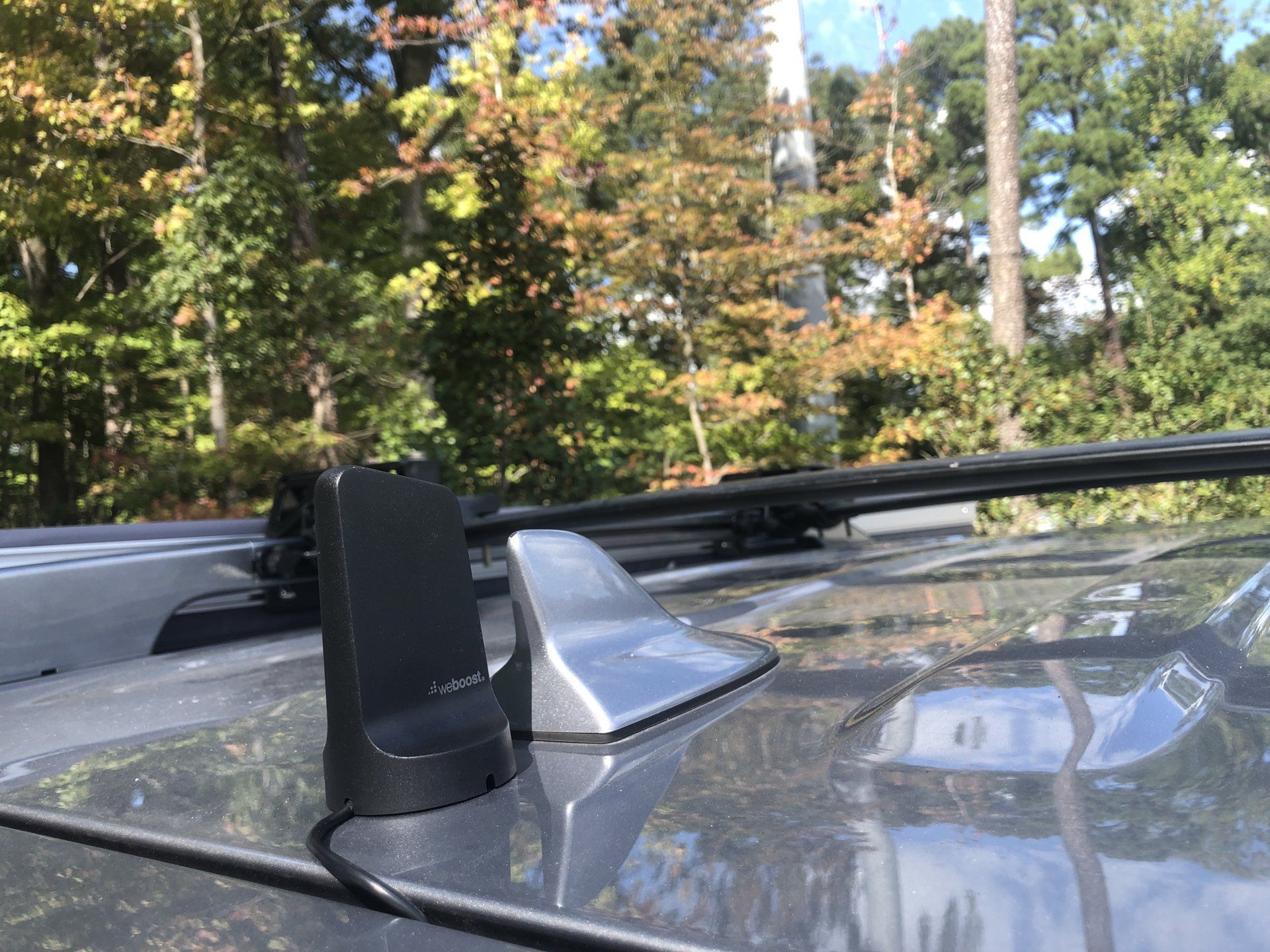

Just a heads up that the installation instructions say to not have the outside antenna within 12" of a window to minimize interference.
I do remember it saying that, and i forgot when i moved it to the back. Thanks for the reminder!

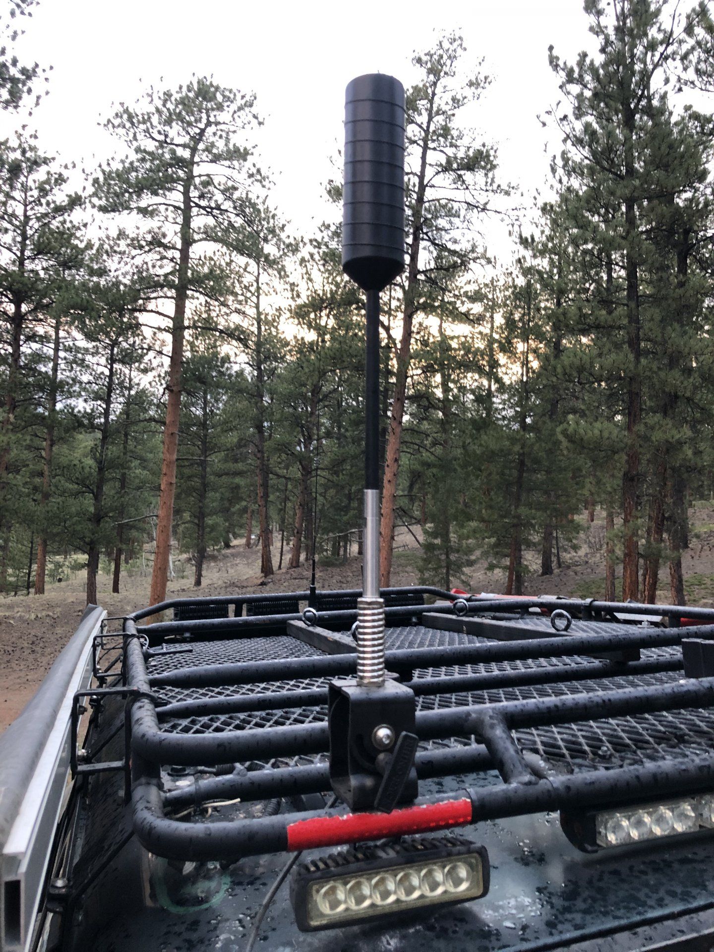

Rhino-Rack Folding Aerial Bracket (part number 43196) is great.

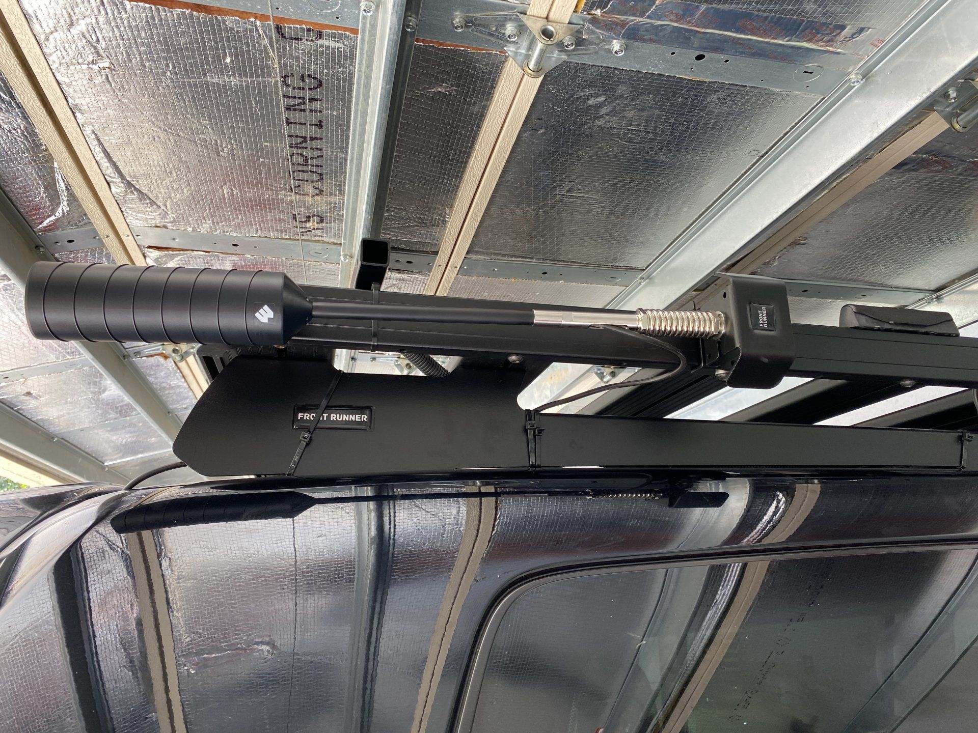

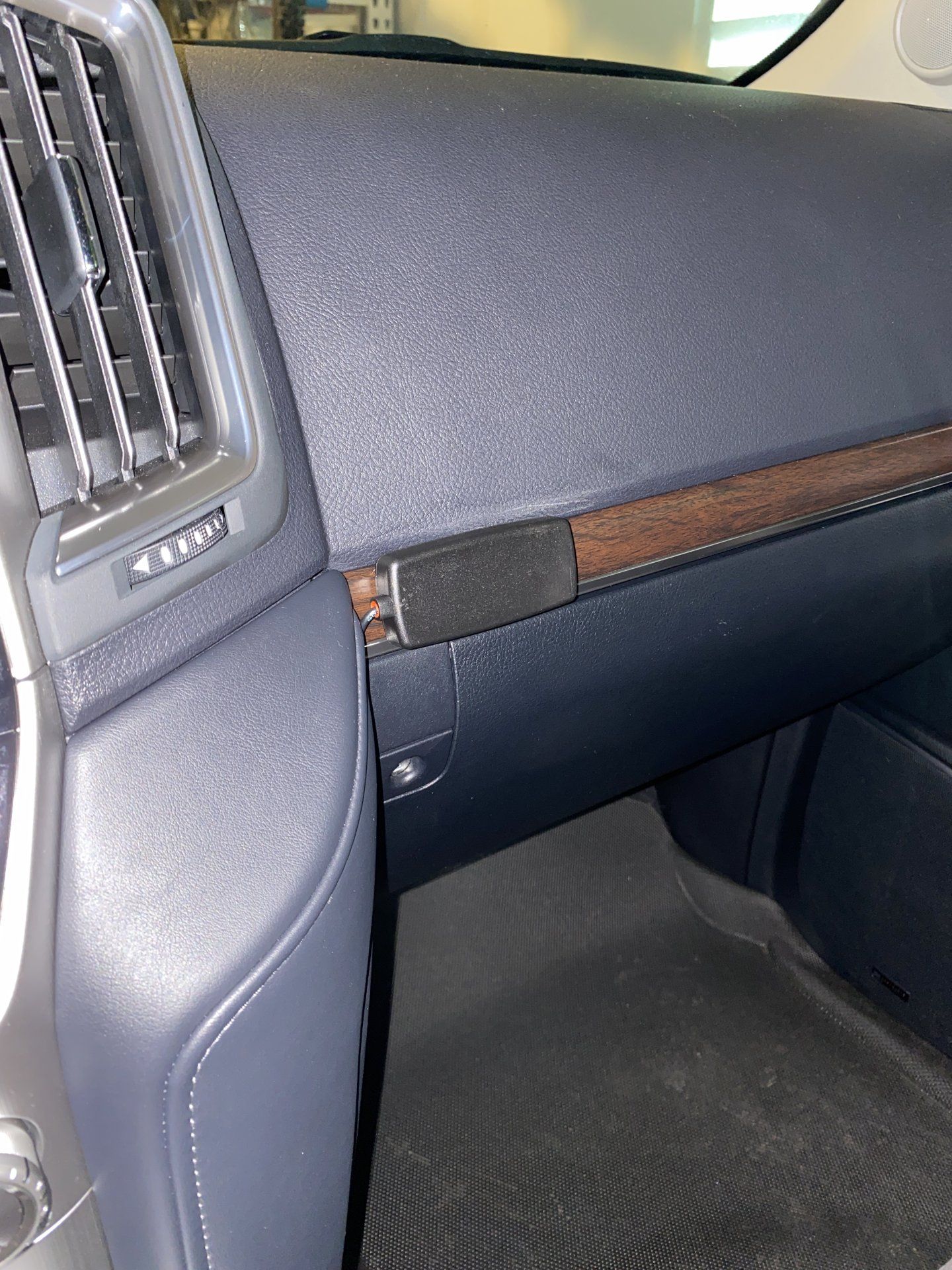

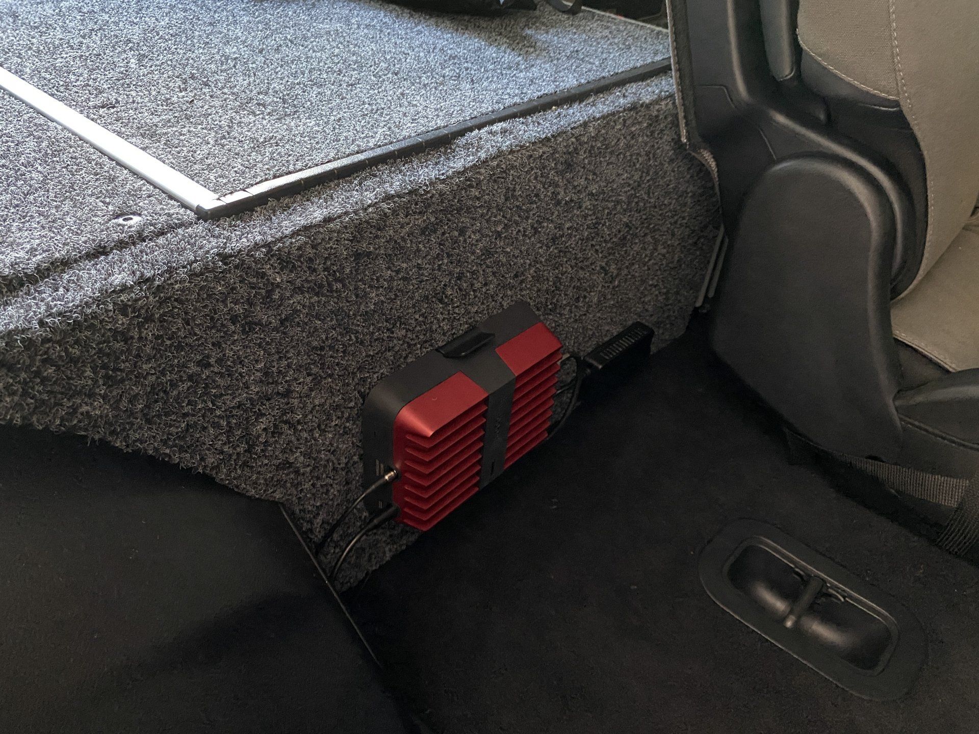

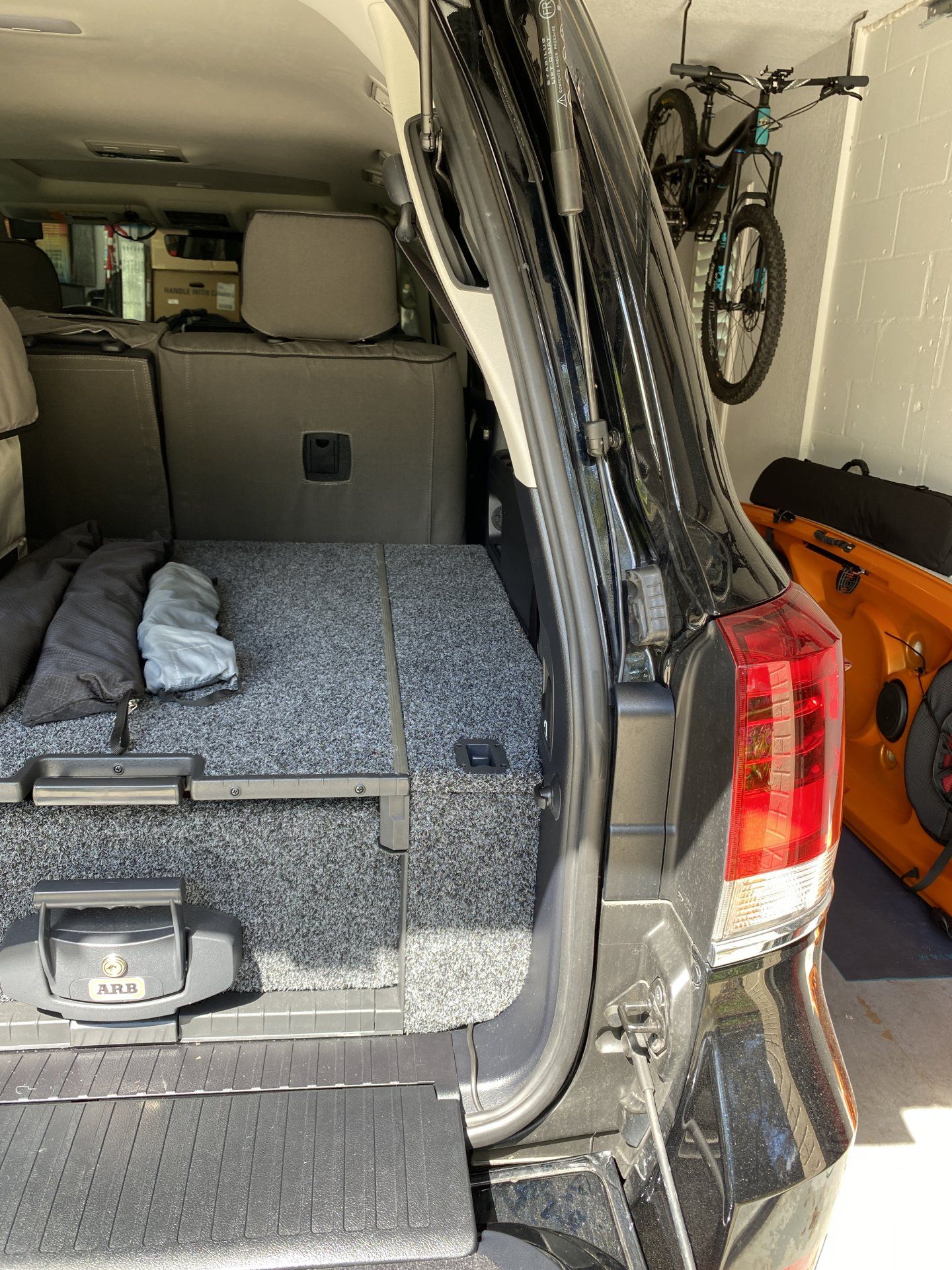

Installed my booster today (Drive Reach Fleet OTR). Ran a hot from my sPod through the firewall to the passenger rear. Mounted the Reach unit and power supply on the face of my ARB drawers using Velcro. Mounted the antenna to my Frontrunner rack using the FR tilting antenna mount, and routed the cable down the side of the rear hatch, then up under the weather stripping and under the drawers. Interior antenna is mounted on the dash just above the glovebox. All wiring is hidden under interior trim panels except for the exterior antenna cable where it enters the rear compartment.
Very clean, thanks for sharing! I’m embarrassed to share mine now xD.
