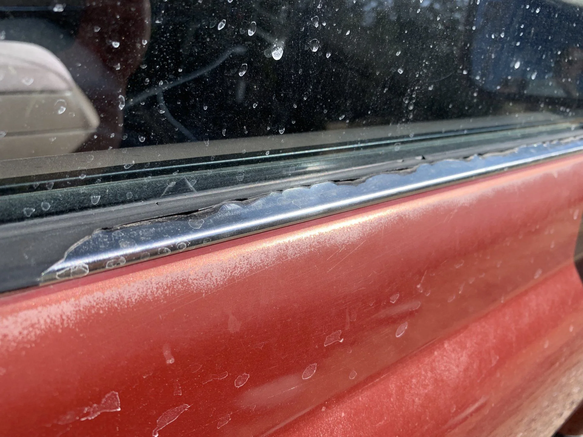

Hi all, been looking on the forum / web and haven’t found a source for weatherstripping for doors and sunroof and this black chrome cover thingamajig for my 1995 LC. Sorry if Im missing it here. Any help would be appreciated. Getting tired of the whistling at HW speeds.

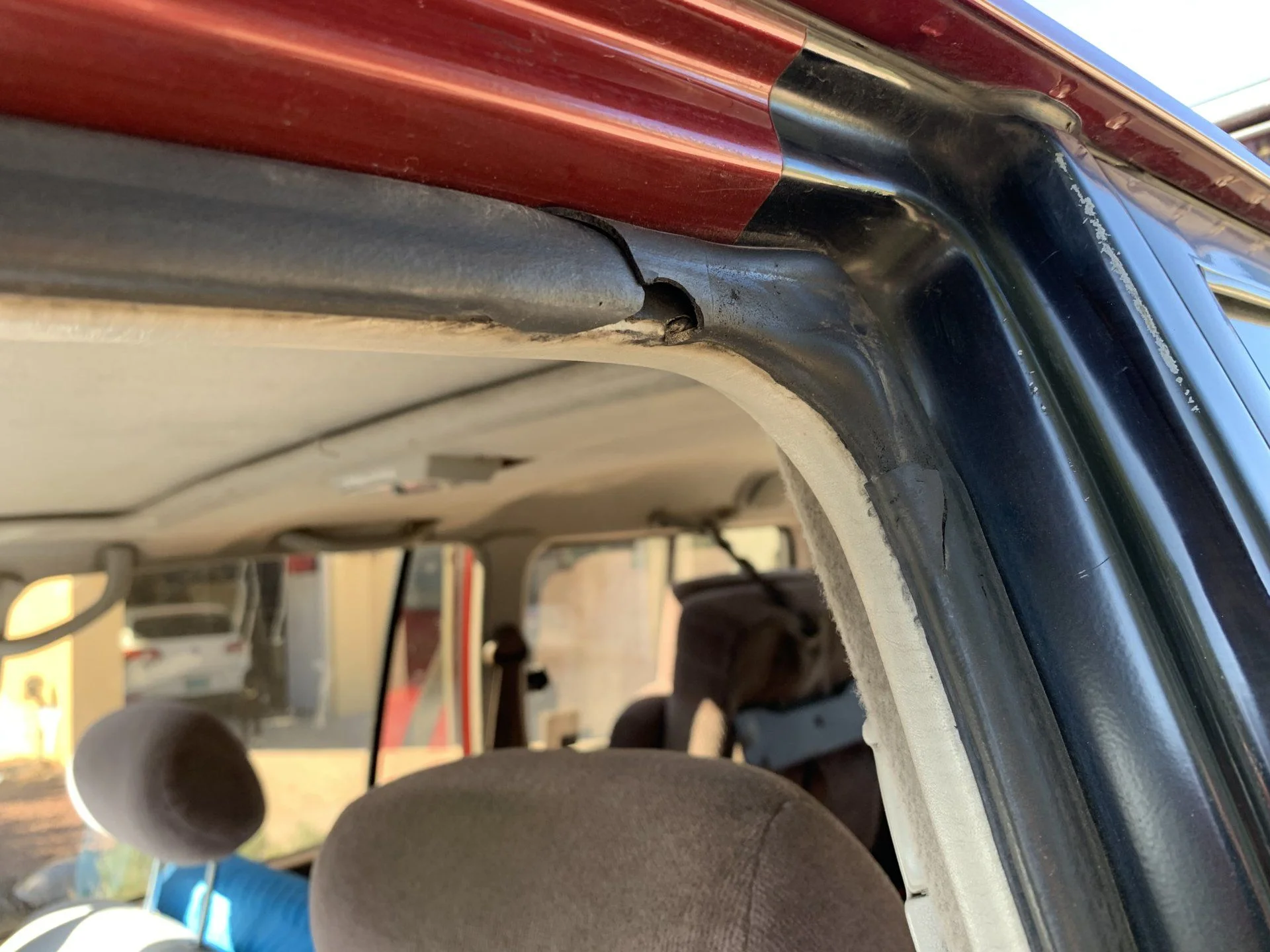

The top picture is Molding Assembly, Front Door Belt Part #75710 (right side) or 75720 (left side). If you are going to replace this you may as well do the inside one too since you have to remove the glass to get them out. May consider the window runs too if budget allows.
The bottom picture is Front Door Opening Trim Part #62311 (right side) or 62312 (left Side). It should be a black weather strip integrated with a colored PVC molding on the inside. So far as I can tell those are only available in the light grey color. If anyone knows where I could find a Tan/Oak interior one I would love to have both sides. I have debated getting the grey ones and seeing how they look or maybe trying to separate the colored PVC part and swap them but mine don't leak bad enough to go that far just yet.
Dealer or any of the kind parts vendors on this forum will be able to get them except as I noted.

Window glass does not have to be removed to replace the outer belt molding. I recently did all 4 of mine.
Those are incomplete Toyota part numbers.
The outer door molding is called "Belt Weather-Strip". OEM part#s are as follows:
75710-60021 for the right front
75720-60021 for the left front
75740-60020 for the left rear
75730-60020 for the right rear
Door opening trim part#s:
62312-60070-B0 left front
62334-60010-B0 left rear
62311-60070-B0 right front
62333-60040-B0 right rear
68151-60010 window run channel front left
68141-60010 window run channel front right
68152-60011 window run channel rear left
68142-60011 window run channel rear right

Replace the window run channels while you are at it. They add to a lot of the noise if cracked and are the primary reason if your windows are slow to open/close. Makes a world of difference and comfort. Make sure to get those new OEM. Really easy install even without removing the door panel, but proper installation requires panel removal. Still easy though. Unfortunately I have found them to be about $90 each so I am doing them one at a time here and there. But the drivers side was definitely worth it.
