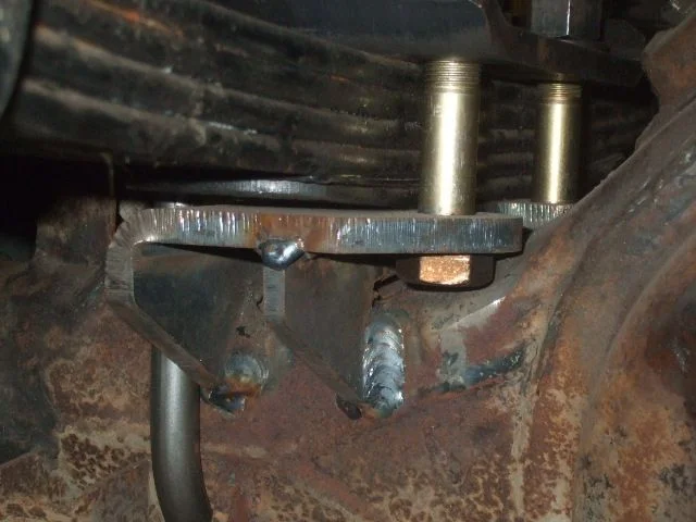

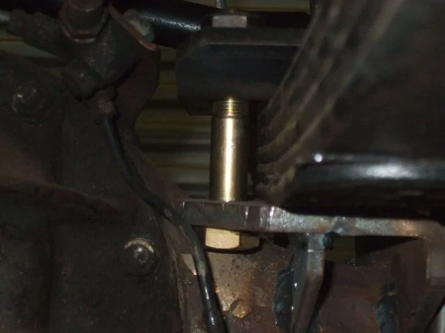

Looks like we have the same problem as Tim. The front hole on the Ruff Stuff passenger side spring perch is too close to the housing. Can't get a bolt through, a nut tight to the bottom, or even a socket head cap screw to fit in.
My first thought is to use the plas to elongate the hole to where a bolt can come down from the top and then weld a tall nut on the bottom side. Should work.

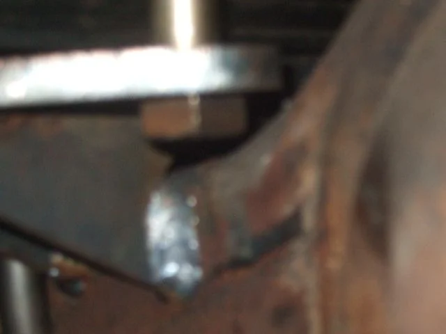

I ended up just burning it in, didn't want to wait. ended up fine. no problem using a large 5/8" u-bolt nut(tall nut). I did end up having to cut a lot out of the little plate to get the angle.

So you only got on U bolt right. not thats its a big deal because of the design, i never saw it done this way, or should i say i have now saw that clear of a pic before. looks cool

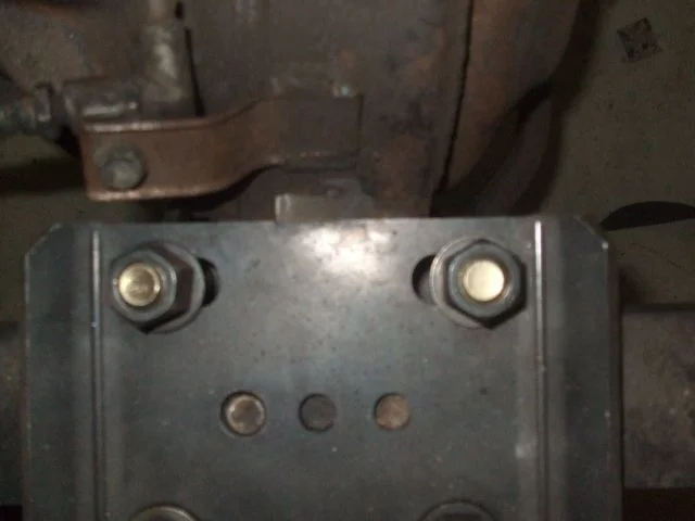

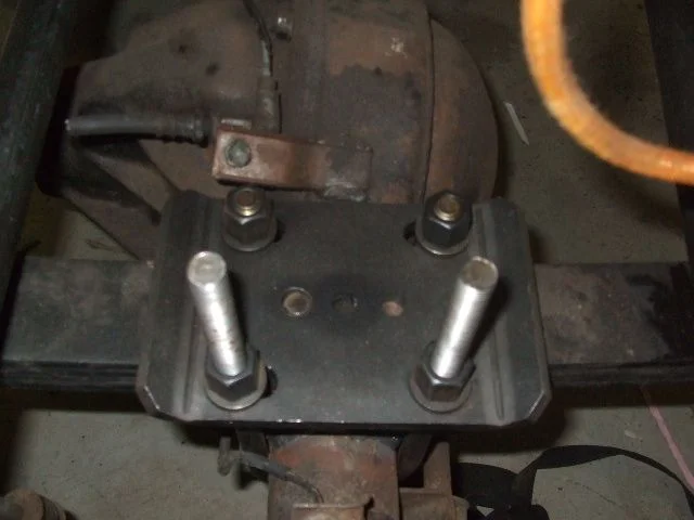

My Ruff Stuff perches look a little different than yours. I was able to use the bolts that came with it and have room to install them.
