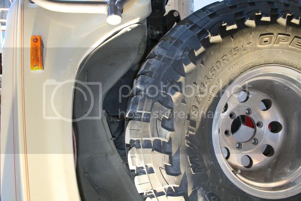

As it sits, the rig will drop about 1 1/2"-2" more.
We're happy with the ride height especially since it will come down a bit more.
Axle got pushed forward an inch or 2. Still have 1" forward or back to play with on the spring pads.
Those 37's are going to rub like a chubby girl's thighs.
when all said and done I'll probably have 3"s off up travel. It's all about bumpstops. when it's compressing the tire will go back, dropping will go forward.
If it doe's rub a little, I don't really care.

Those springs look a bit flat....you planning on hauling a ton of stuff? My SOA springs sagged after a month and they had looked like that in the beginning. You may want to add a leaf to stiffen them up.
I gonna wait and see how it is first, with the bumstops I will set them up so there is just an inch of uptravel before they contact. those bumpstops are supost to be the poor man's air bumps.
