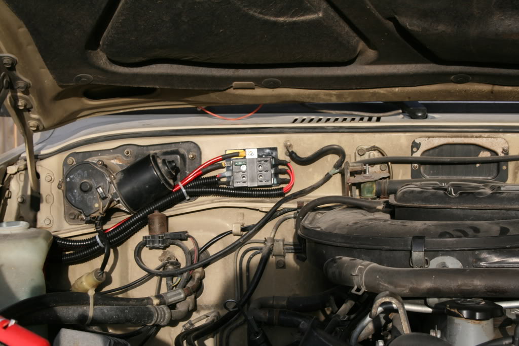

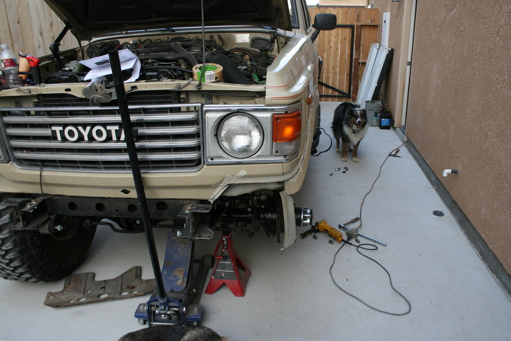

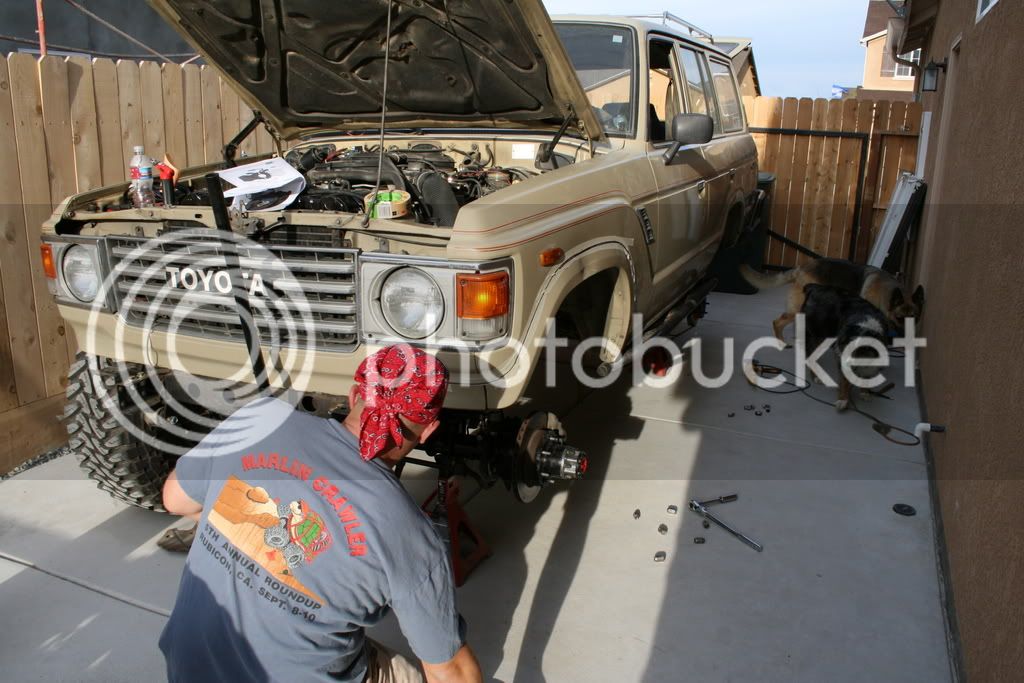

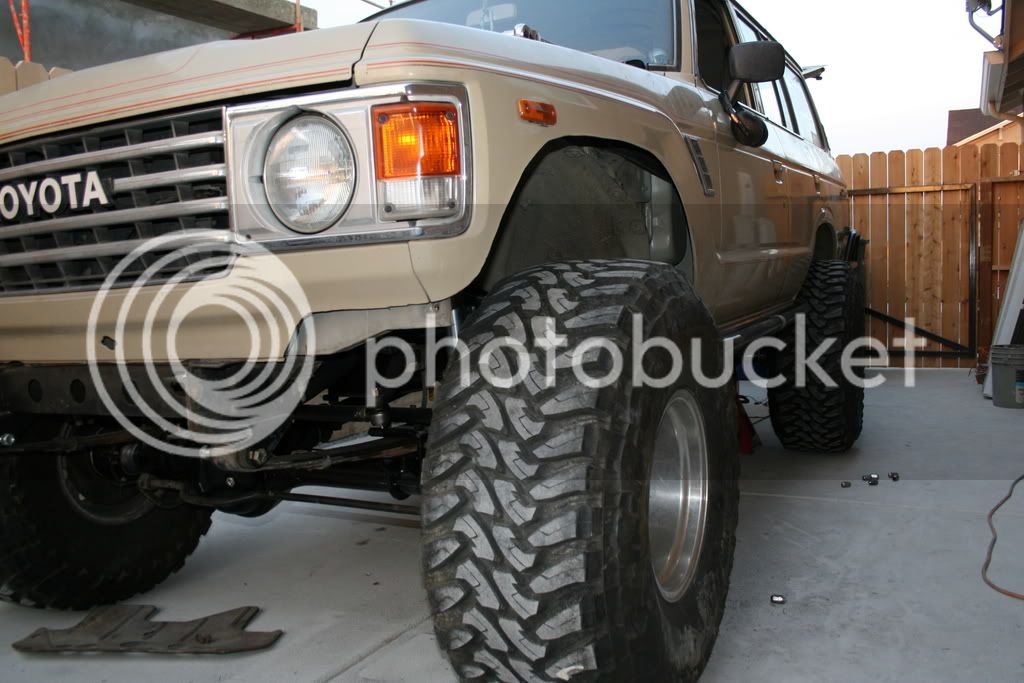

Alright, a few updates.

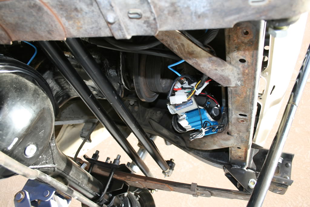

Jason has been working on getting some of the auxillary wiring taken care of. He picked up a 6 pin fuse block from Napa.
Got the ARB pump mounted on the frame just in front of the motor.
I'm starting to like this thing :grinpimp:

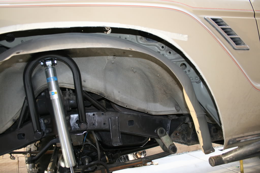

my rear springs have seen beter days. I think I'll re-arch them an inch or two and bag the rear.

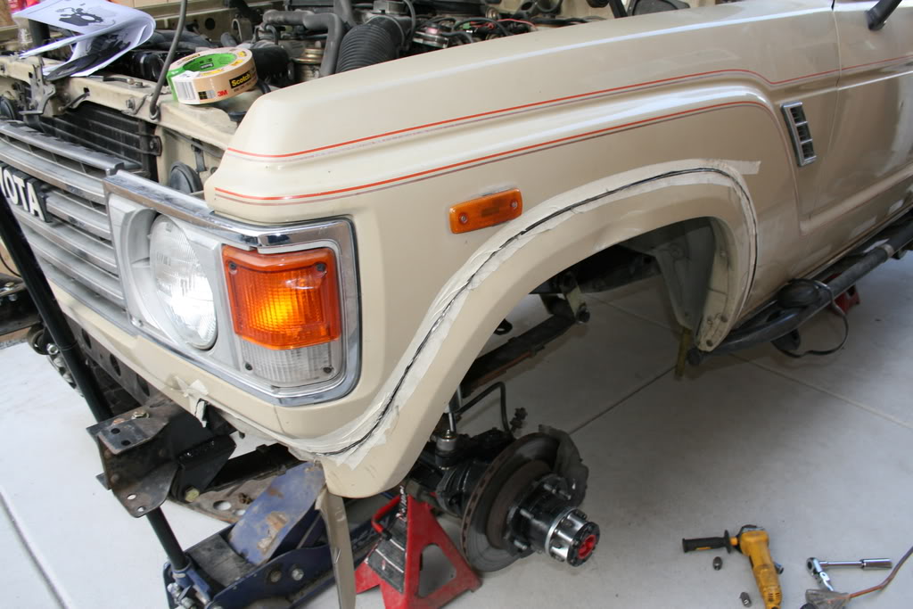

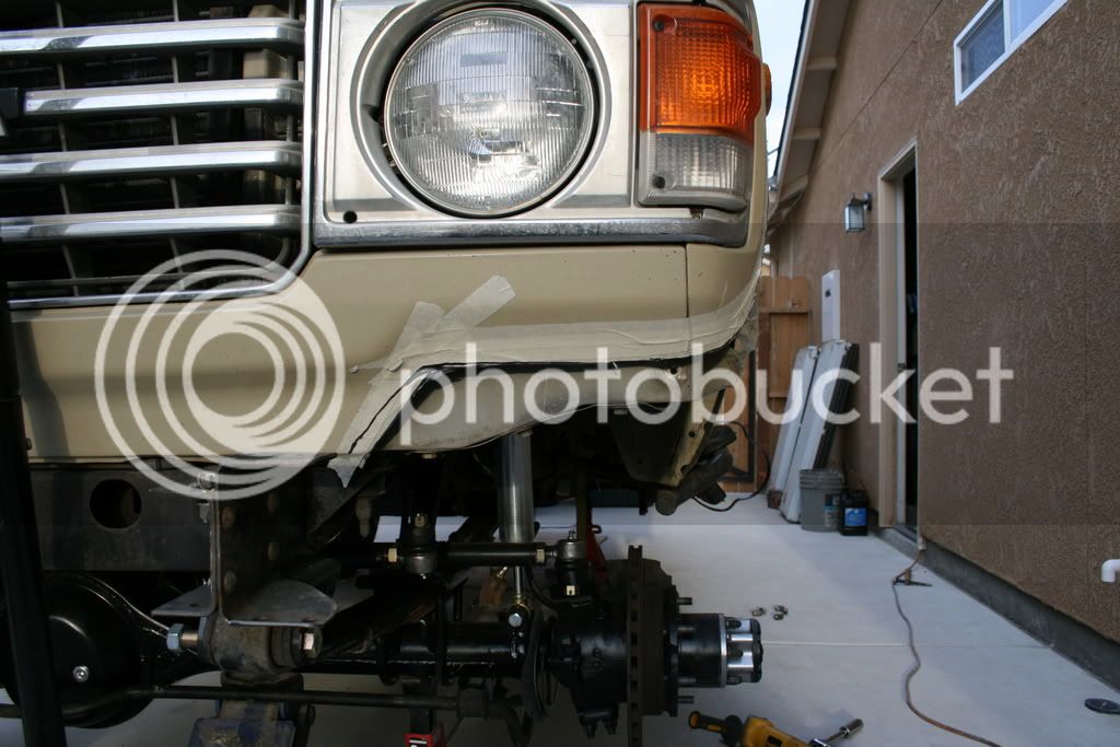

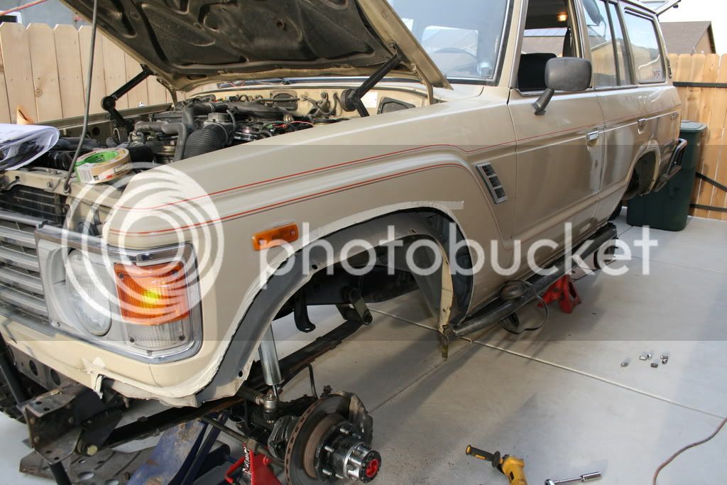

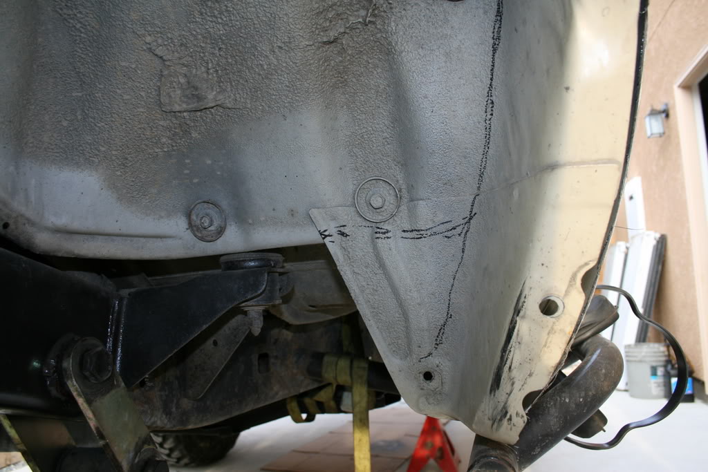

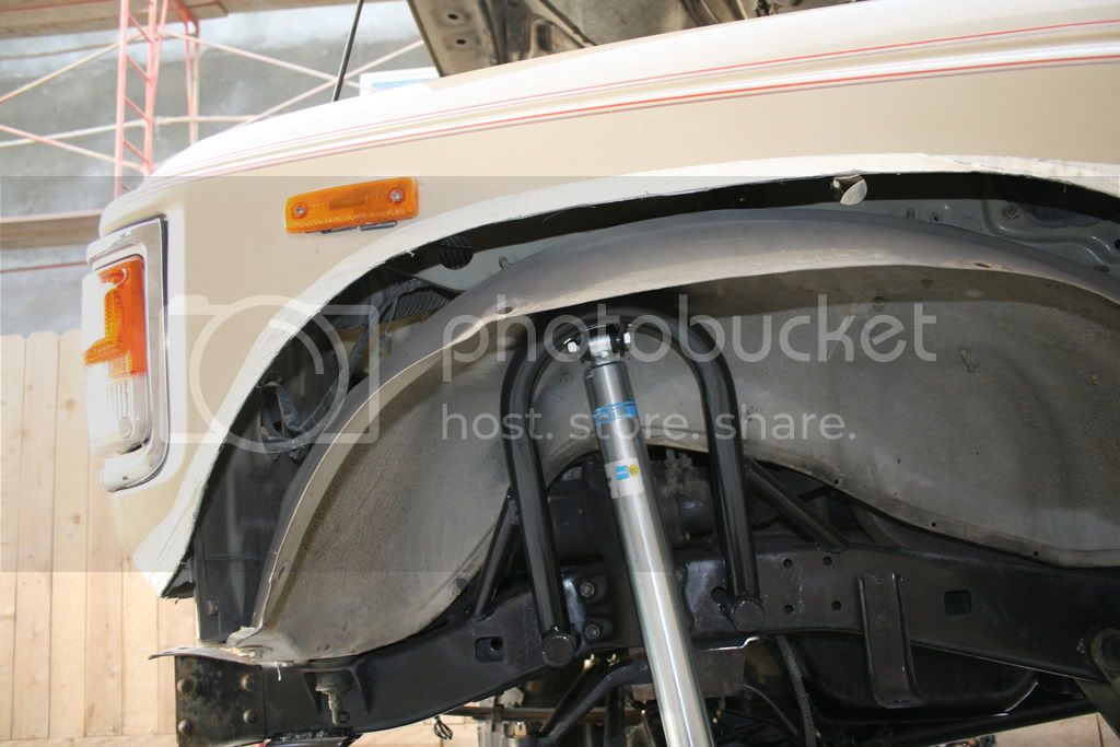

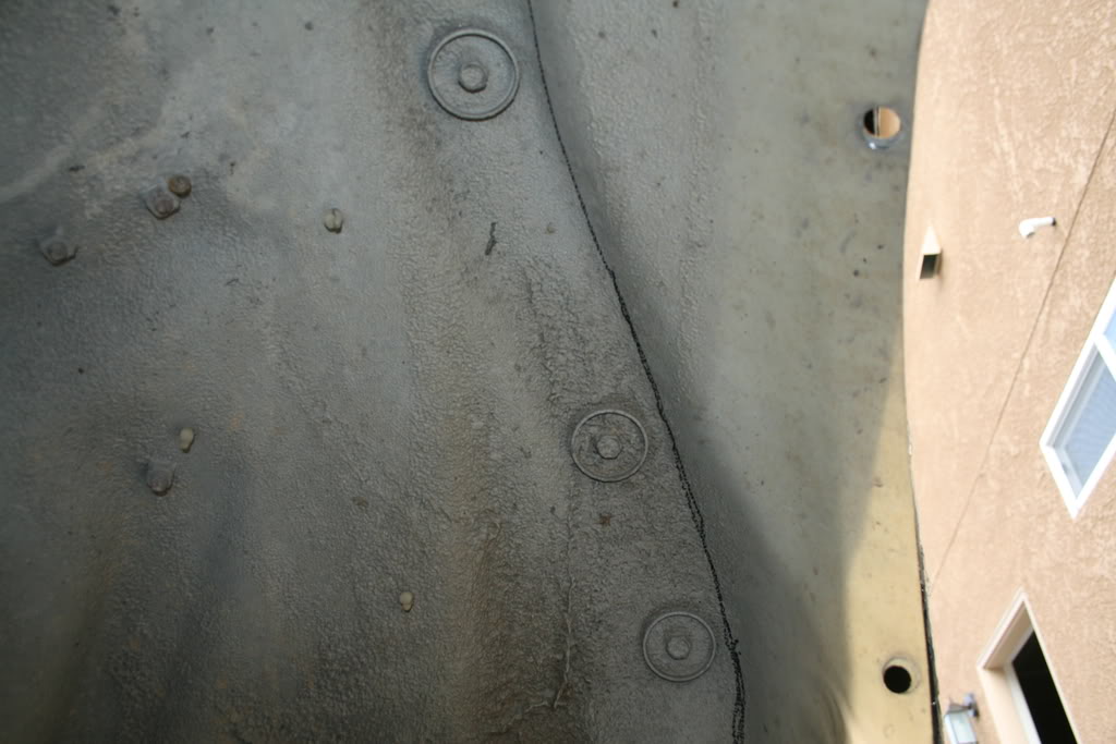

I love the cut!! I think I'm going to do the exact same thing to my 60.
But yours is more like an FJ30....... or 35......... Or something like that... You havent cut anymore off lately have you? :D
(nice avitar)
Chris:cool:
nope not since the windshield went away ...its a FJ60 - 1/3
for now they won't.
if I get a bug up my butt, then I would plate the gap and put in some 1/4 bar
your cut looks great.... add the bar stock before you hitem it adds ALOT of strenth to the fenders keep the pics comin man I wish mine still looked that nice:meh:
