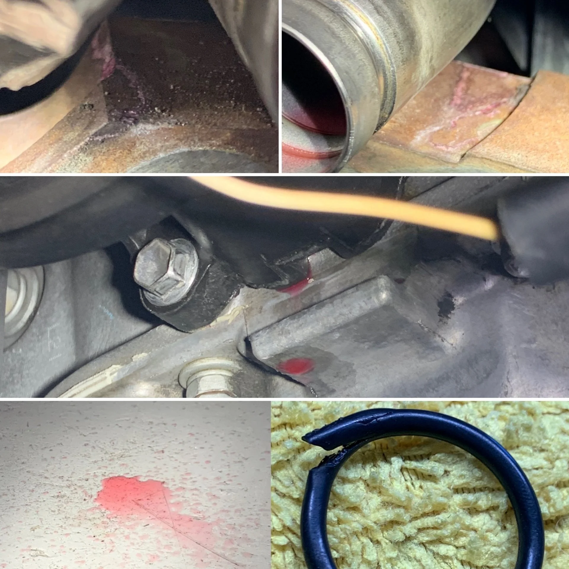

Now, I'm on to my next issue which is a coolant leak. He said the timing belt was done twice but as far as the water pump, etc he wasn't sure. I've been driving for about a month now and initially there were no leaks, but the last week or so I started noticing some red fluid coming from what appears to be a weep hole near the crankshaft pulley. Initially it was just a few drops but today, I drove about 10 miles and when I parked there was a steady drip and about a cup of coolant on the ground. I've already replaced the heater tees and there isn't anything coming from the radiator hoses. I really can't see any fluid above that area besides maybe some around the sensor in the last photo (not sure what it is) Can anyone confirm that this is the weep hole for the water pump? Or could it possibly be something else? I know there are tons of threads but I haven't been able to find a photo of the water pump weep hole anywhere...
