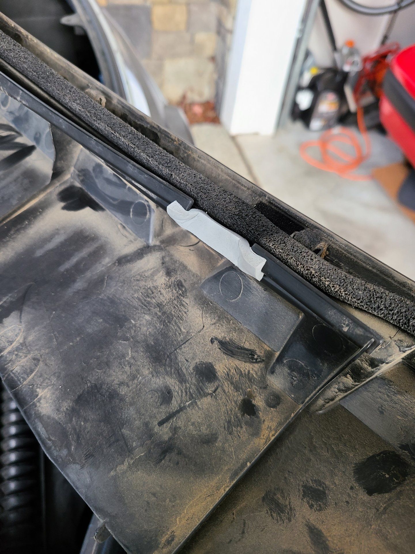

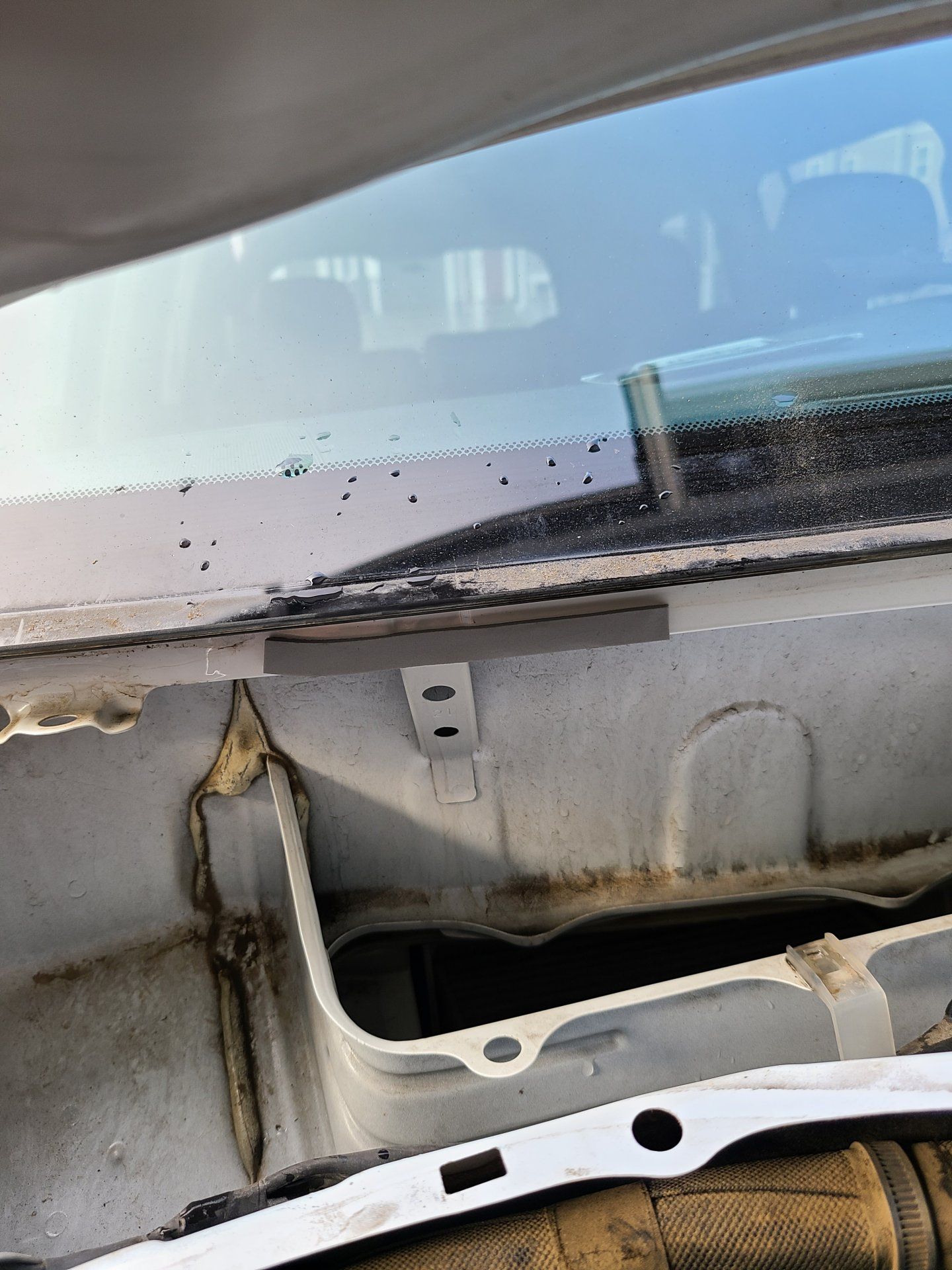

So I removed my cowl earlier today. Water is definitely coming through the cabin filter vent because there is really no where else water can be coming from. I used a squirt bottle and poured a little water into that area and sure enough it drips through to the floor like what I experience in a downpour. Everything really seems to be in decent shape but I did notice a notch in the weather stripping and it exists right above the cabin filter vent which I assume is where water has been slowly seeping in from. That notch area seems to align up with an angle piece along the firewall (you can see it in the first pic with the two holes).
In the 2nd pic you can see where that notch is on the cowl. My guess is water runs along those channels either left/right and they dump outside of the vent area but perhaps it was coming directly down from there into the cabin filter area? You can see in the pic that it was still damp in that area which is directly above it. I've wondered if my cabin filter would be soaking wet if my car is not on recirculate while I'm parked.
Anyhow, I went ahead and added some extra weather stripping along that area along with the area where it connects.
Ran a hose on it pretty good for a few minutes and I didn't see any drips make its way down so I'm hoping it's resolved but we'll see next time it dumps in the PNW which will be pretty soon.

Does all of this attach to the base of the windshield by clipping into a slot? It seems that attachment method would prevent most of the water passing through and down.. though you tracking this down ire makes it look inadequate.
Also next to the notch seems to be another strip of something, but it seemed misaligned. Is that piece loose and sliding around, or integral to the cowl cover and maybe bent?
The base of the windshield already has some sort of weather stripping and there is a decent ridge where the cowl sits under it. From what I can tell the clips along the underside of the cowl fasten it nicely and its a nice tight fit. Honestly I'm stumped as to where water is getting in. I've put the extra weather stripping only because it felt damp and I think its where water may be slowly seeping it but the existing stripping should be adequate from what I can tell. That piece in the right corner that looks mis-aligned seems to line up with the curve of that area and its outside of the intake area as well. I noticed it was also damp but I figure it if leaks there It would run along the corners into where it drains anyways.
If I still notice leaks, I may pull it again and just line that area with some shop towels or something and then pull it again after a few hours to see where water collects.

Just wanted to give an update. It's been raining for almost 24 hours straight and that added weather strip seems to be working nicely. Laid out some shop towels along the floor and its still dry.

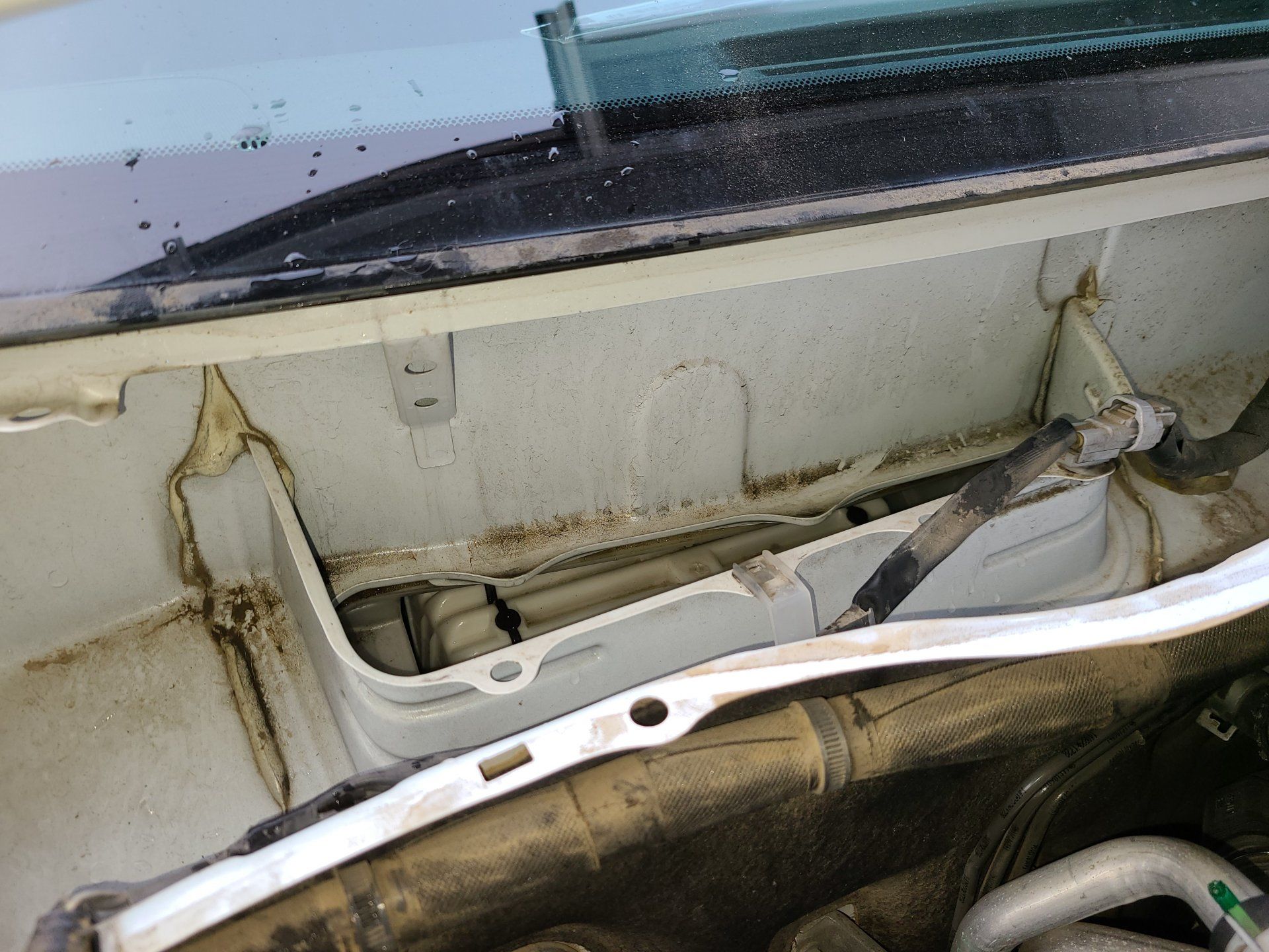

I got out and checked under my cowl today. I agree that any water that gets into the rim of the air intake is going to end up in the floor board. I dumped a lot of water in the channels around that and it all drained properly with no water in my floorboard, so I don’t think I have any leaks in seals in the firewall. Definitely has to be with something around the areas @peez206 addressed. For now I just cleaned the cowl and the windshield real well. I’m hoping that dirt and grime was maybe fouling the seal between the cowl and the firewall/windshield. I’m not super optimistic, but I had to get it back together to watch football. I don’t think it matters whether the recirculate cover is open or closed, as I think once water is inside that rim, there is only one place for it to go.
Also of note, if the cowl wasn’t there, water pouring off the windshield definitely would just dump into that entire left side of the HVAC intake. So ithe plastic cowl must be designed to steer water away from it

The OEM weather stripping on the cowl seems to sit pretty tight pressed against the firewall along the back. This should do a good job at sealing that area and letting water drain into the mesh which would direct any water away from the cabin filter intake.
The only vulnerable area that I saw was that one indentation which could have gotten less compressed over time?
It was also the only part that had a notch where water can come directly down instead of a channel that would drain water away.
Anyhow it has rained several times since I added that additional weather stripping in that spot and so far so good. Hopefully its the same culprit for you guys.

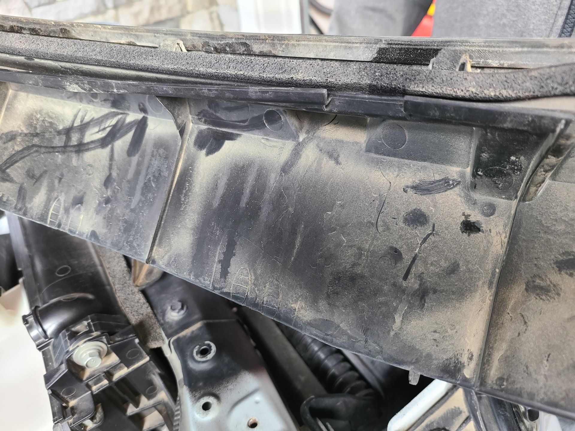

Curious to see if there were any differences in a new cowl, I ordered one and picked it up earlier this week. It's the same part number from the 2013 to current model year 55708-60101, the cold weather version as there two. On the cowl itself, the Aisin note in Japanese says that it is made for trucks with a bracket but the part appears to be the exact same part as both are listed on the cowl 60101 vs 60091. My guess is that there is extra foam weatherstripping for the bracket that sticks up right above the AC inlet?
The new cowl fits much tighter than the old cowl and the insulation is much thicker as it has not packed down. I think peez206 has the right fix, looking at the old cowl I would add foam weather seal tape in the same area below the windshield from the passenger fender side to the passenger wiper arm mount. This would coincide with the channel built into the cowl that collects the water and redirects it into the gutter. My cowl was a bit weathered so I decided to replace the cowl but I hope this helps others who may have the same issue.
