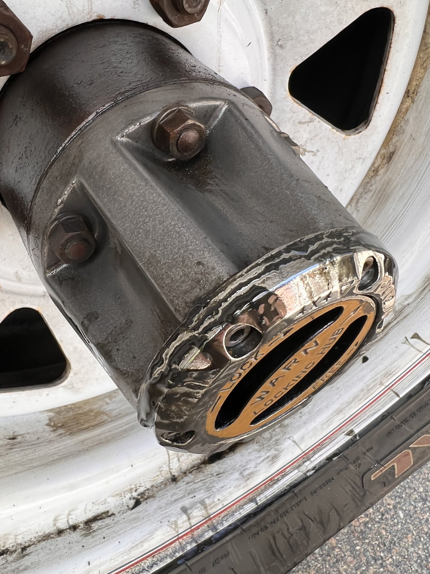

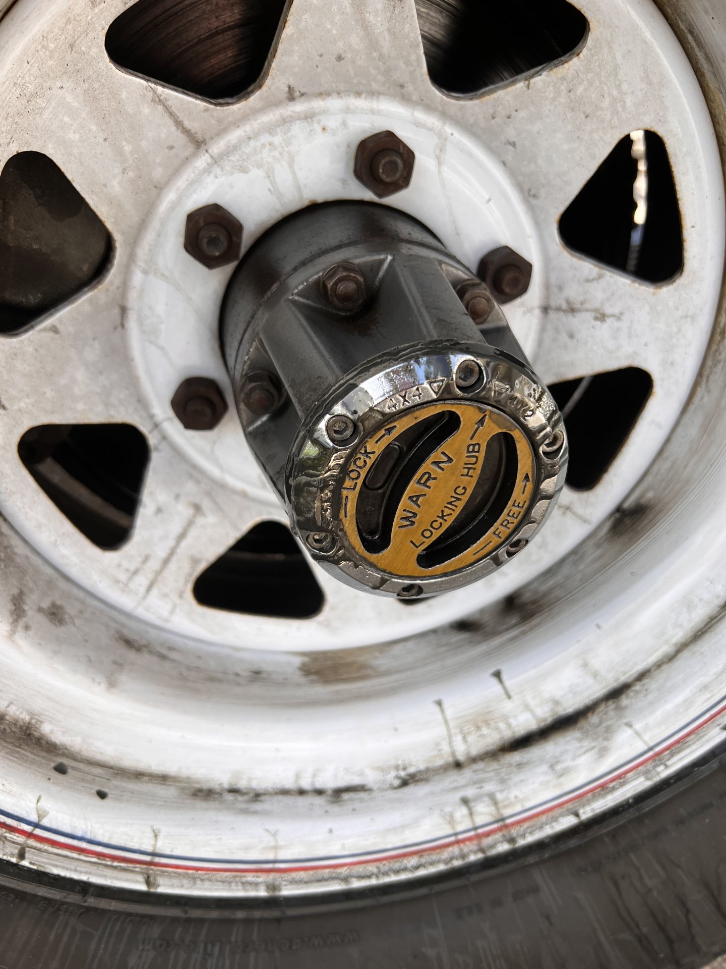

Thanks for the responses. Here are a few pictures of what I am seeing…
Is the cap loose?
Doesn’t seem to be. I haven’t dealt with locking hubs much in the past so pardon my ignorance. Would pulling the cap off mean I have to get a rebuild kit or could I clean and close it and see if anything changes? Will also take a look at knuckle when I have some time.
Just pulling the hub off and checking it out real good will be a decent place to start, looking at the back of the knuckle will tell you more. Grease shouldn't just flow out of that cap, it appears that you may have gear oil in your knuckle housing.
Nothing major, just a knuckle rebuild.
