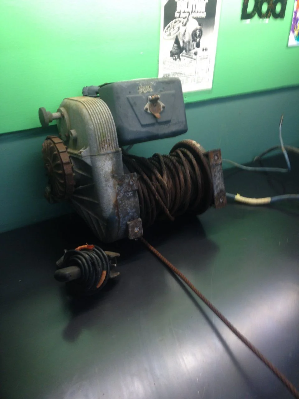

Hi Guys, I have just completed the second in a series of 5 or six warn 8274 winch videos. So far I have the complete tear down and reassembly of the 8274 done, the others will include installation, rope installation, my modifications, and albright solenoid install. Have a look if you like:
Video #1 Complete tear down
[YOUTUBE]WXLnAqgRpFE[/YOUTUBE]
Video #2 re-assembly
[YOUTUBE]AetCZJxvNdU[/YOUTUBE]
Thanks for watching and don' forget to subscribe!
