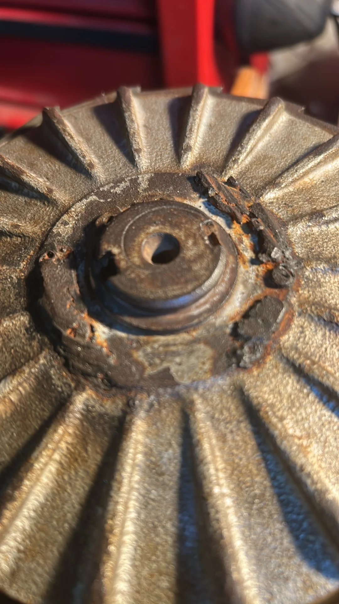

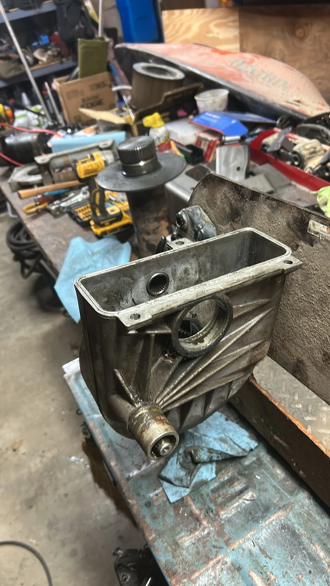

Finally picked one up for my 40. $400 seems outrageous but its a lot less than a new one. Its going to need a bit of work.
Gears and case and motor are in good shape, solenoids and cover and wiring are toast. Splurging on the fancy warn Albright/box/wiring kit. Cable was spooled feeding off the top. I can’t figure out what was welded to the brake. Maybe a contraption to engage it since it was running in reverse?
