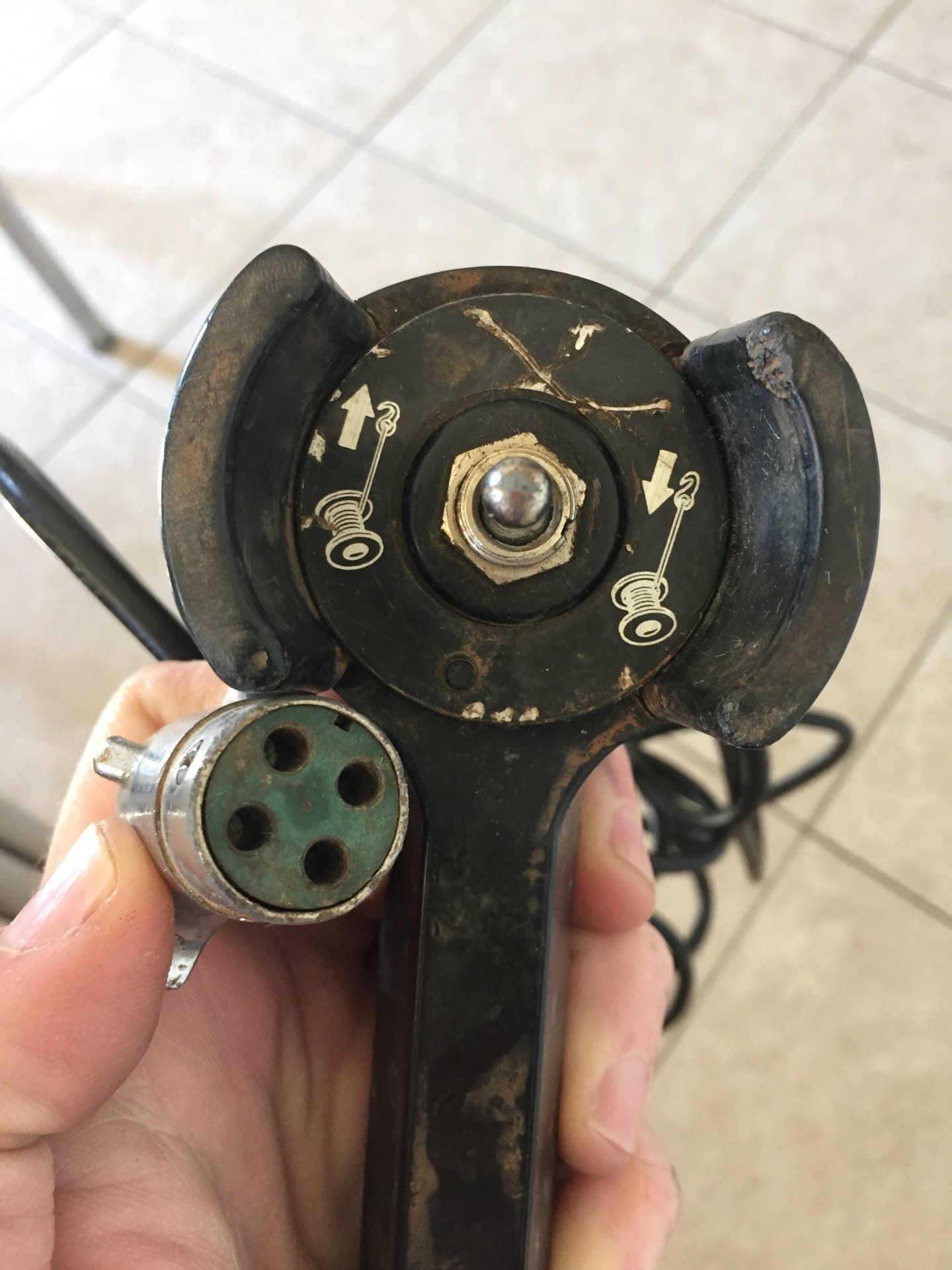

Is this what you’re after? This belonged to my 8274 circa 1975
I don’t know to be honest. 38626 is the Warn part number for the older 8274 winches. I just searched Warn 38626 on eBay. Apologies if it isn’t the right remote.
No apology needed! It all helps, at the least we narrow down what may not work.

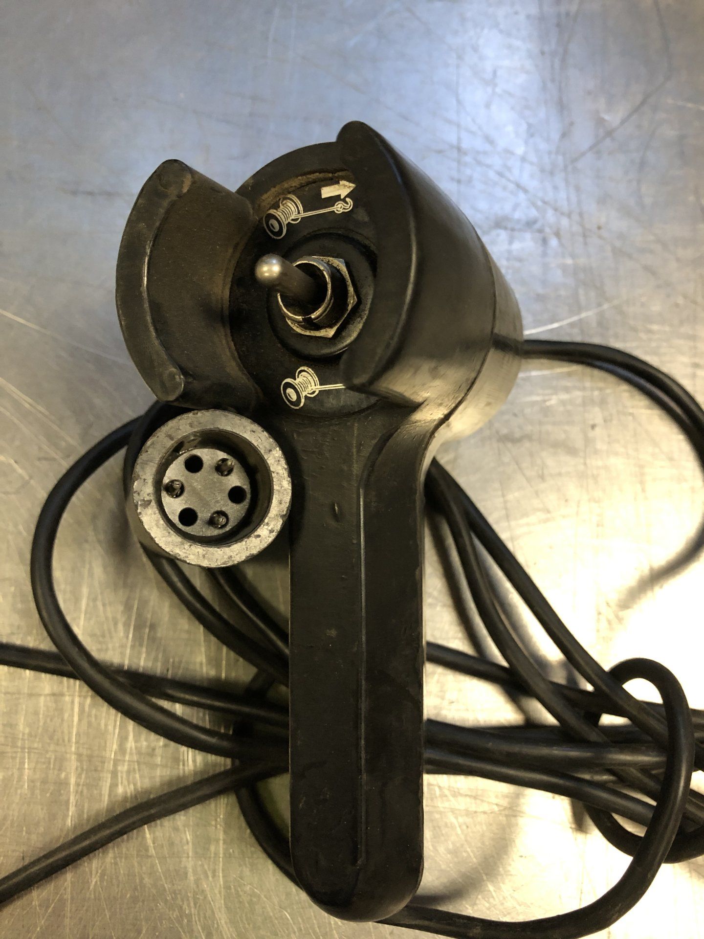

ALL OF THE Warn controllers, 4 or 6 pin plug, ONLY use 3 wires to control.
For the old 4 pin plug, that IS a 4 round trailer plug that you can get at just about ANY auto parts store, even some Walmarts.
If I remember correctly, the solenoids are GROUND switched. Meaning, one pin is grounded; and the other two control IN/OUT.
There's even a way to jumper the winch side with a DIME to control it without a remote.
