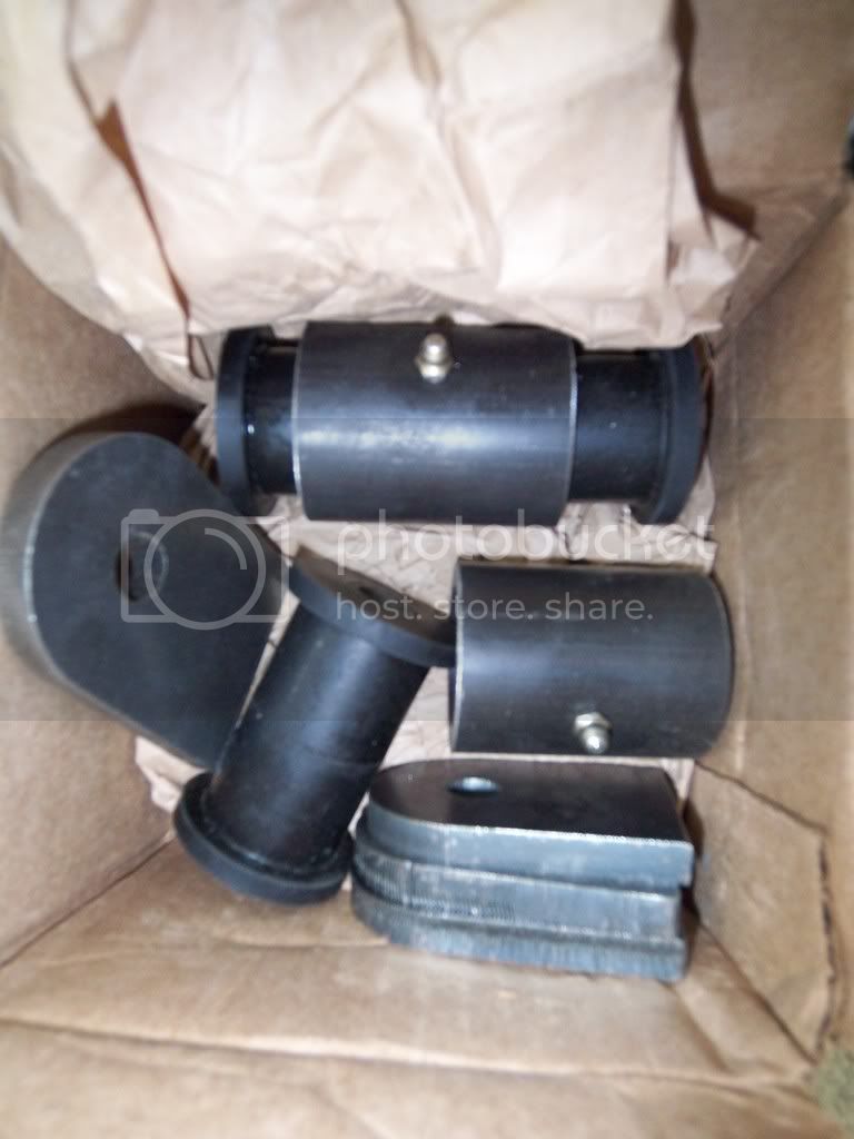

refering to camcruiser13's pic #21 are the grease zerts a litle over bord for cage tie in or just a good practice to get in? I'm going to use my extra spring bushing to fab up mine so I was just wondering.
I too am also wondering this......
not the pin just the zurt
that’s a great idea for $.75

No way I'd put a greasable pin in there. Zerk fiting seems smart to keep the squeeking and the wear to a minimum without sacrificing strenght.
O.k. I agree with not putting greasable pins in.... (why the hell would you gun-drill a perfectly good bolt anyhow? When I pay for bolts I like to use the WHOLE thing!!)
But do the joints make that much noise?
If they do, does it sound like a 20yr-old truck with dry leaf pack rubbers?
ive never noticed any noise from my Poly Mounts on my drive train and i don't think i even put any grease in them, they don't move that much at all! im sure grease could not hurt, but i see no reason for a grease fitting in a mount application..
