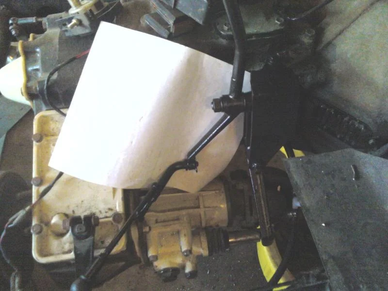

Keirnan, The engine/tranny/transfer are mounted by rubber and may flex different than the frame and may cause the shifter to pop out. I built my own twin stick for about $30$
Gary...thanks for your note and concern. You very well could be correct. There seems to be a fair amount of play in the existing linkage, though the pivot point is stable. I am hopeful that it will stick just fine.
Twinsticks are the better solution....I know.

I too, am a little concerned about that shifter tied to the frame. There is a lot of movement there under low speed high torque situations.
Remember you don't want any pressure against the linkage as it wears out the flats of the shift fork and then it will pop out of gear.

I went back and looked at your pics-you have the shifter pivot bolt on the tranny-why not use a 74 up shifter? It would slide right on that bolt, and would be independent of the frame?
A huge thanks to VTGreg for giving me a late 70's transfercase shift linkage. I picked it up last night and got it all installed. I am in business and ready to start dicking with mounting up the tub. I just need to pick a neighbor to help me get it onto the truck.

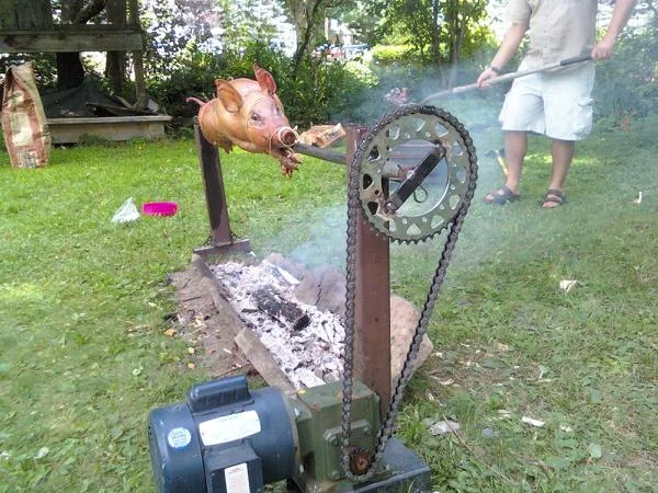

Not so much time in the shop on the cruiser...but did fab up a sweet pig spit for a bbcue this past weekend....
Now that you tested it I think that you are the official FG pig roaster.
Thanks for the vote Lane.....I would certainly bring it down there....if someone had access to 115v and brought a slaughtered pig, or side of beef, or something....

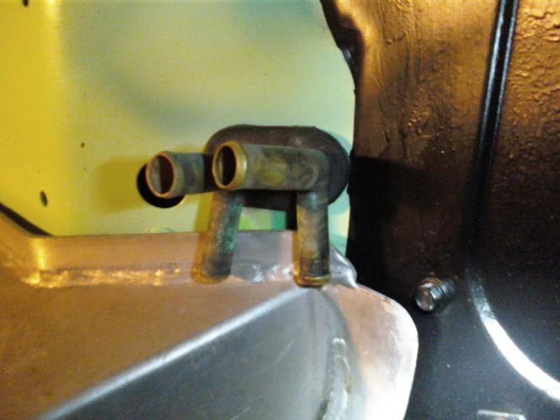

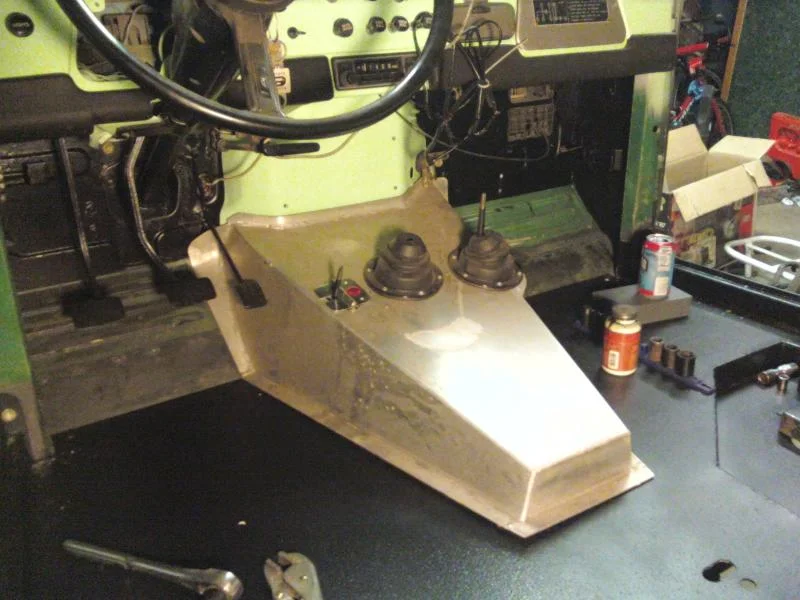

Anyway, I got my tub on this evening and about halfway bolted down. I had to make a run to home depot for some more bolts. I turned my attention to the Aqualu tranny tunnel, cutting a hole for my PTO shifter, priming it for paint etc. The heater pipes look like they are going to be a problem as the tranny tunnel does not leave enough room for hoses. I posted up on the 40 series board hoping someone had seen this issue and had a solution.

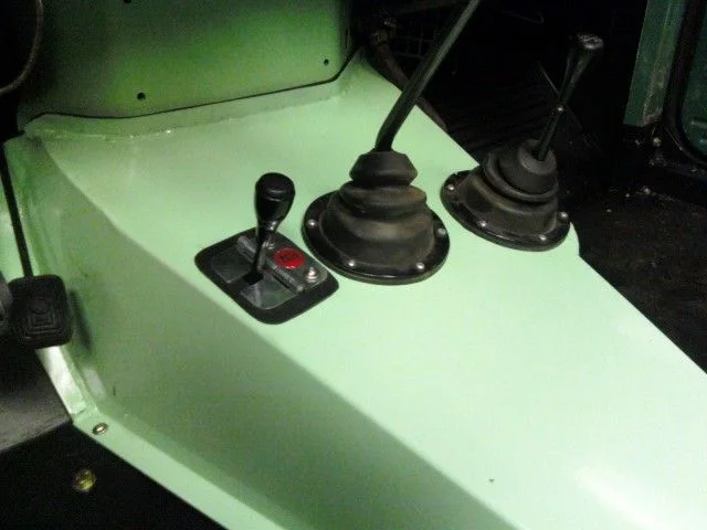

I am pretty proud of how nicely the pto shifter looks. I know it is a bit of bling, but I kinda dig my fabrication. I got the rig out and around the block last week or so.....just a shake down run to make sure all was ok before buttoning up the tub and tranny tunnel.
Very clean nice work. It looks like it will be a great truck.

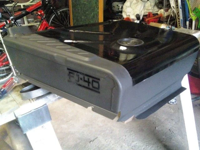

And I am still trying to finish up the gas tank installation....course I did take time to wire wheel the tank cover, add some bedliner and a sweet decal. Froggy fresh....
It all looks great now....but a little mud, dirt and abrasion will certainly add character.
