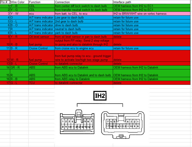

I have received many requests for this sheet. Probably should have done this long ago. These two images will help those taking on this swap to pinout the IH1 and IH2 connectors that are located behind the glovebox and serve as the main connection to the vehicle harness and vortec harness. My swap was done on a 1994 80 series which uses a separate computer to control the transmission. The later 80s had the TCU built into the engine ECM so they won't have the 3rd plug (IH3). The IH3 is pretty much eliminated on those vehicles that have it unless you want to add in the gear indicator on the dash.
**please note these images apply to the '93/'94 model year trucks**
To help interpret colors, i used the same method as used in the Toyota EWD. Example: 'R - G' would be red with green tracer.
IH1:
IH2:
When I did my swap I relied heavily on the Vortec ecm diagram that is posted on E38 ECM Connector Pinouts - https://lt1swap.com/E38%20ECM%20Connector%20Pinouts.htm
Enjoy!
Just to avoid confusion for people it may matter to, these pinout charts aren't entirely accurate for all 80-series.
I don't know about later model LCs, but I know for a fact that my 97 LX body has significant differences. One inconsequential difference is that the equivalent connectors on a LX450 are actually IL1 and IL2.. this was the source of confusion using the factory EWD when I first started my project.
I have direct experience with a 97LX450, and my diagrams are for a 96LX450, so I can say with at least a little bit of confidence that these specific models are different than the 94 LC. Unsure whether 96-97 LC is the same as mine, or as the 94 stuff shown above.
That said.. I'll list the differences per my charts:
IH1/IL1
Pin 4 White/black Ground for noise filter
Pin 7 Red/black Gear "R" indicator lamp in cluster
Pin 8 Green CDL motor power (polarity depends on lock or unlock)
Pin 9 Green/Yellow CDL actuator switch
Pin 10 Green/Red CDL motor power
IH2/IL2
Pin 3 orange (chassis side of connector. Engine/trans side is Green/red) Gear "2" indicator lamp in cluster
Pin 11 Orange 2nd start switch in console
Pin 12 Red/White 2nd start lamp in cluster
Pin 15 Green/red S2 trans solenoid signal to cruise ECU
Pin 17 Green/Yellow AC water temp cutout switch (triggers the AC temp cut relay)
Not all of these are needed for a vortec swap.. but for instance if IH2 pin 17 isn't accounted for (unused on a 94LC) your AC compressor won't engage and I could see it being interesting troubleshooting this.
Anyway.. hope this helps someone out.
Good call. My rig was a 94 so the pin out I posted applies to the '93/'94 model year. These had the separate tcu and a 3rd connector in this harness. The '95 and up deleted the external tcu and connector. Wire colors are different as well. Anyone taking on the later model year swap will have to study the applicable EWD and match up the pins.
I didn't even think about wire colors.. but yes, on my Lexus even the circuits that were there for the same purpose had different color schemes in some cases.
The moral to this is anyone doing this swap should get appropriate wiring diagrams and invest the time in learning how to read them. *info posted here is for informational purposes only and if your rig burns to the ground it isn't my fault.
Or something.
im digging through the 97 lx450 ewd's.... I still need to 100% confirm these but about a 95% confidence level
As you can tell there is a significant difference in pin out!
I am sorry if this is a dumb question. But multiple wires from IH1 and IH2 run to EC1 do I need a pin out for EC1 ?
So does this say the '94's also need a pin out for IH3 ?
