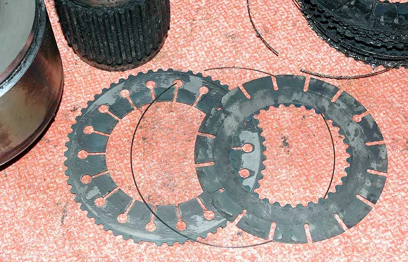

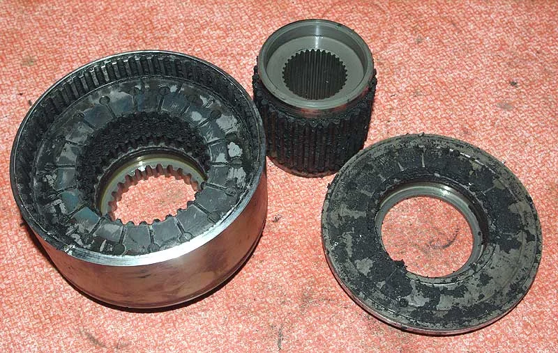

This is what a burned up one looks like.
right .... thanks .... will look out for a good used one ...

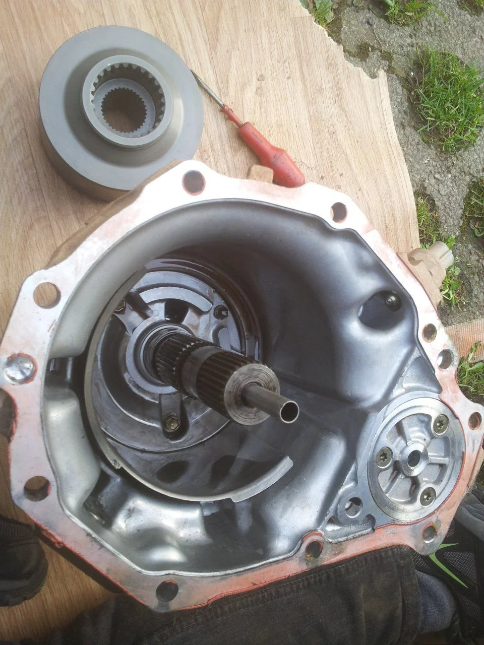

Finally got around to removing this VC thingy ....
Was a lot easier than I gathered it might be. ..
truck feels a lot smoother to drive without it.

Is the Viscous coupler essentially a rubber bushing between the front and rear drive line that dampens? Or is it more complicated? The photo in my eyes makes it appear as it is a rubber device that has failed. There is another thread right now where the OP is worried about installing different sized tires front and rear and causing damage to the coupler.
It's a fluid coupling, steel plates with silicone fluid, works somewhat like the fan clutch with a lot more surface area.
