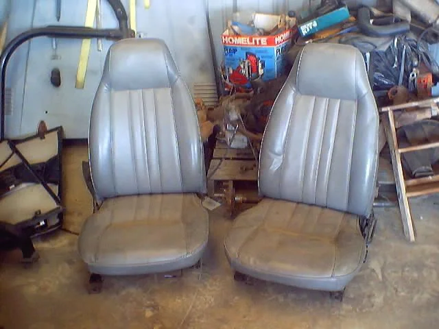

If you are still looking for seats, I have these that came out of my buddy's FJ40. Not sure if they are stock or not though.

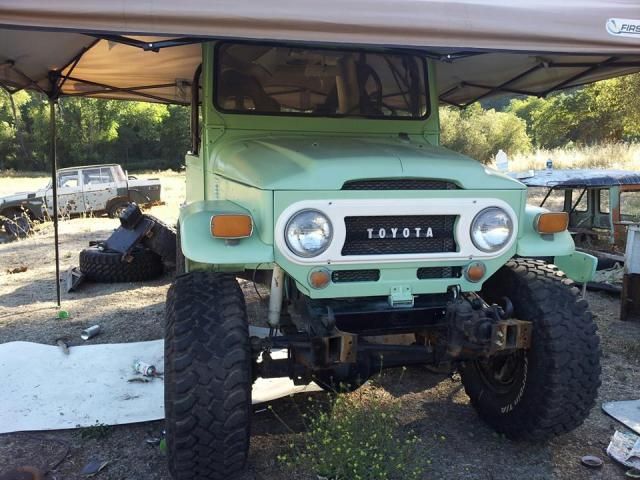

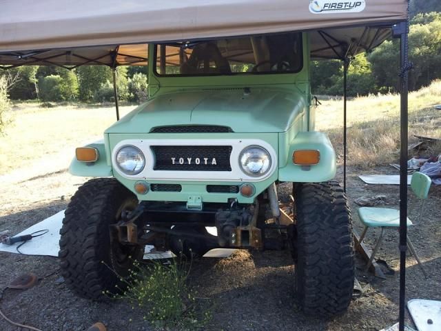

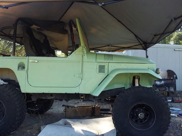

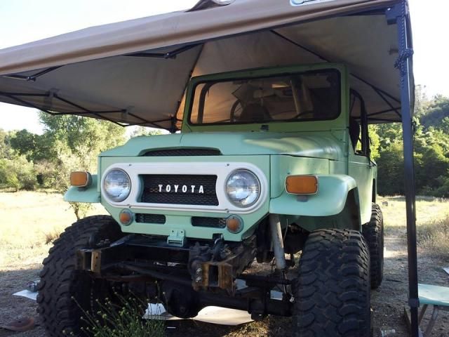

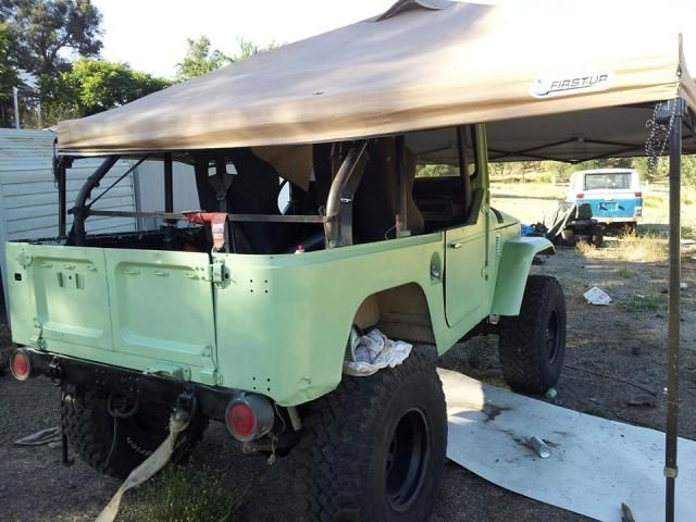

All day sanding and almost there... sooo close to being able to paint the rest of it.
the new color is definitely better than the old color :cheers:
Wooooo.... it's green. All of it.
Got to clean up some overspray on the frame, take the grill off and respray it black. Took the tailgate off and am going to do some more work on it before putting it back on... but overall... it's done. That was a crapton more work then I expected to do, but the more I sanded the chips the more I found I needed to just take it all down to metal.
It's a 5 foot job for sure, didn't come out perfect, but nothing about my cruiser is perfect and it's a wheeler so its going to get rockrashed again and be dragged against manzanita all summer so it's good enough. It got the cruiser back to the look I wanted cheaply.
