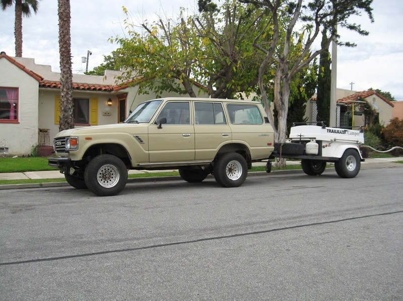

Related: the ball on my TV is a few inches higher that the trailer hitch. Any issues with a bit of a angle or should the tongue be mostly flat?
On my list to research that further. With a tiny, light trailer I'm not sure that it matters a heck of a lot. The FSB certainly didn't care about this small angle over a 660 round trip for the Parker 425 a couple years ago. Well shoot! That is my only pic of the combo and it doesn't show the angle at all. I'd guess that the hitch is ~4" higher than where it would be with a level tongue.
Pending further info I don't feel like even this combo of our FJ-60, "Wallace", and the TB trailer, "Grommet", is angled too much. Although I was horribly abused on a extremely snobby Land Rover forum for the pic. Never mind that that the furthest this combo went like this was almost 1/2 a normal city block! Note that this pic is of the trailer on the 33's while the one above it is on 31's.
It is important to more heavily loaded trailers. With a flat tongue the braking thrust stays parallel to the pavement. If it is tilted up then the braking thrust is mildly trying to lift the rear of the towing vehicle. THAT would be bad! If it is tilted down then the braking thrust will be trying to push the rear of the TR down, which doesn't seem too bad until it is realized that this means that the front will be coming up!
Makes sense. I don't have pictures handy, but I can take some. From memory I would say I am a little more angled than your trailer hitched to the 60. I haven't noticed an issue but the trailer is very light and I haven't had to make any evasive maneuvers.
On another note, Canvas Replacements just got back to me. They can and will make a replacement. Price is roughly $1200 and I would need to send mine to them to use as a template.
Just measured mine. The ball on the TV is about 7" higher than the trailer hitch when the trailer is level. With a 83" distance from wheel CL to hitch CL, that would put the angle around 4.8 deg if I did my math correctly.
