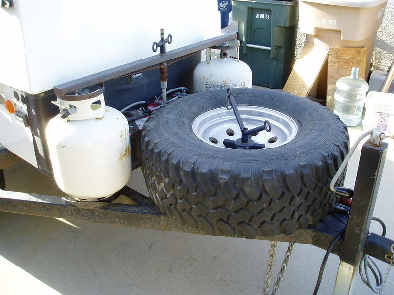

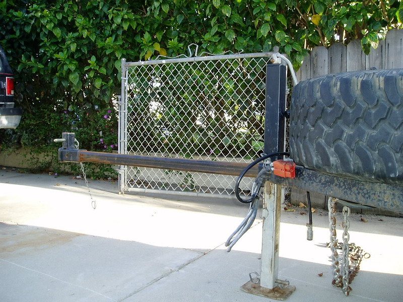

Ours was extensively modified prior to coming to us. A local 4X4 fabrication shop built it a whole new frame because the original purchaser planned on and did take it to Mexico, both Baja and the mainland. Shocks were added to the rubber 'torsion' suspension (something that I consider to be a requirement), a sliding tongue was included (I've only ever used that for moving it around the yard by hand), extenders were fabricated for the rear support jacks to better fit uneven ground, and a serious tongue jack was added. It was designed for a Warn M8 winch in a cradle to be able to be fitted at the rear of the trailer and battery cables with Anderson Plugs were connected to both the tow rig and to the trailer's own pair of Red Tops.

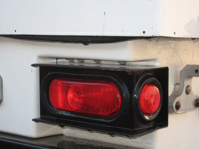

Eventually the original tail light assemblies became brittle and corroded. I found these powder coated boxes and rubber mounted, sealed lights on a tow truck supply page. They don't quite fit like stock, but unless you know what stock looked like you wouldn't know the difference, and I MUCH prefer these lights to the originals.

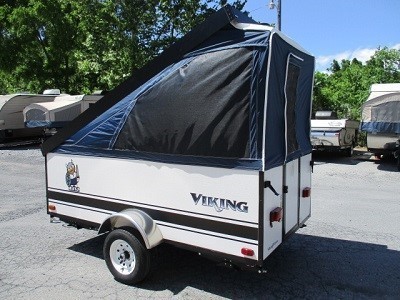

Neato, kind of reminds me of the current viking express, but more compact
