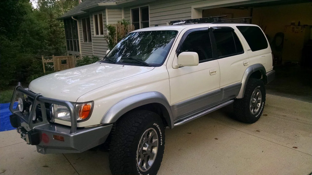

Not sure if my new 4Runner is something anyone cares to hear about, but . . . gotta post to see :)
We had to downsize from a 2004 family vehicle and a '85 offroad vehicle to one that combines both elements, plus serves as a daily driver for my son until he can buy his own vehicle.
First off - this thing is pretty built already thanks to Steelman who is on here and lives in Charlotte. I am really just going to log the things I do to it from here out
He did a VERY clean/nice job on this truck - I appreciate it every time I drive it!!
Already done:
SAW 2.5" C/O (set around 2.0")
Camburg UCAs
OME Rear 906 w/ leveling spacer
BFG KO2 285/70/17 FJ 8-Holes
ARB Front Winch Bumper
Superwinch
4xInnovations Rear Bumper w/ Tire Carrier
4xInnovations Sliders
ARB Rr Air Locker
Spidertrax Spacers
Pic as it was when I got it.
No picture. :(

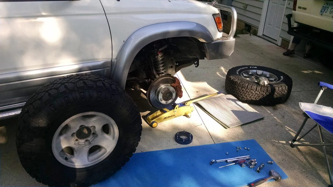

We tested the LC wheels with 33's on the new 4Runner. With the Spidertrax, they stick out too far. I ordered some .75" spacers for the LC wheels.

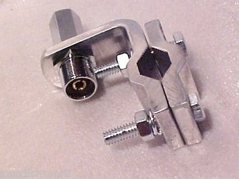

Last night I tucked the CB antennae wires under the passenger side carpet and plastic kick plate area.
I picked up this thing off Amazon:
Hoping I can attach to the top of the rear bumper's tire holder, so when it is opened it doesn't pull on the cable. I was dumb and bought a 3' Firestik, so need to get it up higher on the vehicle.
