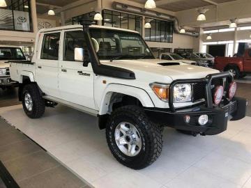

I found these in a listing on Autotrader SA....apparently I have too much time on my hands today :)
Grey
Now that I have looked closer, I think you are right, it's a grey interior. I have seen the grey interior in person and it is not even remotely that dark.

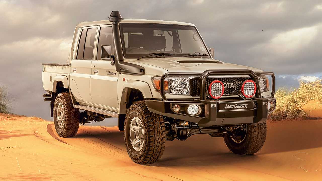

That Namib interior looks black, but I couldn't find any reference in the PDF that you uploaded. I tried searching PartsouQ and Megazip yesterday but all I could find was grey and oak trim. I already painted mine with Raptor Liner but.....if I could find a black interior I would rather go that route. The Raptor Liner is not bad, just a bit too much texture. There are lot of the GRJ76 in Japan, almost a dime a dozen, but I have never been able to get close enough to see the interiors.

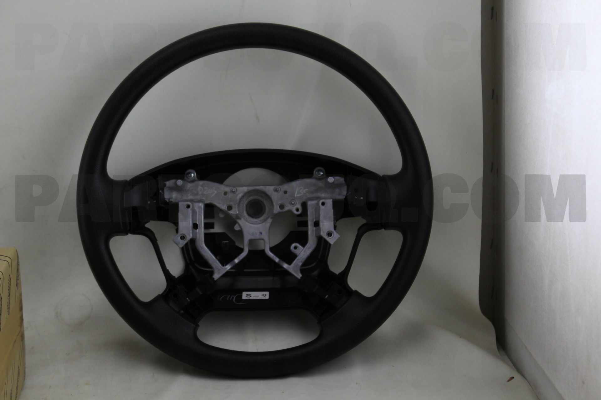

Part number suffix for color black is C0. B0 is bluish gray, and E0 is Oak. If the major part number hasn't changed, substituting the C0 at the end should get you the parts, in black, if they exist.
@bjowett Good call.... 45100-60600-C0
@Don Lacer '18 VDJ78 steering wheel (only, not the center button) is the same as one available on the 200 series and can be found in black.
So does that mean than that the part number is actually for the 200 series? Meaning, there is a black steering wheel which will fit the VDJ78, from a 200 series, but there is not an actual VDJ78 wheel available in black? Since the center is not available in black. Just to prevent confusion.
FWIW, the 200 steering wheel is interchangeable with the 2nd gen Tundra. Tundra steering wheels and airbags are a dime a dozen. I swapped an 08 Land Cruiser leather/wood wheel into my old Tundra, the air bag and all trim/controls swapped right over.
