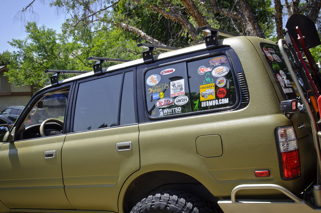

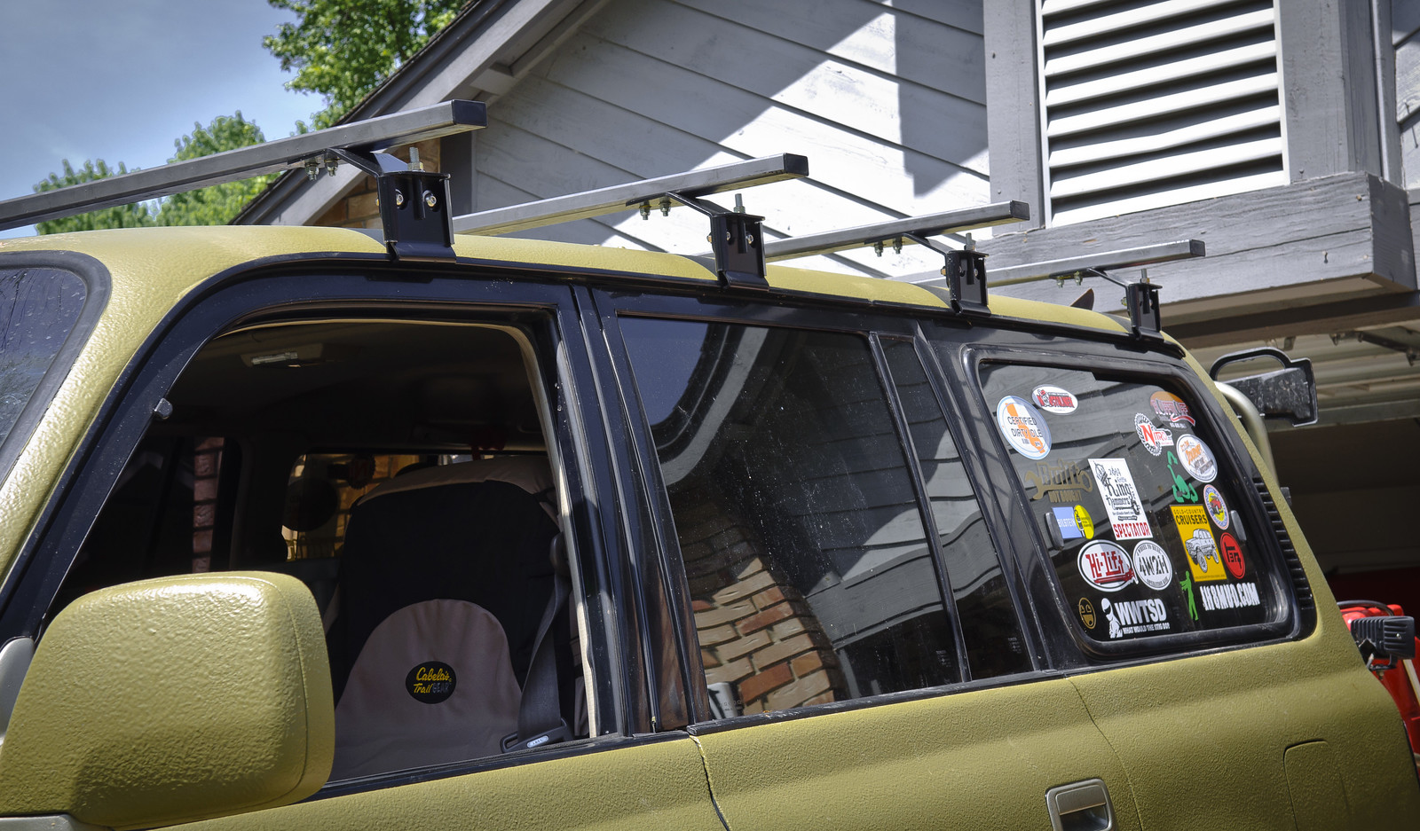

I made my own. The expensive part of this was the Gamivity gutter mounts, but there should be cheaper options out there.
Would these be tall enough? If they are id buy these right now!
Yep, it's what I'm using, even clears the factory roof rack.
You just have to make sure the bars are the 56"(?) ones, not the 48" ones.
