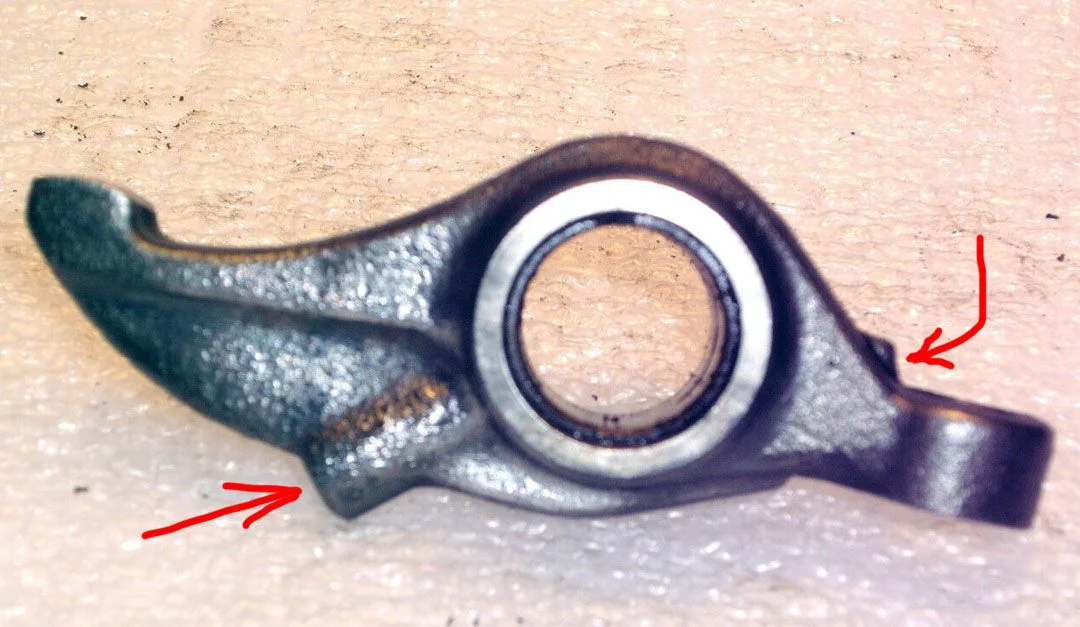

@Steamer , you say 2 holes for each rocker? I see the one over the Valve Spring side. Is there one over the push rod side? I'll see it when I remove it this weekend, but curious.
Boaf
Yup! Oil comes each end of each rocker. When it's all flowing good you'll see the oil running down the push rods. It's been awhile but I think the push rod side hole is on the bottom of the rocker.
