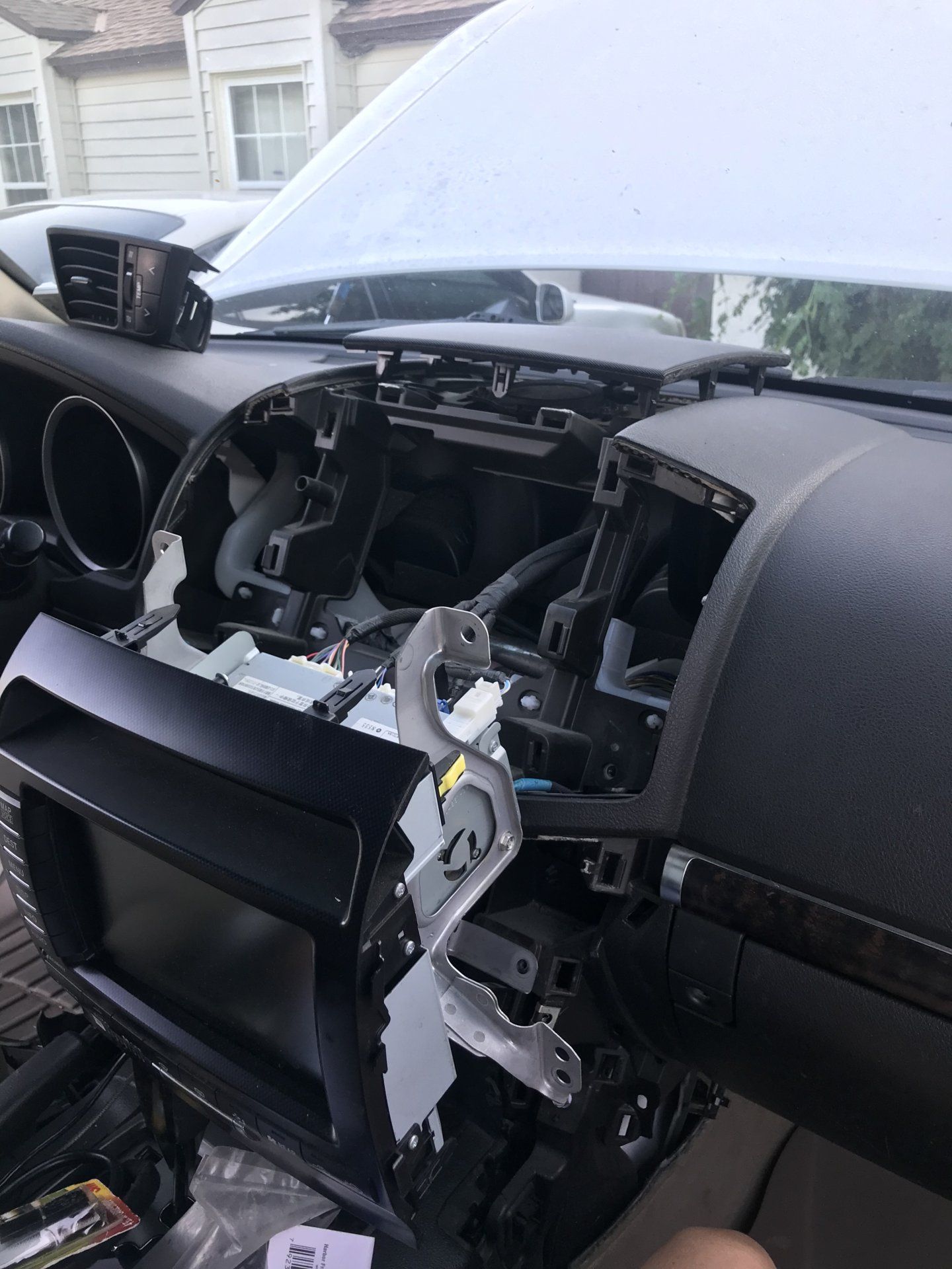

Took my dash apart today due to my phone not charging via the Bluetooth adapter. The Bluetooth workrd great just not the charging. I Replaced and reran a new lighting charger cord only to figure out it was a iphone software issue. If you experience any malfunction with this particular device simply go to the Bluetooth settings in your phone, forget this device and then reload. Also the velcro holding the adapter in place had let go and created this horrendous rattle when my air blower was turned on. I thought i had a major issue going on....all good now. Iphone updates are not friendly. I dislike them very much so. This device still get a two thumbs up in my book.
Glad it worked out for you man. Enjoy!
