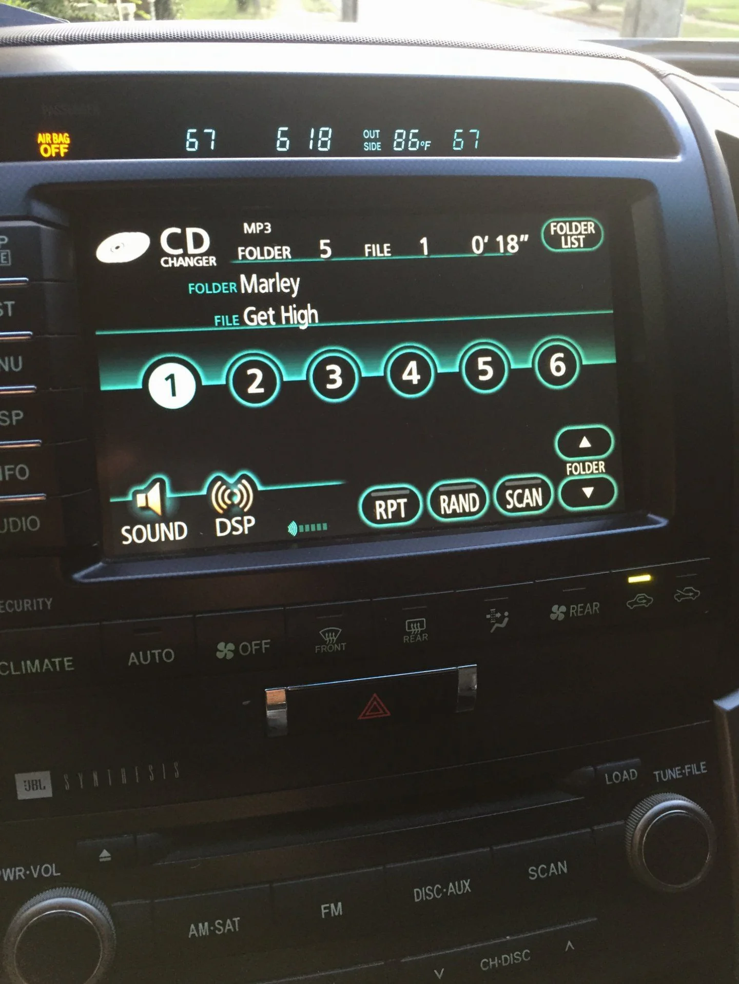

I installed it today. Took me 11 hours and 2 cases of beer .
that was the first song to pop up
HaHa
Good job
