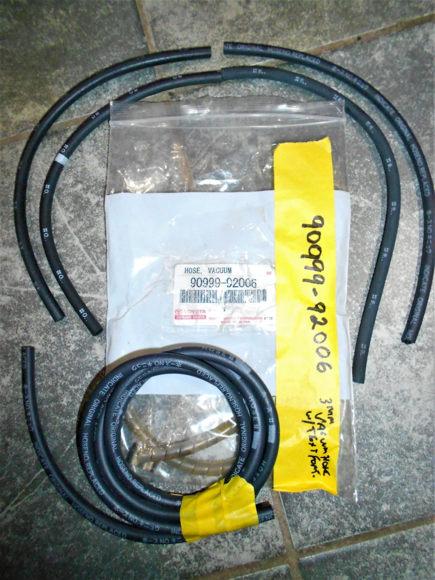

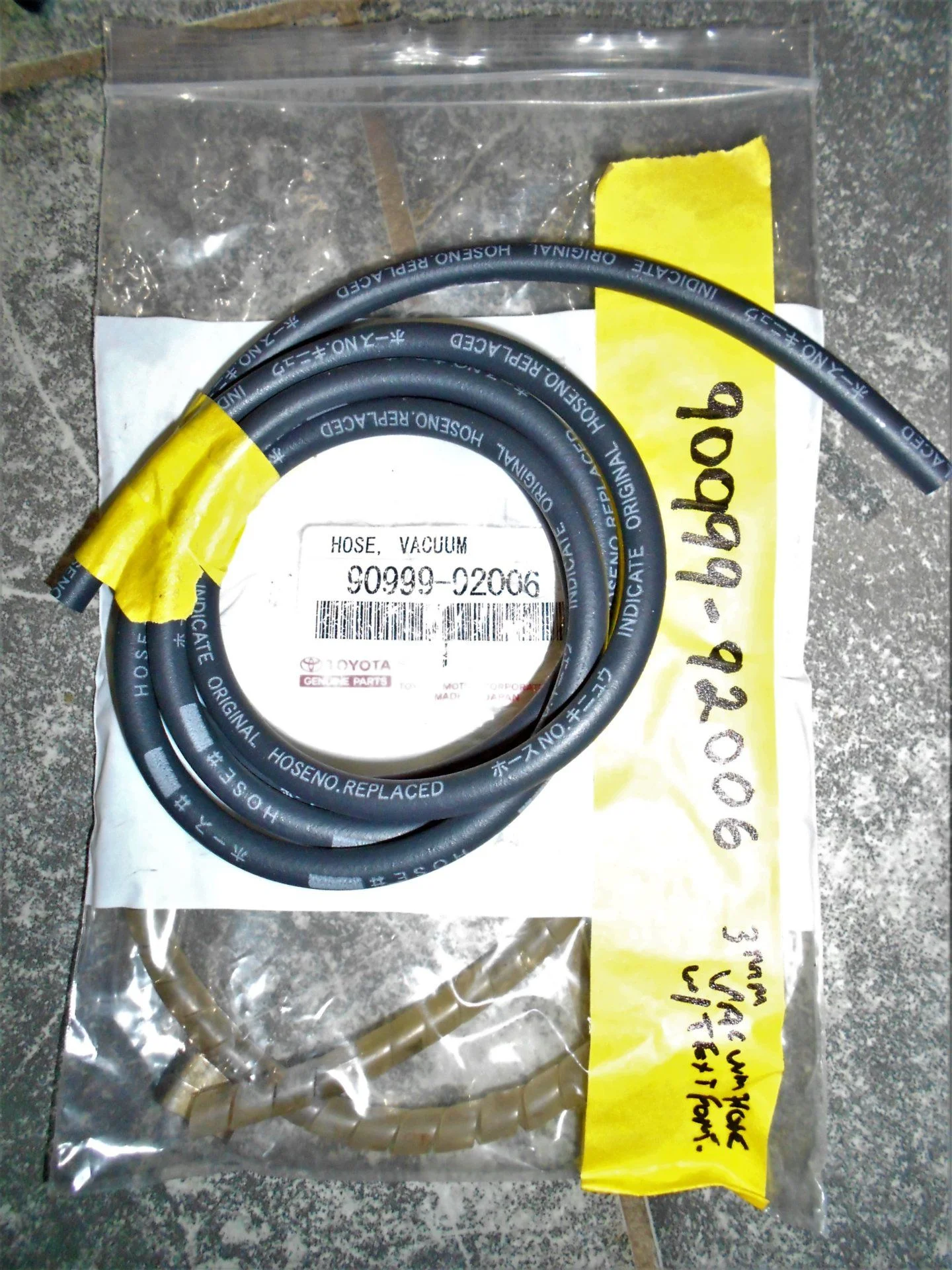

Silicon hoses won't crack (or at least they shouldn't). The hoses are labeled by ID. So all the thin spaghetti tubing on the 2F is 3mm hose (if you buy silicon hose). The OEM Toyota hose is 3.5 mm but nobody makes a 3.5 mm silicon hose that I've found.

Just saying... all the blue 3mm are intact. The black 5mm are the ones w/ cracks. Both I bought from SOR ... trying to figure out who now, found it, Summit. It was labelled vacuum line.
