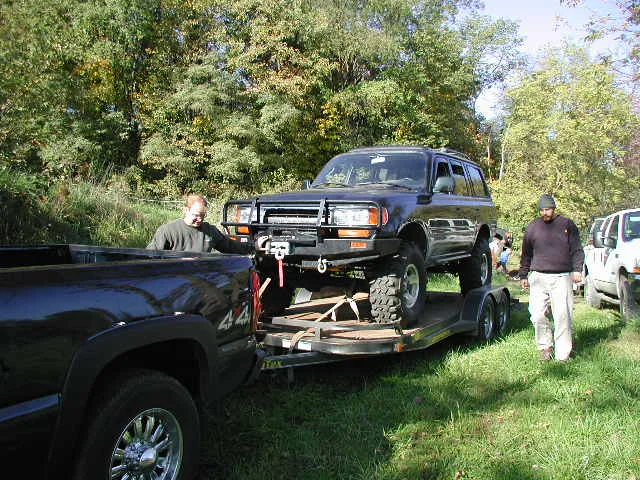

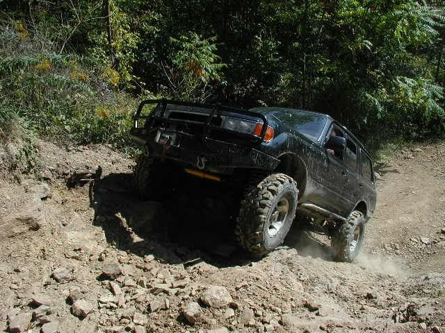

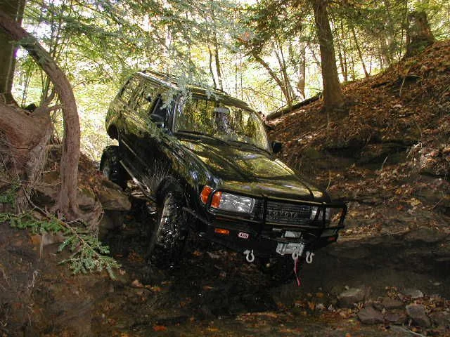

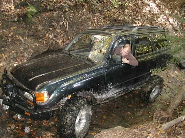

So, Kirk had the 80 out today in Wellsville, OH (our local playground).
I must say that without a doubt the V8 is THE correct engine for the 80 series.
It was amazing to see Kirk crawl, climb, push and basically conquer all the terrain he faced. And there was some tough terrain....
Amazing speed, amazing torque, and amazing power to get the truck over obstacles, hills, sheer walls, wet stuff, muddy stuff, etc.
A few small bugs as Kirk mentioned, but I think that he has reached a state of nirvana (christ, I almost did watching him do what he did today)....
