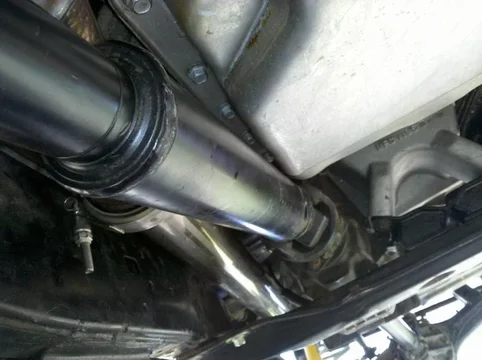

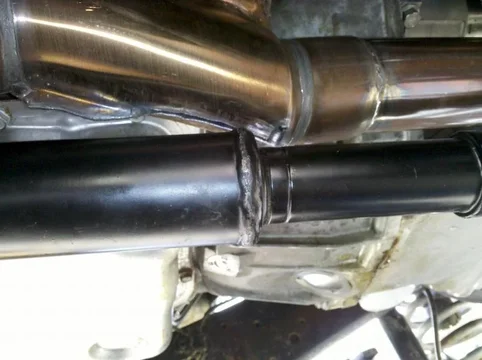

Hopefully I can get it back together for the weekend. I also took the time to put a small tweak in the exhaust for driveshaft clearance and touchup a leaky weld in the radiator.
