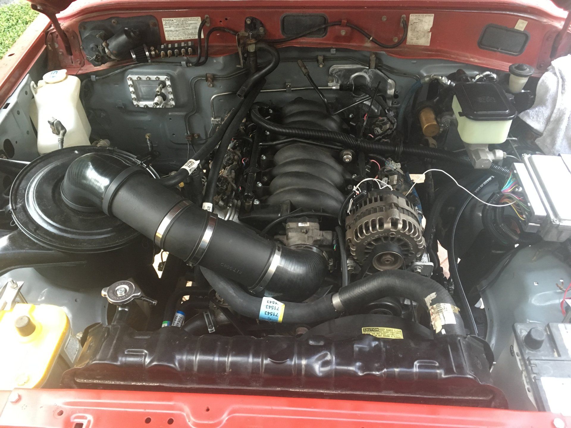

What air filter did you use. I’ve checked a couple but they were small inlet—-3-3 1/2 inch. Pretty restrictive for the LS
I copied the setup @NCFJ did on one of his shop builds
It's the FJ62 air canister, I lobbed the neck off it and welded a bead around so a 4" 90-degree hose clamps on. I have been wanting to open up the inlet on it to 4" or so (it's like 2.5") just haven't gotten around to it. The whole thing is probably pretty restrictive, but the big steel canister is pretty cool. Seems to run the same with or without the filter element in it.
Here's a pic from when it was fresh. It's much dirtier now :)
Check out my insta gram i used the 62 box and sized up the inlet used a peice of mandrel bent diesel exhaust tubing into the round hole in the fender worked great and you have fab skills so your all good. On another swap i did we used a k/n style big cone air filter then the owner put the 62 air box in with a reducer and stock size inlet he said he could tell a difference in power by going with the 62 box next one i will more than likely go full custom air box instead of hacking up the 62 air box.

yeah, I've seen it and got it saved in my "ideas" folder. I just need to get around to it like the hundred other small projects
