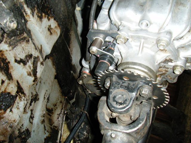

What are others using for a speed sensor with a GM V8? What worked...total configuration.
Well, that question depends on what engine/PCM and auto/manual. With the auto you need a VSS for shift points but with a manual transmission the GM PCM’s (the LS/Vortec one’s anyways) just need to know the vehicle is moving.
I’m using one of the ABS sensors on my rear FZJ80 axle as a VSS. Free and works perfectly.
