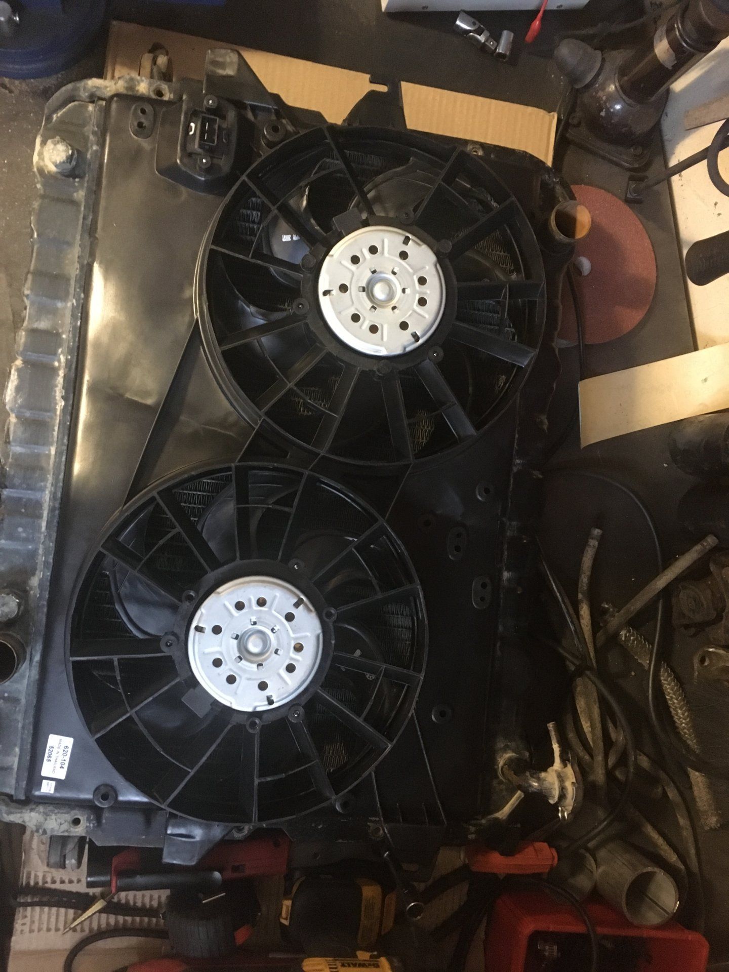

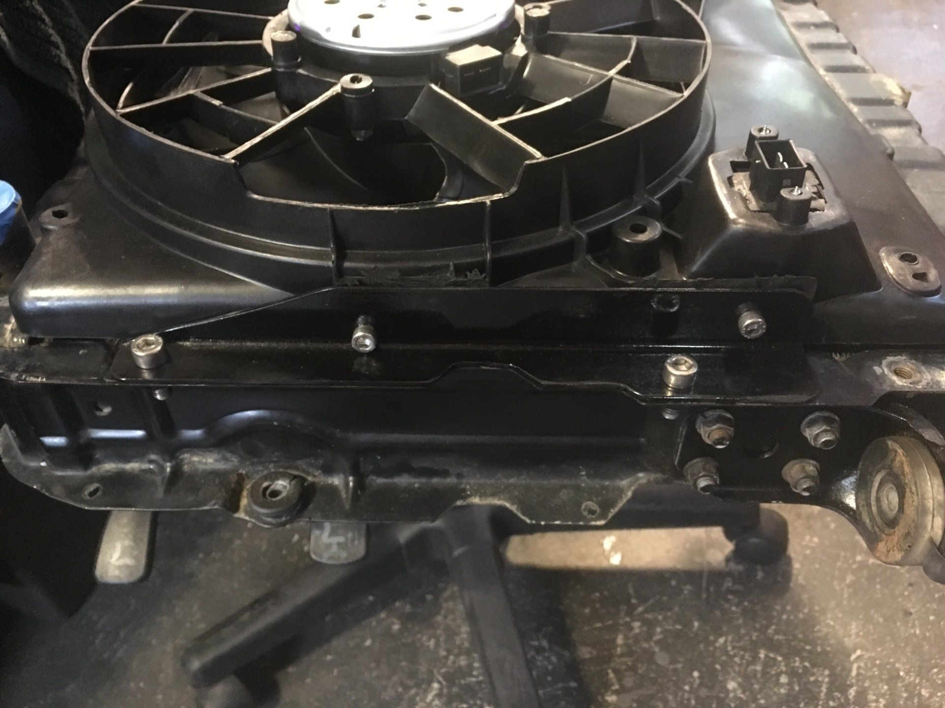

My simple and easy setup.
Ford Contour fans. Stock radiator (20 years old too). Simple brackets, two lengths of angle iron (from a free bedframe) with four holes in each (plus some shaping so they don't look like i just drilled some holes in some angle iron). Upper hose is a stock 60/62 upper hose and a 240sx upper hose with coupler to convert from 1.25 to 1.5 and give the LS steam fitting somewhere to vent. Lower hose is a mystery. Any 1.5" hose with a bend in it will do.
I have had zero issue with this super simple setup in some very hot weather, and some trials on some very hot and humid days down here in Florida summer, Proof is in the results.
This sounds like too much effort for something that doesn't warrant it. Why make your life difficult, custom radiator, custom shroud, hours thinking about it, etc... ?

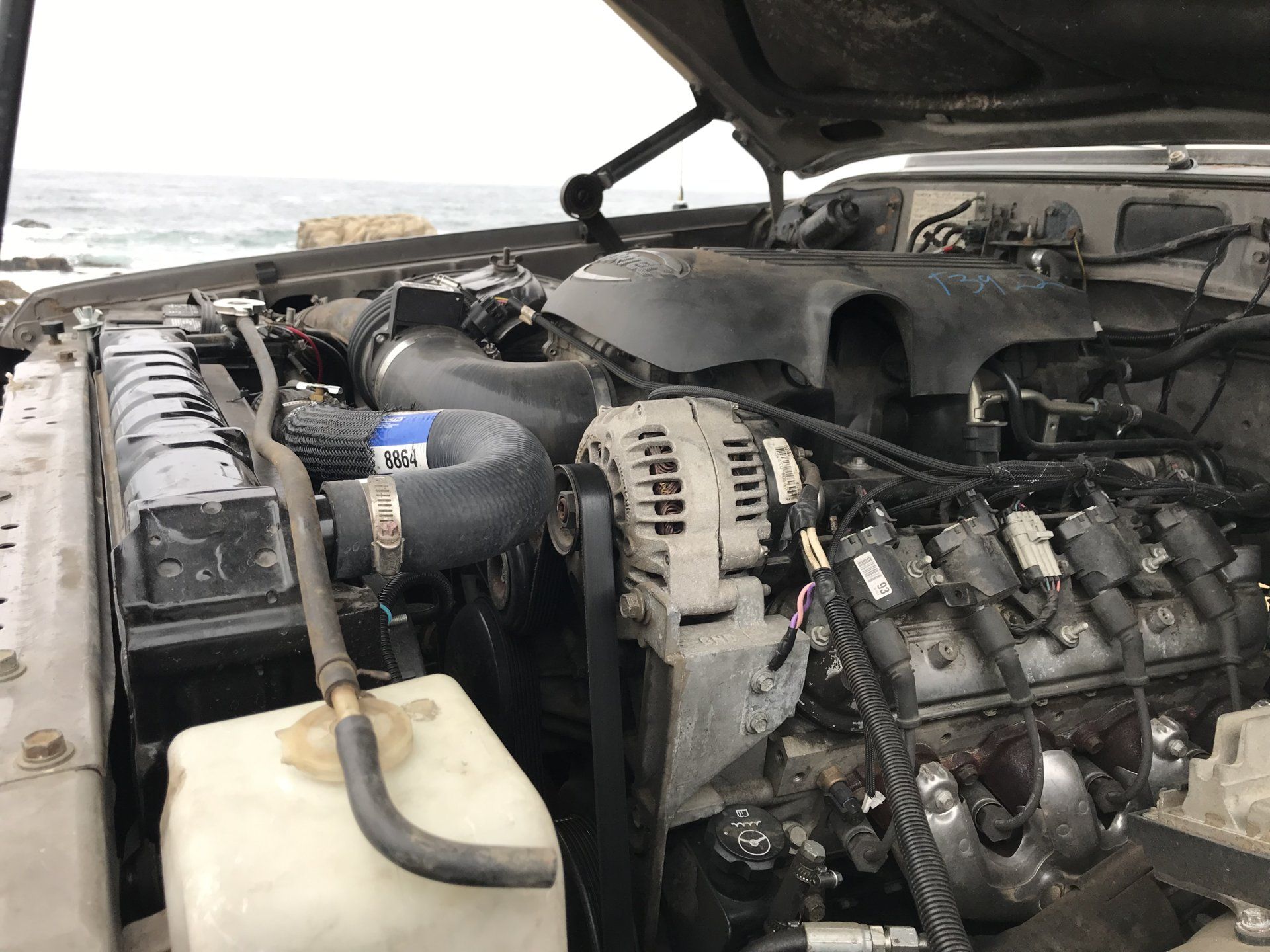

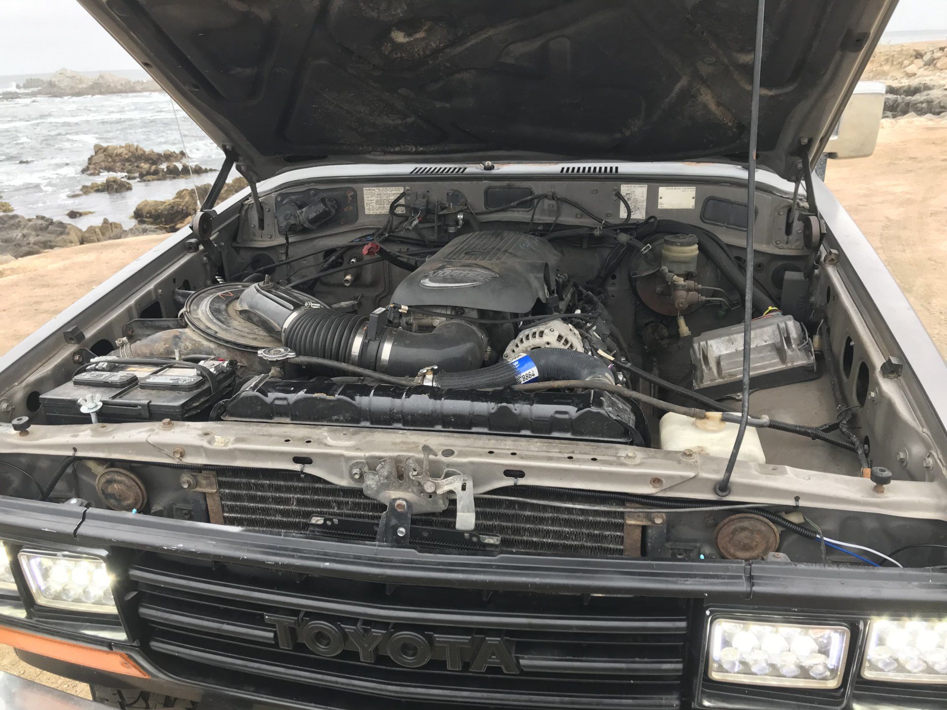

recent pic showing 5.7 vortec setup
My picture was while I has still setting everything up. I have AC in it now.
