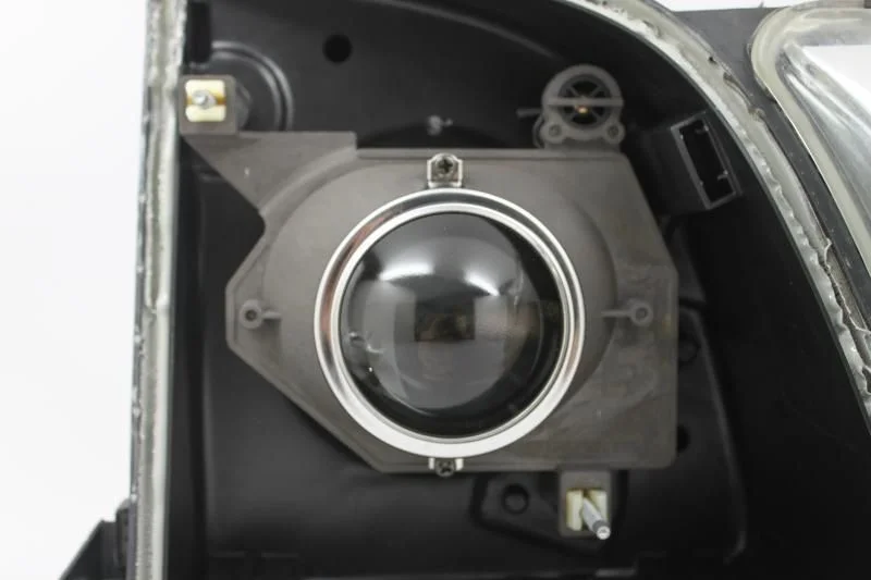

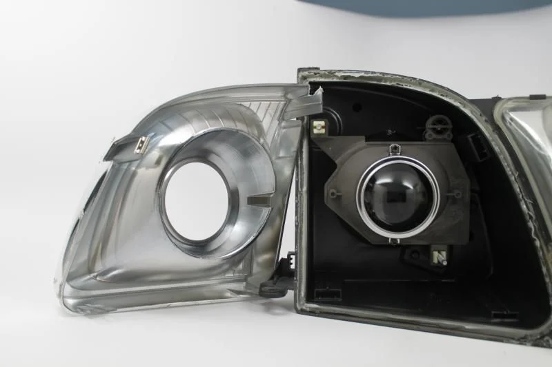

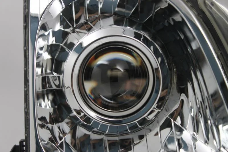

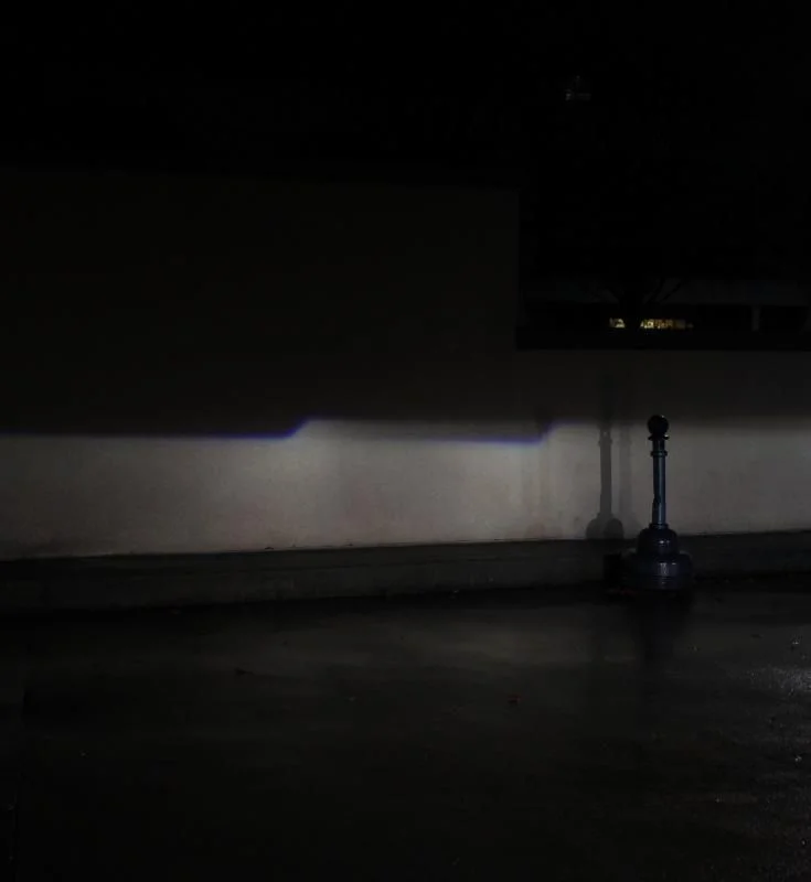

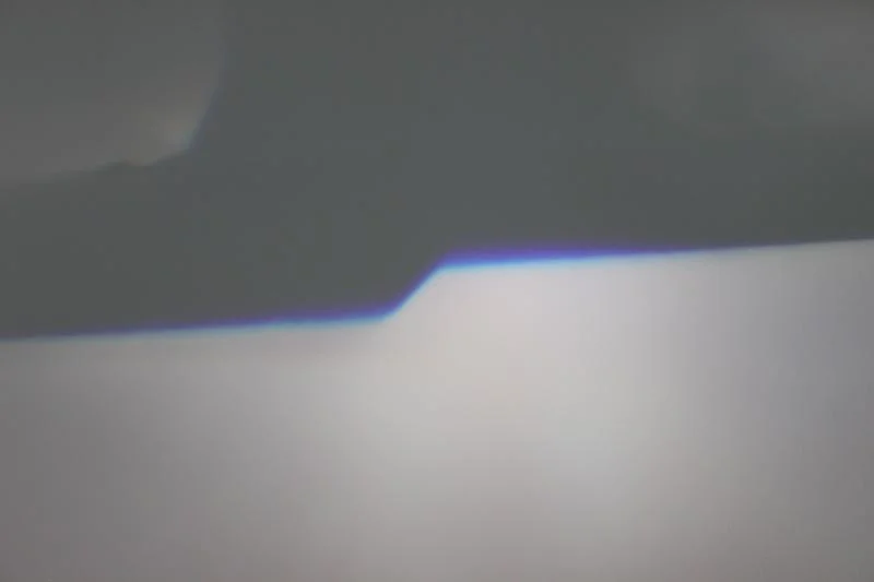

If you are wanting to stay with the OEM projector, I would advise a clear lens swap and a H1 HID setup. The Koito Projectors used in the LX are very similar to the AP1 S2000 projectors which is still one of the best projectors on the market. The only difference is a change in the bowl radius and the H1 bulb holder vs D2S. Please be aware that the LX projector is not very large, not does it handle heat very well. Halogens run much hotter than HID's, so as you increase the wattage of the bulb, you also drastically shorten the projectors life by burning the chrome off the inside.
The TSX lens will give you a huge improvement in light dispersion throughout the beam, it eliminates hotspots and reduces glare to almost zero.
I have done a few clear lens swaps for MUD members and the results are incredible.
I wanted a quick and easy upgrade without tearing into the light fixture. Though I can be persuaded to do certain mods if they prove to be worthwhile.

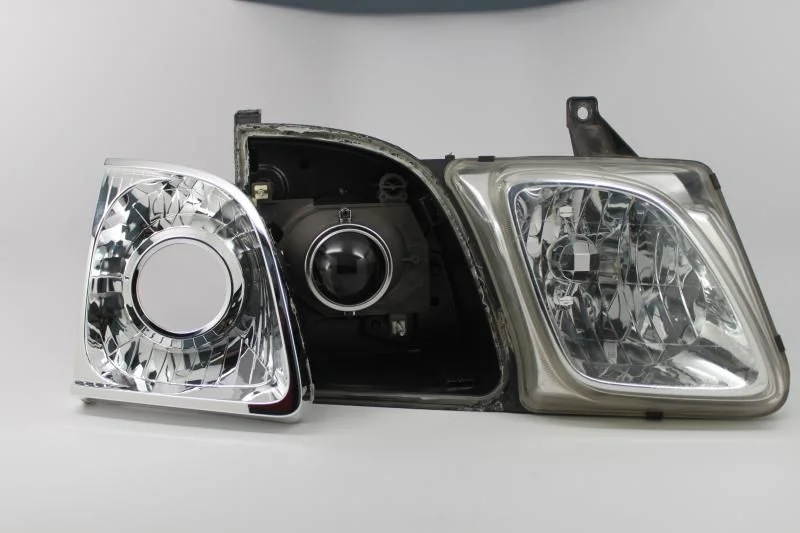

What do you mean by a clear lens swap? Is this a modification, or truly a lens swap with another projector?
The lens swap is not difficult, it's just time consuming for the first time. You will need to open the headlights and remove the shroud. Once the headlight is bare you unscrew the lens retainer and change out the lens. I'd advise blocking the squirrel finders, the clear lens make them huge rectangles.
You will need to space out the TSX lens 2mm, and use a o-ring to secure the lens. I would say 2-3 hours for the job. As always, the first headlight will take the longest.
Here are some pictures of the journey. I'm not forcing you to do this, but it is the easiest way to drastically improve the low beams without cutting the projector out and replacing it. That takes about 20 hours for both headlights.
