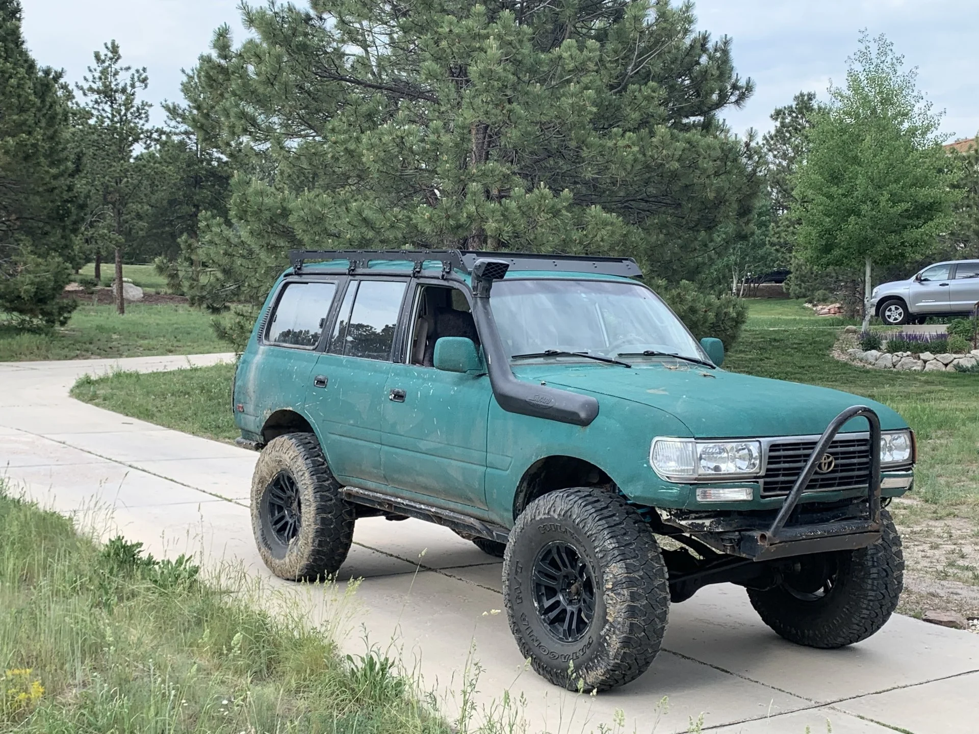

As a bit of background, I have a prototype set of Landtank’s brackets from forever ago - these shift the axle forward and were designed for proper pinion angle in a 4” lift with a front DC driveshaft conversion, which due to the great fortune of Toyota using a broken back stock design, means the DC conversion increases caster and at that lift height it’s more or less in spec.
I don’t know my caste because I don’t care - AWD is non-negotiable for how I use my 80 and in that case you can’t just set caster, it is what it is with proper pinion angle. I set my toe myself in like 2010 (1/8” toe in for a 37” tire) and it has not seen an alignment shop since, nor will it.
I ended up with over rotation of the pinion downward with the prototype caster brackets, and we know how sensitive DC shafts are to pinion alignment, so I had vibes with the DC shaft as the pinion was a bit over a degree low. So I installed an OME bushings in each of the rear axle mount positions only, upside down so they would rotate the pinion up 1.25° (yes, reducing caster, it doesn’t matter). This aligned the pinion, but it also had the benefit of creating more tierod to arm clearance. It looks like this:
With this setup, I have never had any clearance issue of any kind on 37s, starting on a 3.5” lift. The front coils are in their proper position (meaning the axle is), and I’ve also never had any unusual bushing wear (the OME are fine over a decade going) or flex bind beyond what these arms do naturally. We should note here that all caster plates are not created equal and they can do more than rotate the pinion.
So flash forward to now where I’ve gone to 38”
Patagonia MTs (same as @GW Nugget) and just recently to the new Dobinsons 144/155 coils. My 80 is light, relatively, and I am sitting 26” center of hub to fender, no flares, wrapped around the tire, on all four corners. That looks like this:

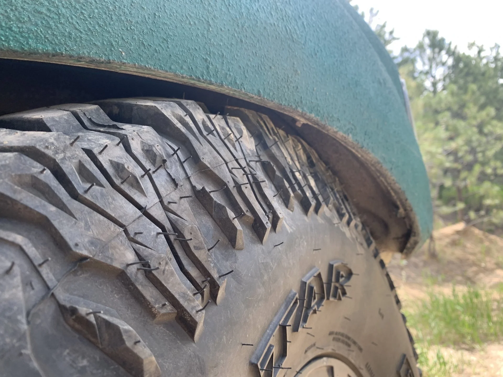

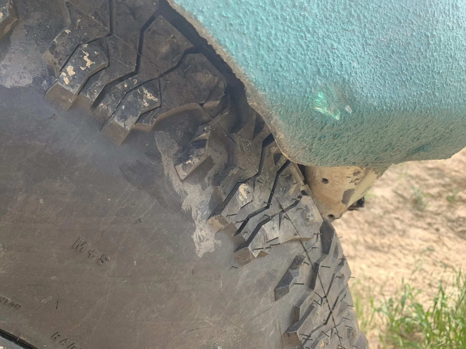

I am going to point out here that you cannot run this tire and actually wheel it with the axle any more forward than this. I have 5” of lift. I took these pics today:
This is the tire just kissing the radiator core when it is stuffed like this:
I sledged my rear inner fenders back at the angle of how the tire turns in - I didn’t have any road contact but it was too tight for off-road hits while turning. There’s nothing behind that lower fender and they were happy to oblige.

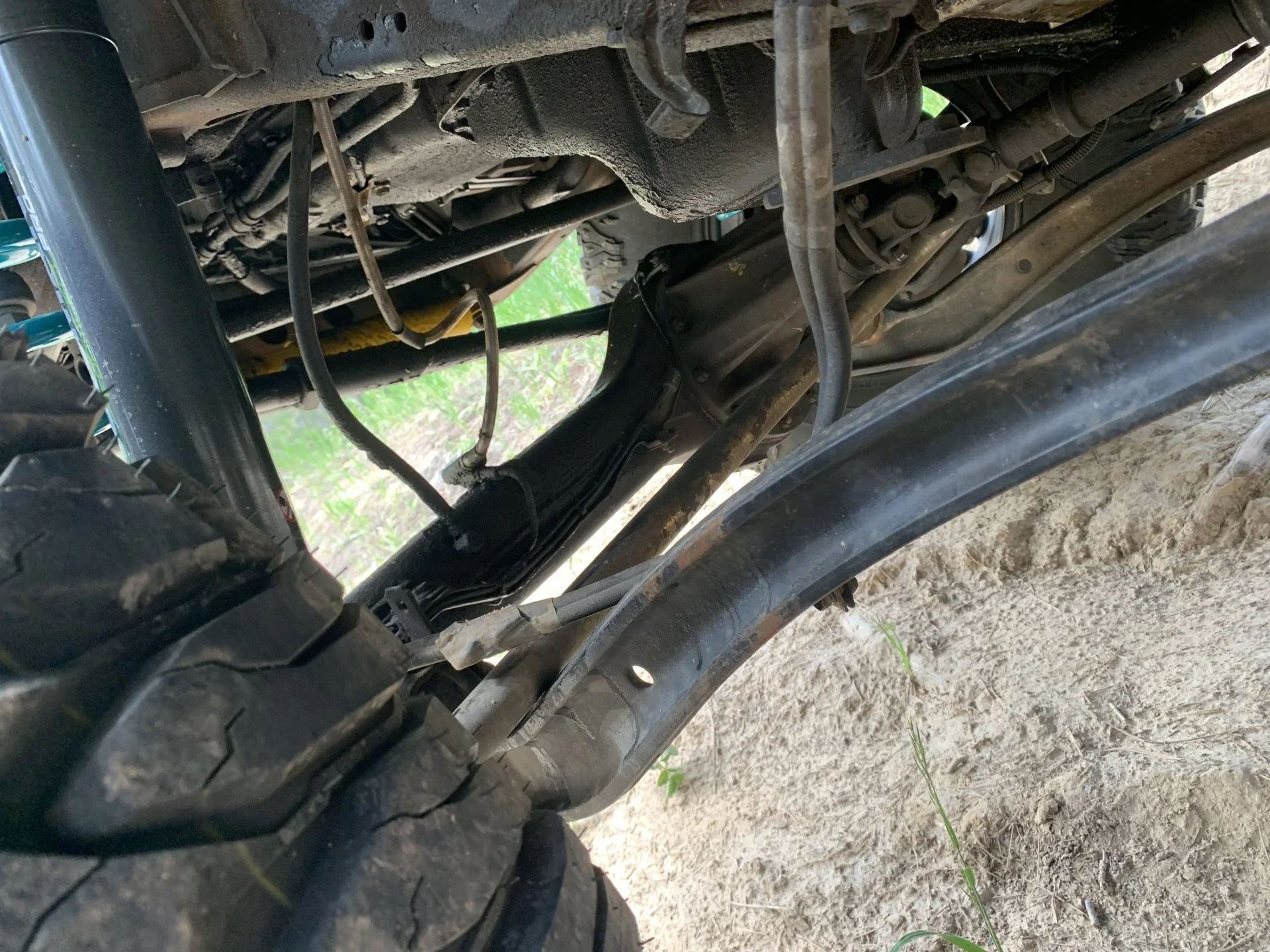

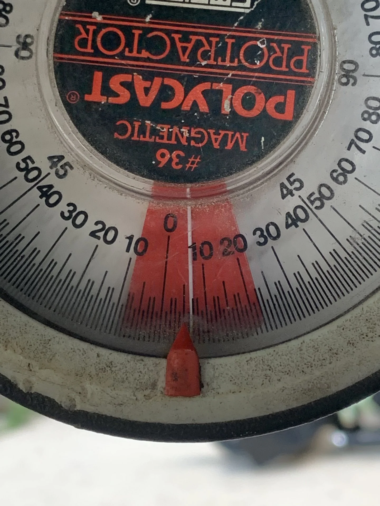

I had been running the 4” Flexi coils and while the front pinion was a bit high, no vibes, but I’m thinking “I should pull that OME bushing, because I don’t need it anymore with the extra 1” of lift from the Flexi and I could get that caster back”. But I didn’t, because that’s a pain in the ass. Now I have another 1/2” of lift and it’s just enough to put pinion angle out of spec and I have light decel vibes at 50-60 mph. By out of spec, I mean measured angles. First one is pinion u-joint, second is driveshaft. Ignore the actual angles my driveway is sloped, it only matters relative to each other.
That’s a degree off maybe a hair more, and DC driveshafts are fine until a degree. So I could just pull that OME bushing and it’s perfect, 5” of lift, perfectly corrected with caster plates, right?

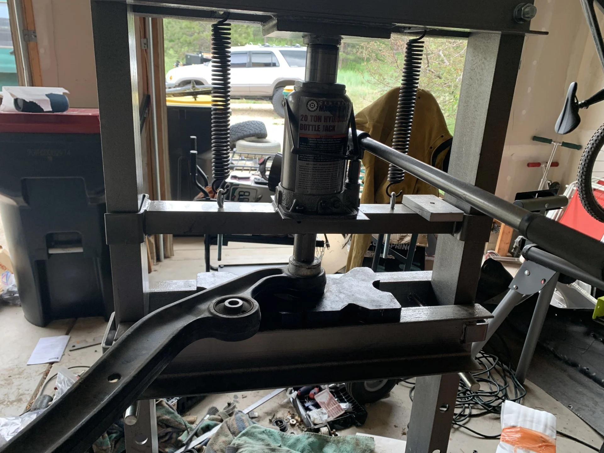

That’s a second set of arms getting fresh factory rubber, until while testing flex fit again after some rear trimming, I took this:
At full flex, it just barely clears the arm and the pinion. I pull that OME bushing and my pinion angle is corrected, so I can’t use more, but I’ll lose tierod clearance and there’s none to lose. A 25mm drop bracket would be perfect, with zero forward shift.

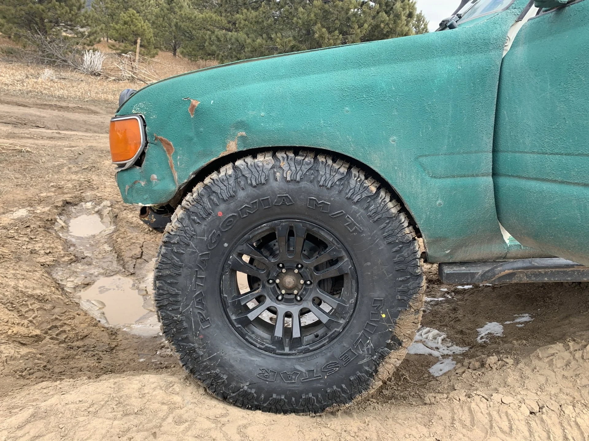

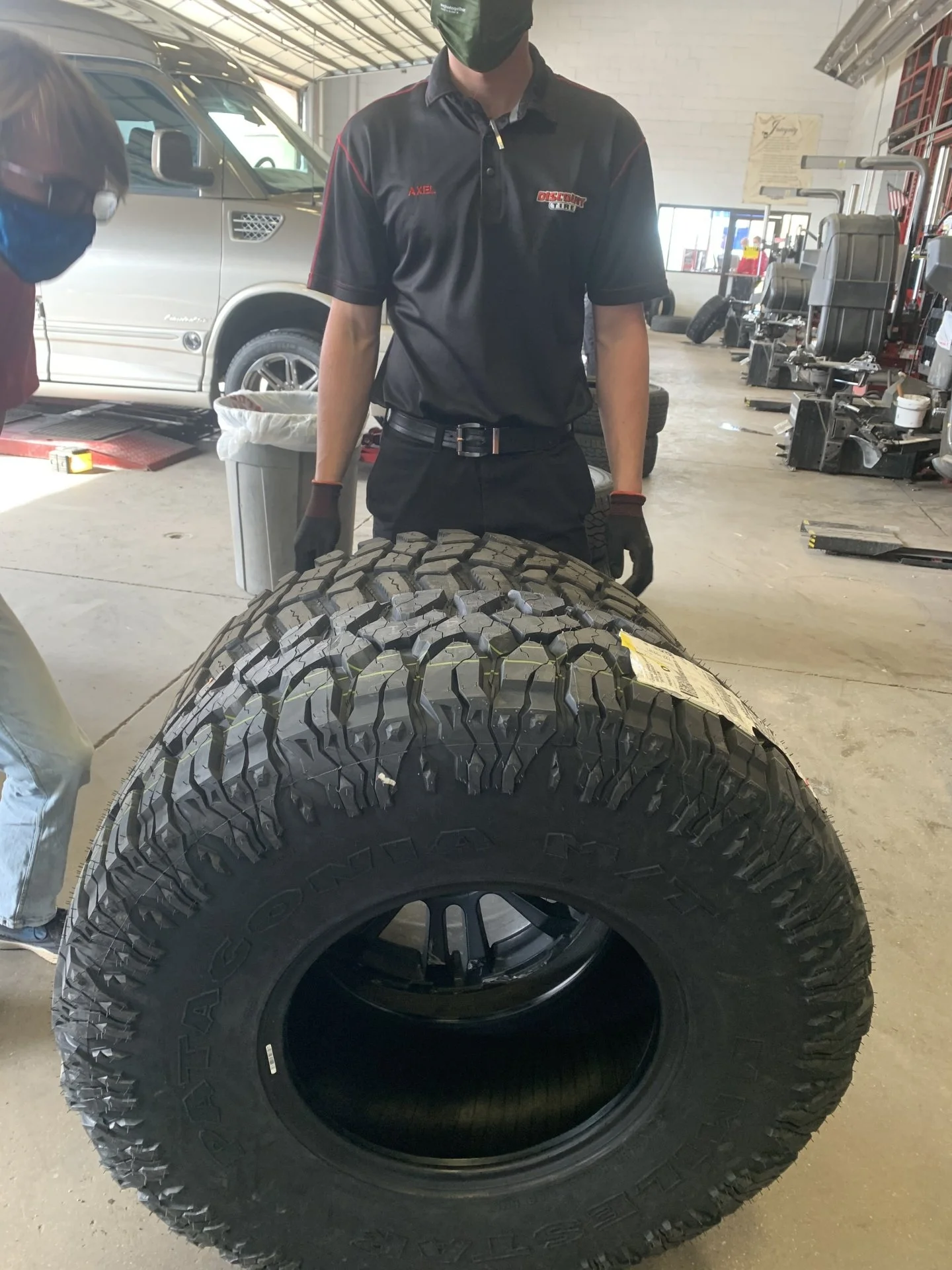

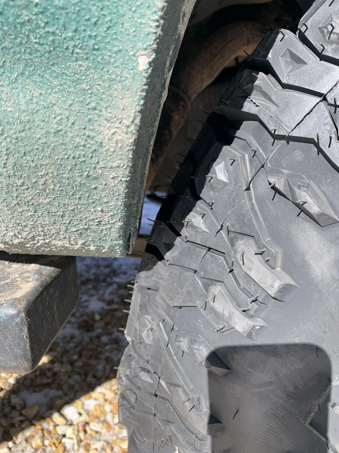

I’m curious about the axle position aspect so more picture time below. This is the 38x13.5 Patagonia MT, still on 4” Flexi, zero fender mods - it clears on road (remember, an angled arm compresses forward).
For anybody thinking the Patagonia must be smallish for a 38….
Here are is that tire compared to the true to size 37” STT Pro.
This is straight tire stuff on the 38, still 4” Flexi. The tire is perfectly centered and needs clearance in both directions for turning. My lower radiator core is trimmed so I have some extra clearance there.

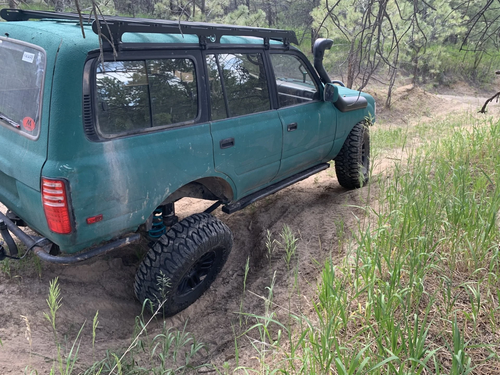

And here are the 4” Flexi coils on the tower under full weight. This is a 25.5” hub to fender measurement in this picture. I have 2” internal bumpstop drops and zero coil to tower contact under any amount of flex. The coils are centered and unbowed.

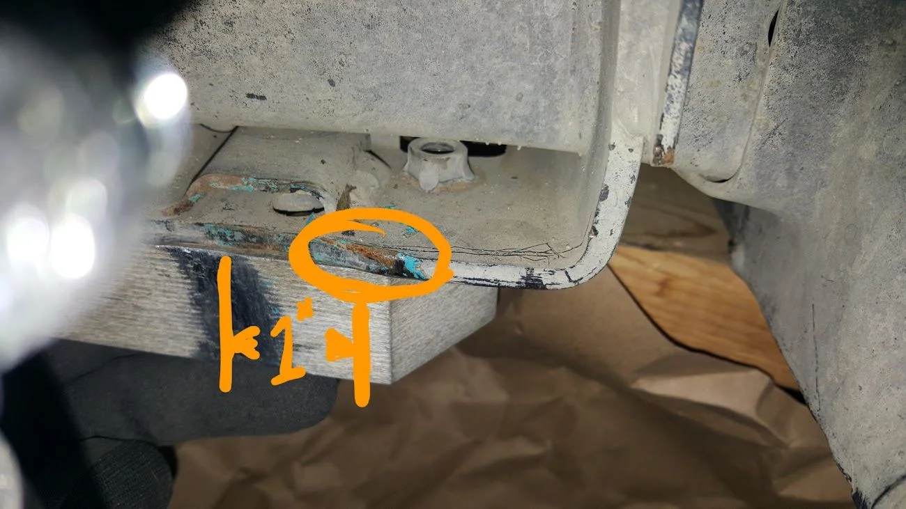

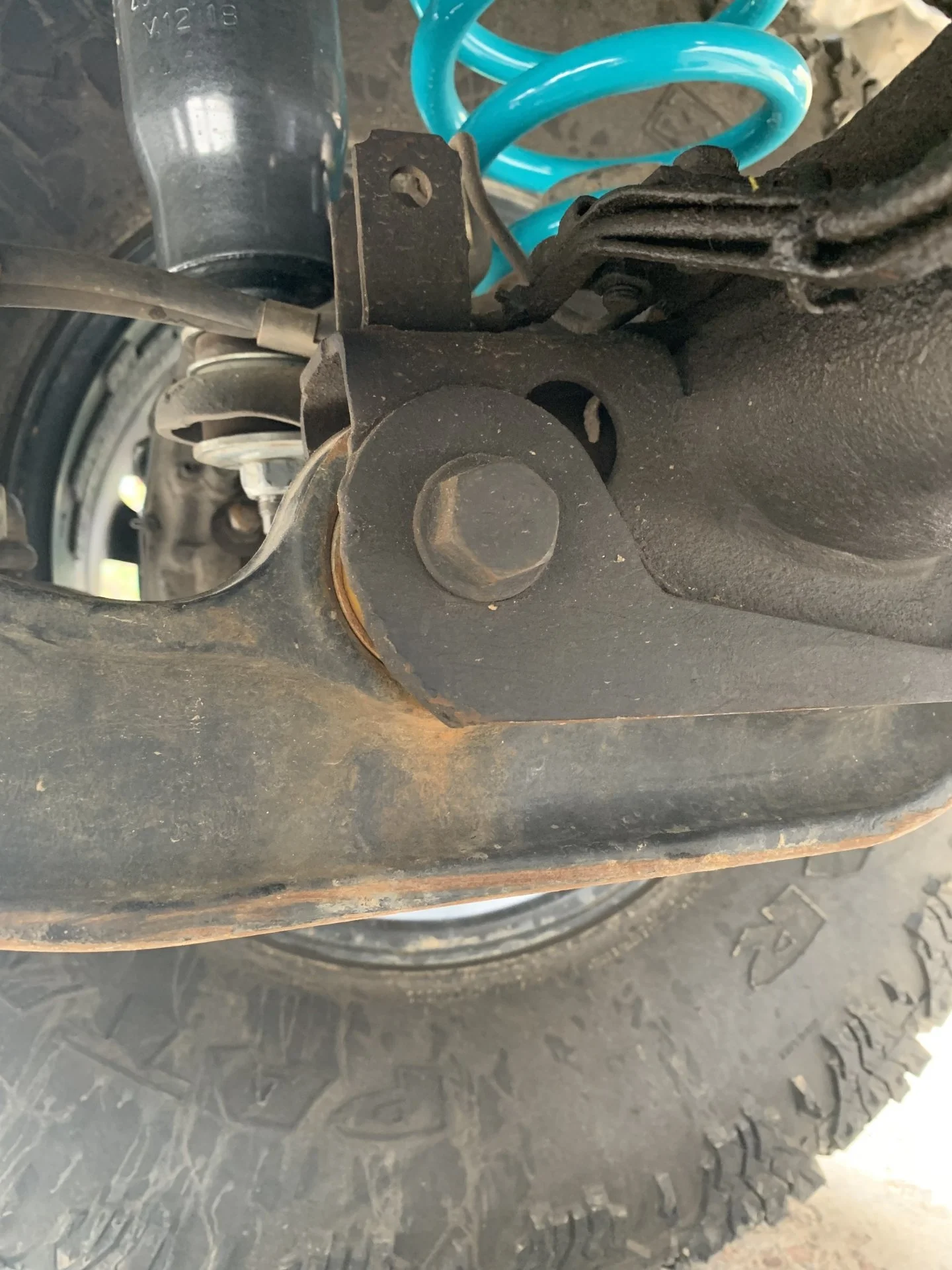

The short answer there is going to be no. The lower edge of the factory bracket is just shy of 30mm below the center of the factory hole - your new hole would be right in the flange - so 1" down isn't feasible if you aren't comfortable modifying the factory mount.
Beyond that; for most situations you wouldn't want to lower the pivot without moving it forward some, as you'd be bringing the tire in toward the firewall at the top of its arc (the lower the pivot, the more the tire arcs back toward the firewall as the suspension is compressed). In your setup, it might not be a factor as you are bumped down and not utilizing the full arc/uptravel available in the suspension - your tire is still arcing forward at bump (which is why you are up against the radiator core support at the top of your travel).

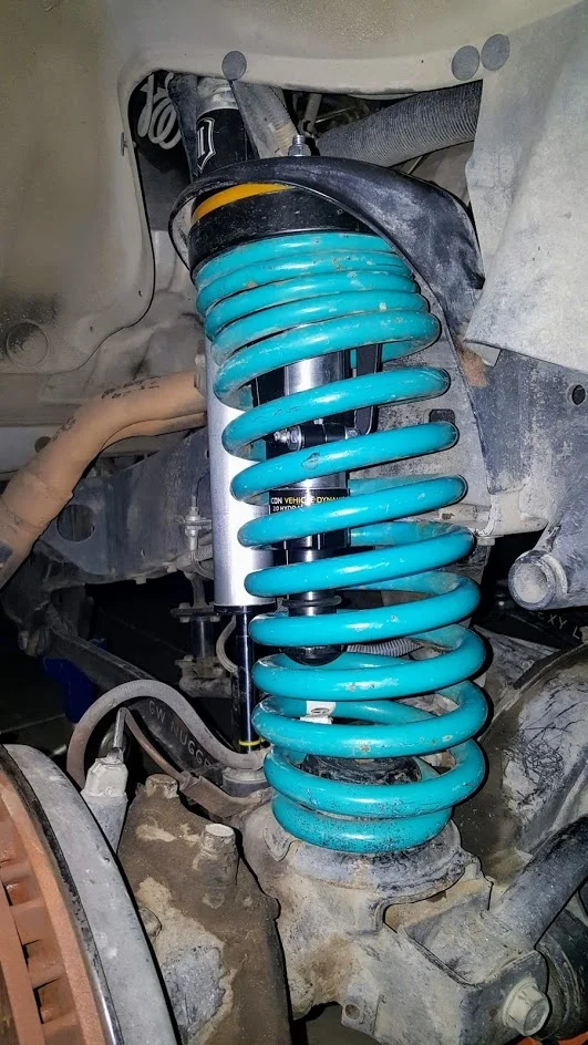

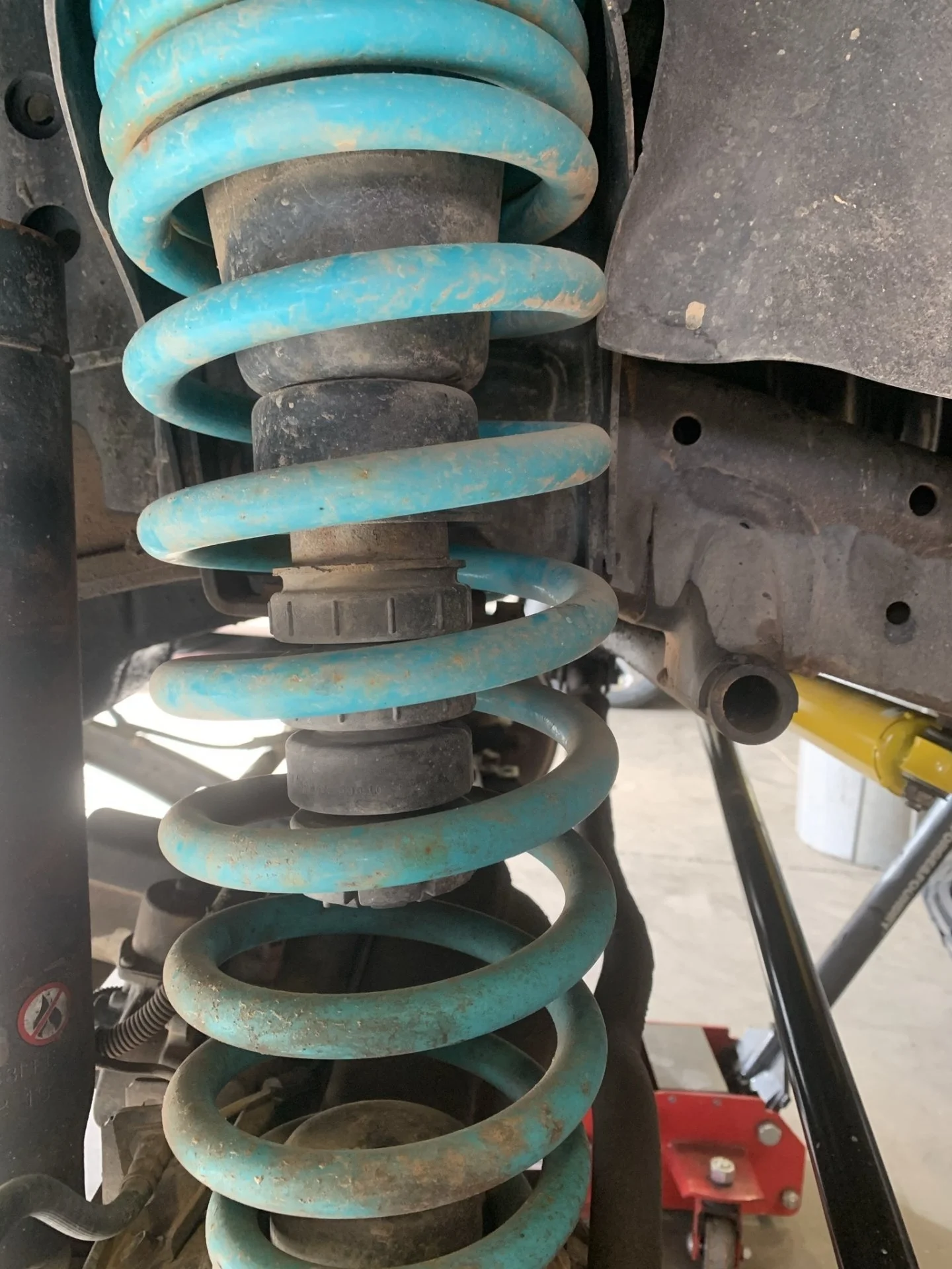

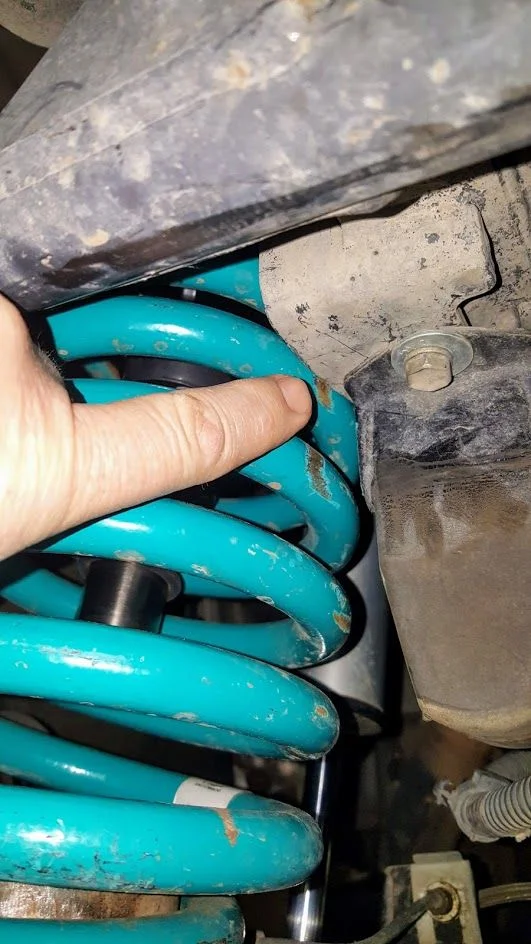

Since I have moved the axle forward 1" via the eimkieth weld on drop brackets I've been fighting right side coil to frame rub.
Moving the axle forward made the coil banana a little bit. The Dobinsons banana more than the TourFlex coils.
To fix this I need to get an adjustable front panhard bar to re-center the axle, but untill then I removed some of the conflicting metal from the frame..
More caster will give less banana also.
The Dobinson 146vt coil lift my rig 1.5" lift +25mm spacer +.25" bracket =2.75" of lift with 2" of caster correction.
The red coils are 1" lift +25mm spacer +.25" bracket = 2.25" of lift. with same 2" of correction.
This rubbing can be mitigated rather easily, I will show with pictures.
Can you say :banana: ?
Below is a before pic of the rub area on the frame.
See the paint marks?
After grinding...
Here is the TourFlex coil, these sit better.
I still need to get a front panhard bar.

@Nay; after staring st the bottom on my wife’s 80 on the rack, I have some thoughts about your original question - I’ll get back to you when I’m near a keyboard.
EDIT: - ok, had a chance to run some rough numbers on your situation... - assuming an agreed-upon compression measurement for the stock bumpstops and noting that you're bumped down 2", I think if you want to drop an inch you'd want to cheat the pivot forward about 3mm to have the axle land in the same position in the wheel well under hard compression. That 1" pivot drop would likely be a 1.78-degree change in pinion angle, btw. I'm not sure it would give you the room you need on the tie rod, though - it looks pretty tight in your photos.
You're already effectively spacing the radius arm away from the axle to give you more steering clearance, right? (plates plus offset bushing) I keep circling back to custom plates (which I'm sure you can do).
Anyway, if it is helpful, I'll send you a print of the pivot hole relocation if that's useful for you - might have a buddy with a plasma table?
It’s been a couple years so I’ll give an update. I’ve wheeled it all over montana, done moab twice, done a little bit of sand hollow once, and driven across the country multiple times. Thus far, I’ve hit them… a lot. But I’ve really only gotten stuck (enough to be annoyed with them) really only once.. it was a big big boulder. Honestly, I’ve been super happy with these. If you have a 2” lift, I implore that you get them. It doesn’t really dive, doesn’t really lean, and flexes well. For reference, I’m running a 25” long custom trail tailor spring, run a 4” lift dobinsons shock, and I cut the frame side shock tower and move the mount 2.5” down to get some extra down travel.
What trail tailor spring are you running, how much lift does it provide ?
