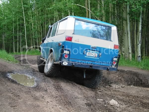

And as far as flex goes, I've got the same problem as treeroot:

treerootCO said:
I can't get any flex out of my SUA :crybaby:
