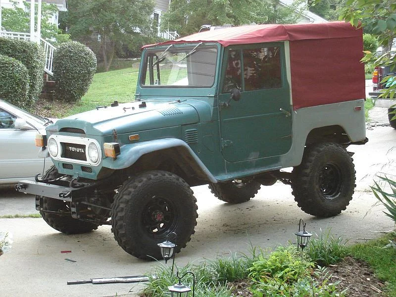

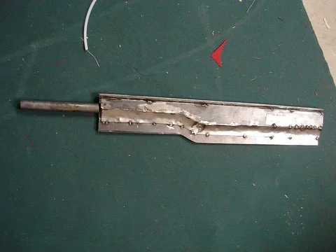

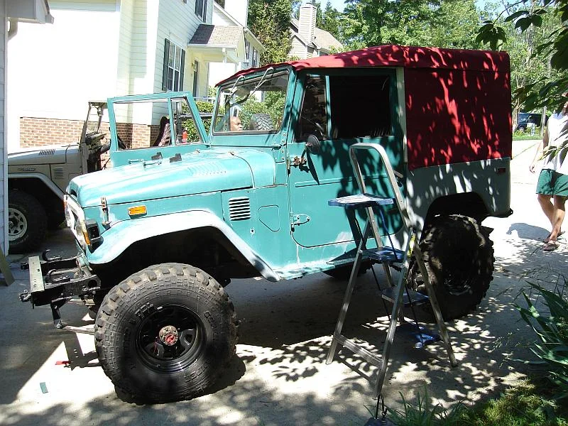

Here's where we are in a nutshell.....
It sounds like Greg [southerncruiser62] got a bit of a run around from a couple of metal fab shops regarding the frames. I understand that there is still one that is confident about making them efficiently, but is too busy to get to them in a timely manor.:frown:
So...this past weekend I went back to square one and looked into an alternative design that is simple to produce. Because of how promising the reproduction's sounded, I never actually sat down to work on an alternative prior to this.
Bear with me.....this is a VERY,VERY rough Sunday-afternoon-from-scratch piece. ;p A big thanks to Ramon and his wife [MTWELLER] for the use of his garage and tools! :beer:
I was only interested in producing this to portray my idea. Very rough measurements!! Just tacked together......I just wanted the general form to show softtopguy what I had in mind.... Nothing but Lowes and Ace hardware was open Sunday to buy metal, and they didn't really have what I needed, so I had to make do. I'll get what I need, and take my time with the next one and make it to installation standards. Hmmm, it's so rough that I hesitate to show it to you at this point! :o
I've really wanted to just wait and show the finished product, but as we've hit some setbacks that have delayed us, I don't want you to think that we've dropped the ball. We're dedicated to see this through to completion!
I'll throw in a couple of teaser fabric pics as well. Again, these are just made with random material for a pattern......
I'm feelin it man! Top looks good. Just need to get the bows mass produced. Shouldn't be hard with the exposure this thread gets and will keep getting. Someone here HAS to know someone that can get the ball rolling. Please keep us posted and thanks again for taking the steps and time to get this top produced.
What about making the bows out of a combination of metal and fiberglass or composite. Then you just use the poles and the steel channel with a couple steel braces in a mold and pour a composite in. Might give you the look and strength and make it easier to reproduce on a small scale.
That sounds like a good idea....I might have to give that a shot too. Shouldn't be too much trouble to do. :hhmm:
I'm actually looking into getting a plasma cutter, tube bender, and some tools now..... I'm thinking about fabbing the frames myself here in VA, at least until we can get something more efficient going.
As rough as that door frame piece looks :hillbilly:, I feel pretty confident that I can make it work, and look pretty darn close to OEM from the outside.
