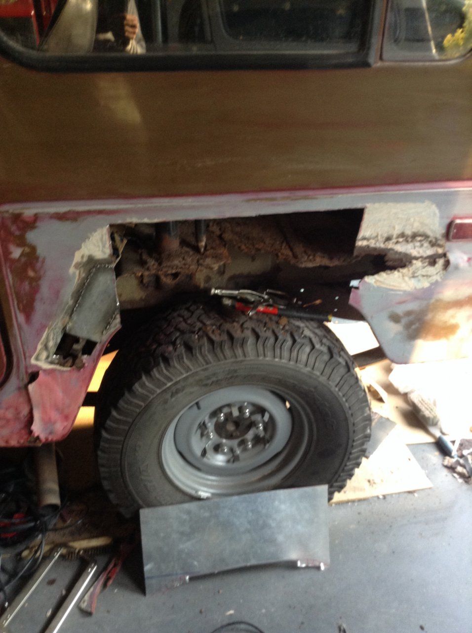

Sheet just got real, really quickly - I Peeked behind the bondo curtain! Yikes - bondo removal and missing quarter panel

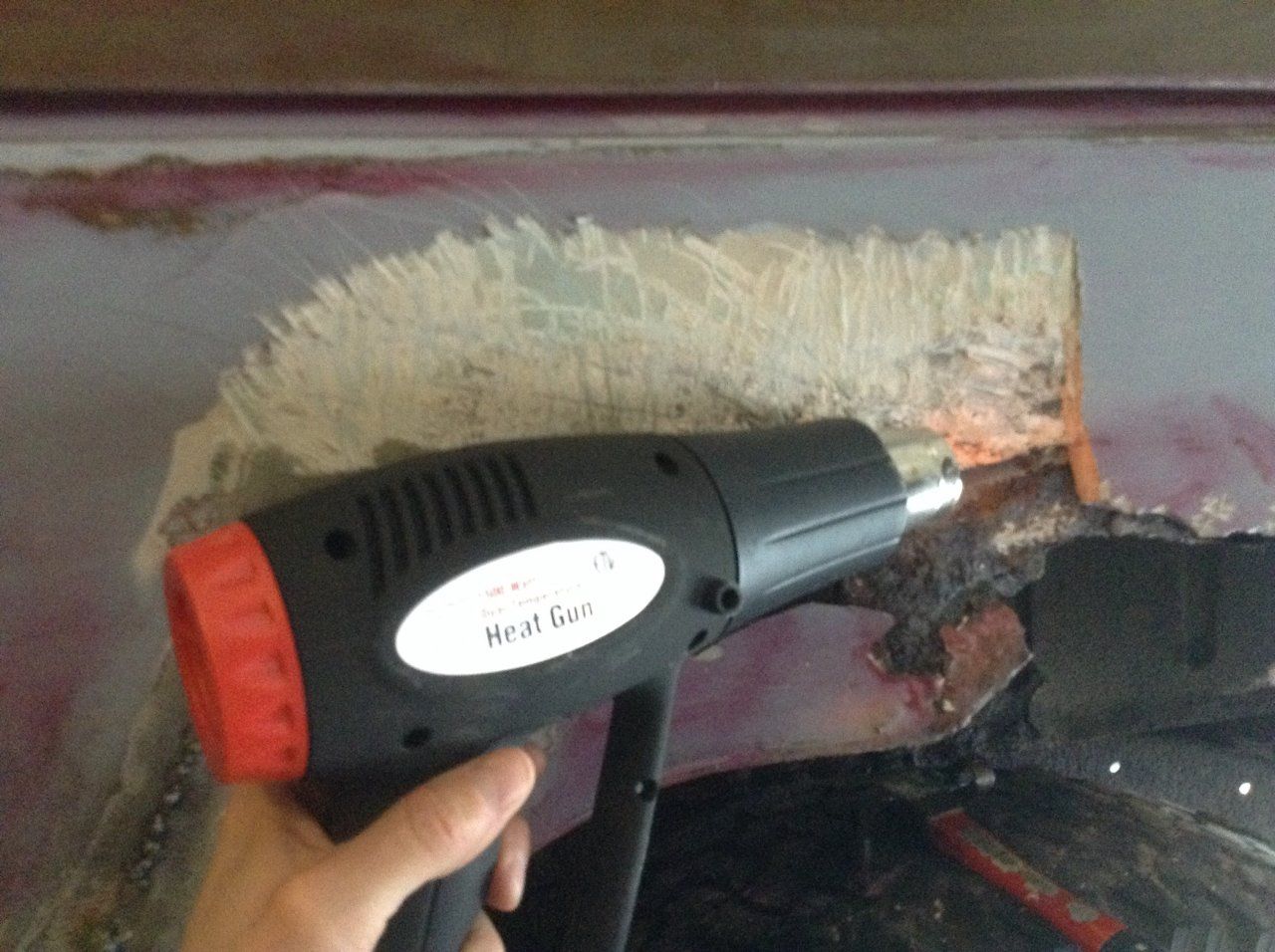

Decided to learn the hard truth by peeling away the bondo on the quarters to determine what kinda patchwork I'm up against. Well it turns out that I had about 1/3 inch layer in sections... And not much metal underneath. Looks like I'll be busy.
Here's some photos... And I've uploaded a few videos on youtube... Hoping to fill a void on youtube for diy fj40 vids.
My theory is to get the quarter panel somewhat decent and then remove the hardtop, rollbar and replace the wheel well that @fj40alex hooked me up with. I want to keep the top on for now to act as a brace to keep things straight.

Bondo removal with heat gun,,,, literally a third of an inch thick in parts.
Surgery after bondo removal... Not much panel behind he fiberglass

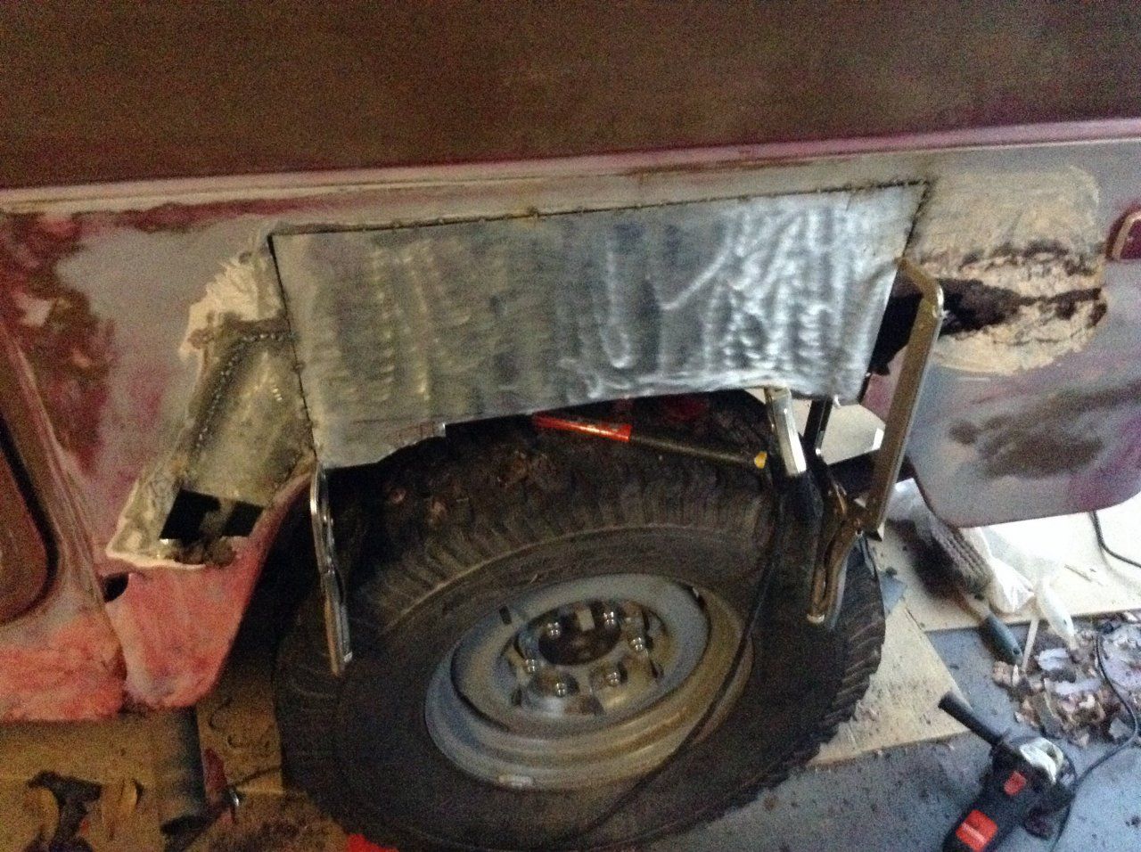

Quarter panel tacked
Fj40 diy quarter panel tacked in place (video 8)
I'm in for quite a ride but feeling strangely calm and confident

Continued to stitch together my steel quilt that some call a quarter panel. Also welded up and ground my lower quarter panel patch that covers the rear sill horn. No pic but it's in video 12 I think. Videos 9 and 10 show the root cause of the rust... The extent of it, and the hack job bondo and steel "repair"

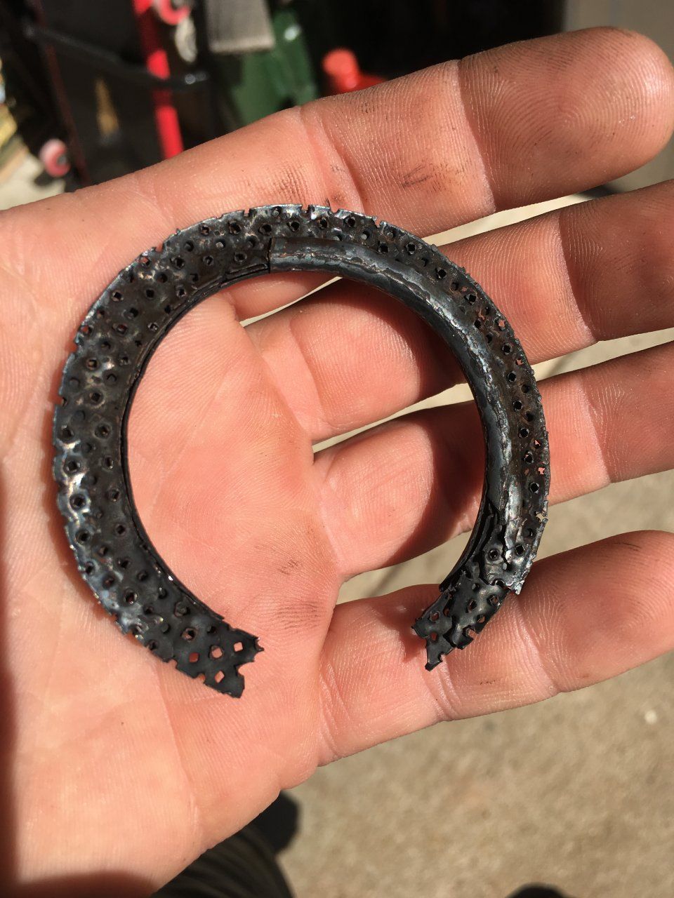

I finally found and installed this little goodie last night while I was getting all my parts together for some 80 repairs. Progress really slowed afterwards, for some reason.
