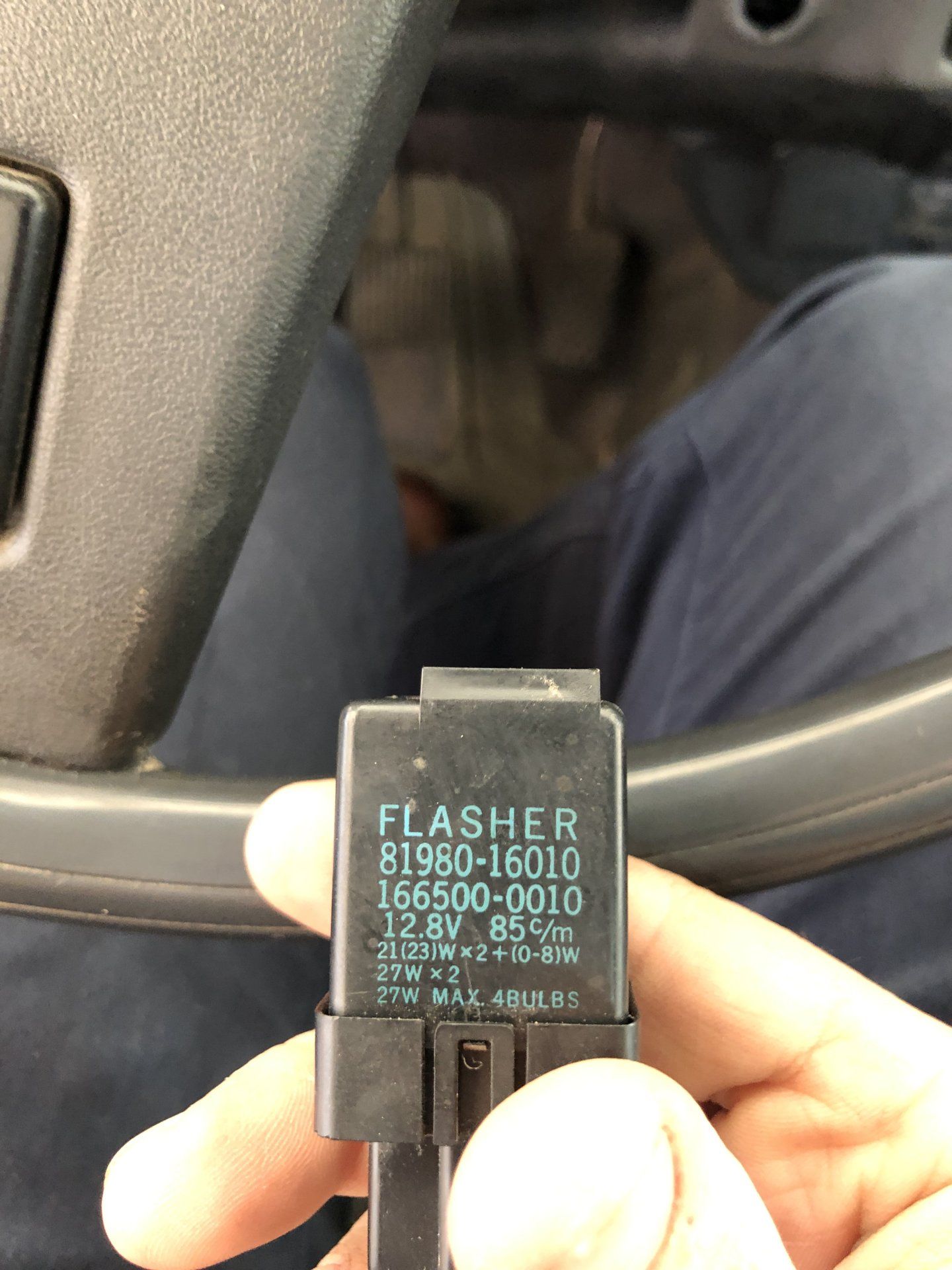

I just ordered the relay as a spare. Is the turn signal switch the next most likely?

I believe the hazards and turn signals use the same flasher relay (guessing). Maybe just the relay fried.
I’ve seen mixed reports as to what fails.
Would the relay fail open or closed? Some people report that either one or the other works or the lights will stay engaged instead of flashing.

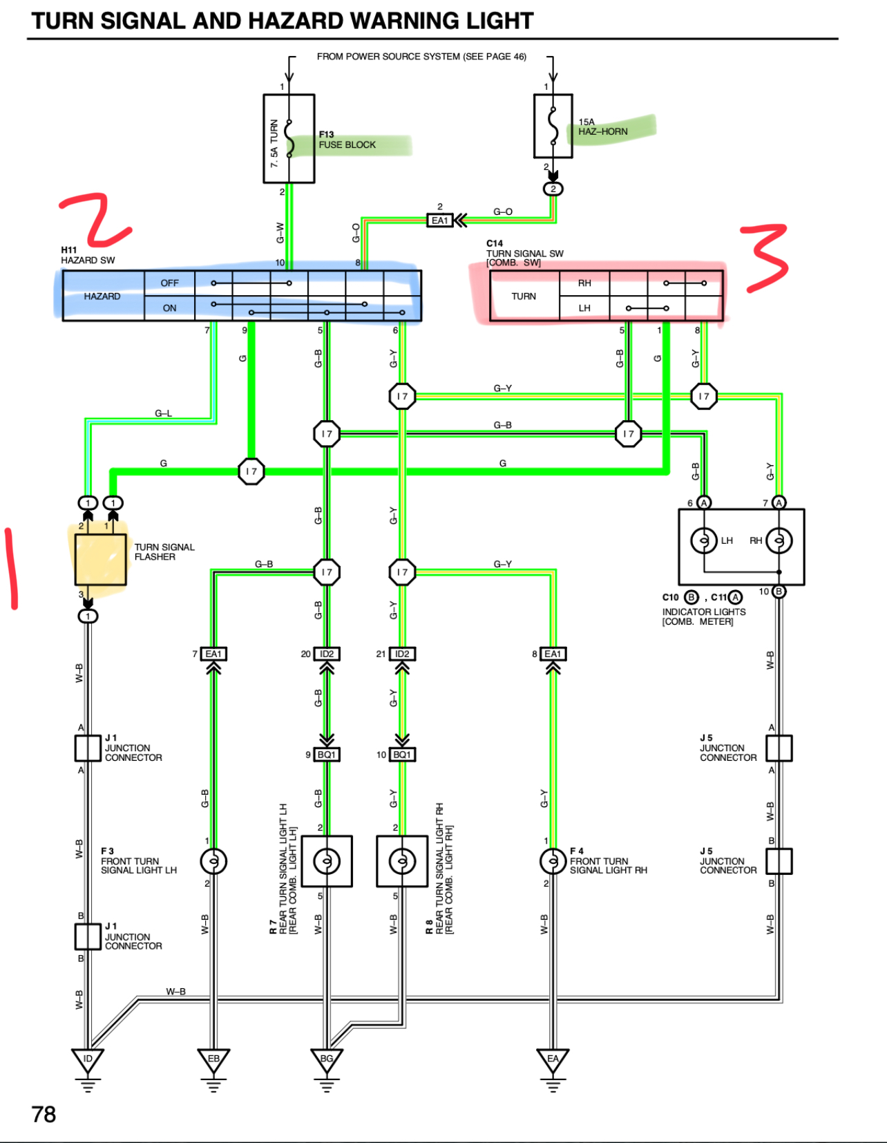

in the diagram above the turn signal relays work the turn signals but haz switch goes straight to the flasher. Assuming the haz/horn fuse has power and there is power to the hazard switch...if the flasher isn't clicking most likely you just have a bad flasher.
When you say "the relay block terminals don't get power" did you mean the flasher switch terminals? did you try and turn the hazard switch on and see if that powers it?

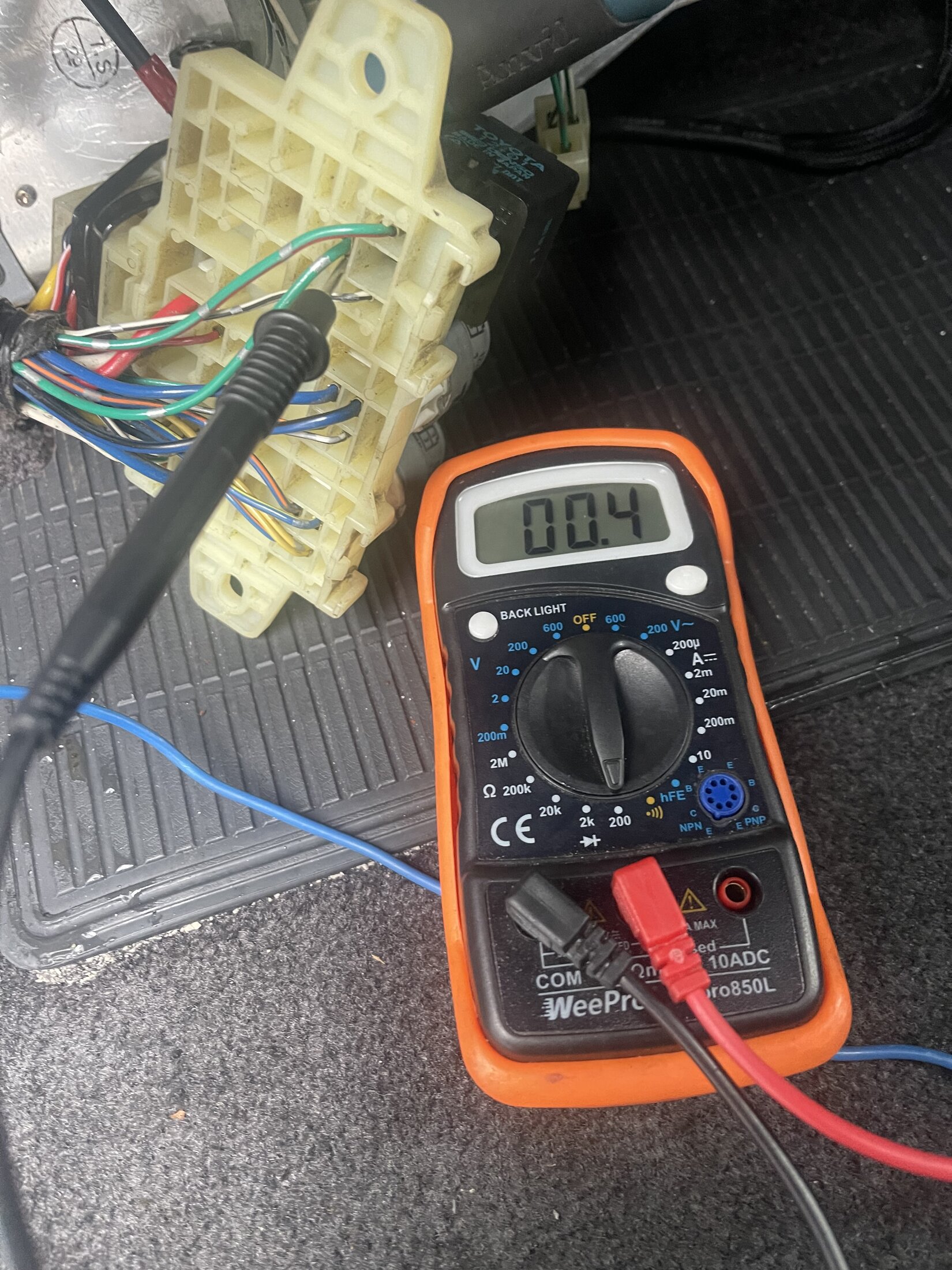

Back to post #2, pull the turn signal/haz signal harness plug apart at the bottom of the column just under the dash, and test the incoming hot wires to verify you ARE getting voltage to the switch harness. Next jump across the open harness on those same hots and activate the switches and test the outgoing pins with a grounded 12v test light.

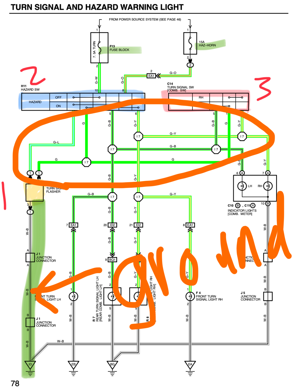

From an engineering perspective, the turn signal won’t work if the hazard switch doesn’t work. Looks like power is running to the hazard switch then runs to the signal and flasher switches. My guess it’s a bad ground to the flasher or no power to the emergency switch. I will investigate.

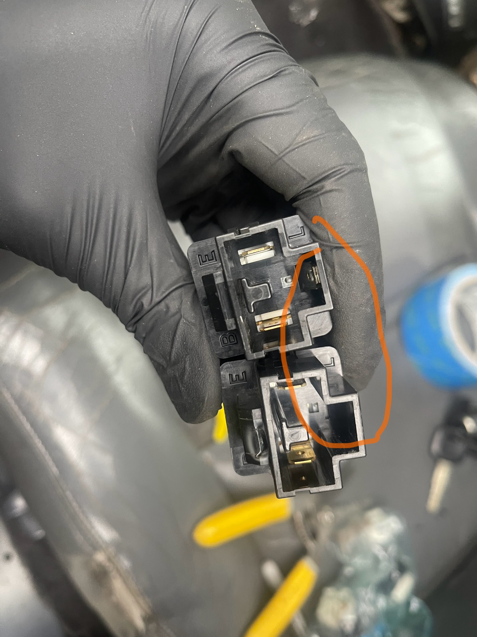

Don't know if this is your issue, but I can add that years ago I had the same symptoms on an '86 FJ60 and after replacing all the usual bits, I finally removed the Combo unit and I could see the Hazard switch had a nice big burn mark in it. Replaced the combo switch with a used unit and everything worked fine.

Happy day in the Pacific Northwest. I checked for power and continuity from the fuse boxes to hazard light, and to the flasher. Had no voltage to the flasher so I was like what went wrong. Pulled the flasher and noticed the power prong broke off somehow. New used one was bent.
