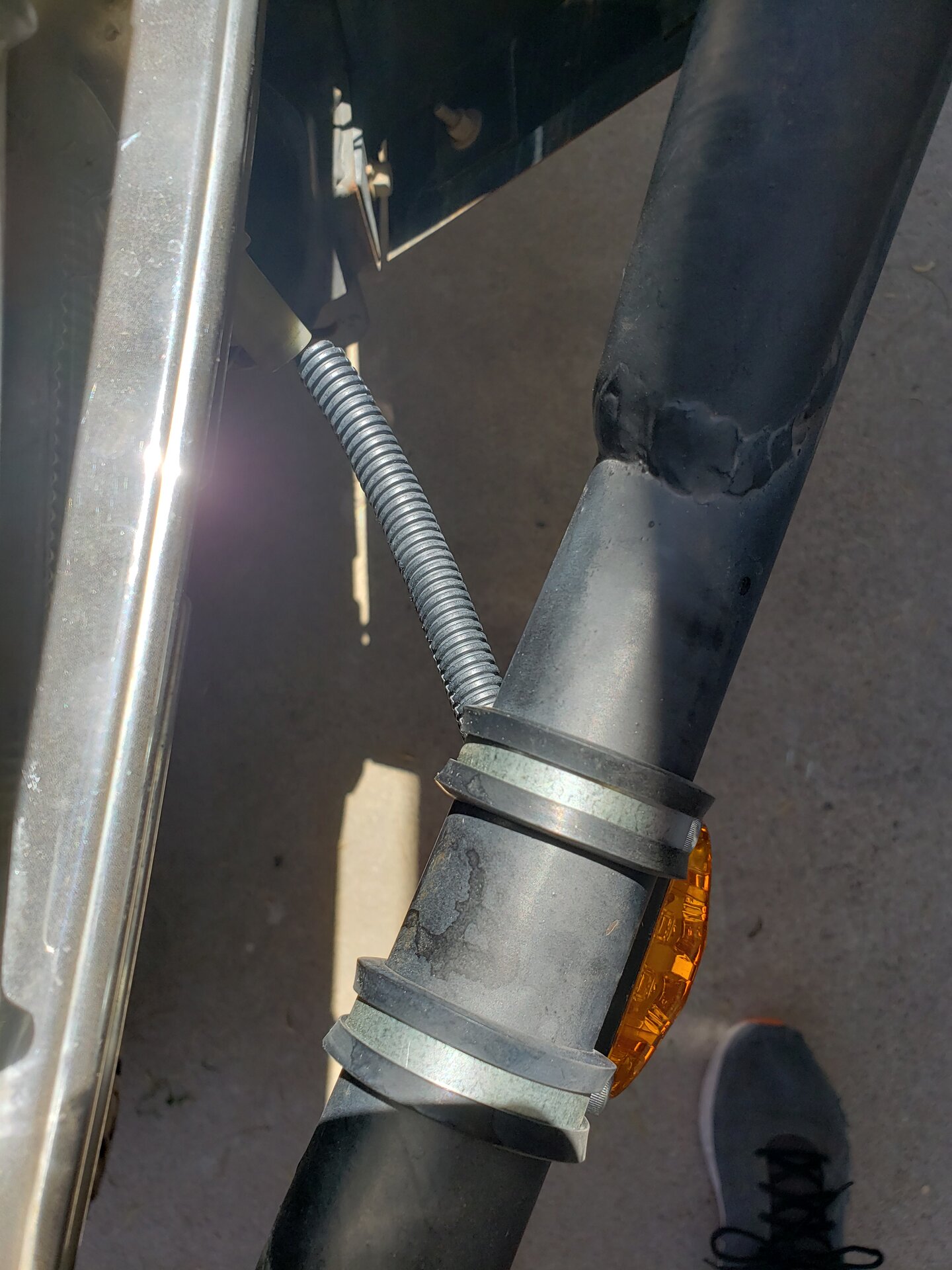

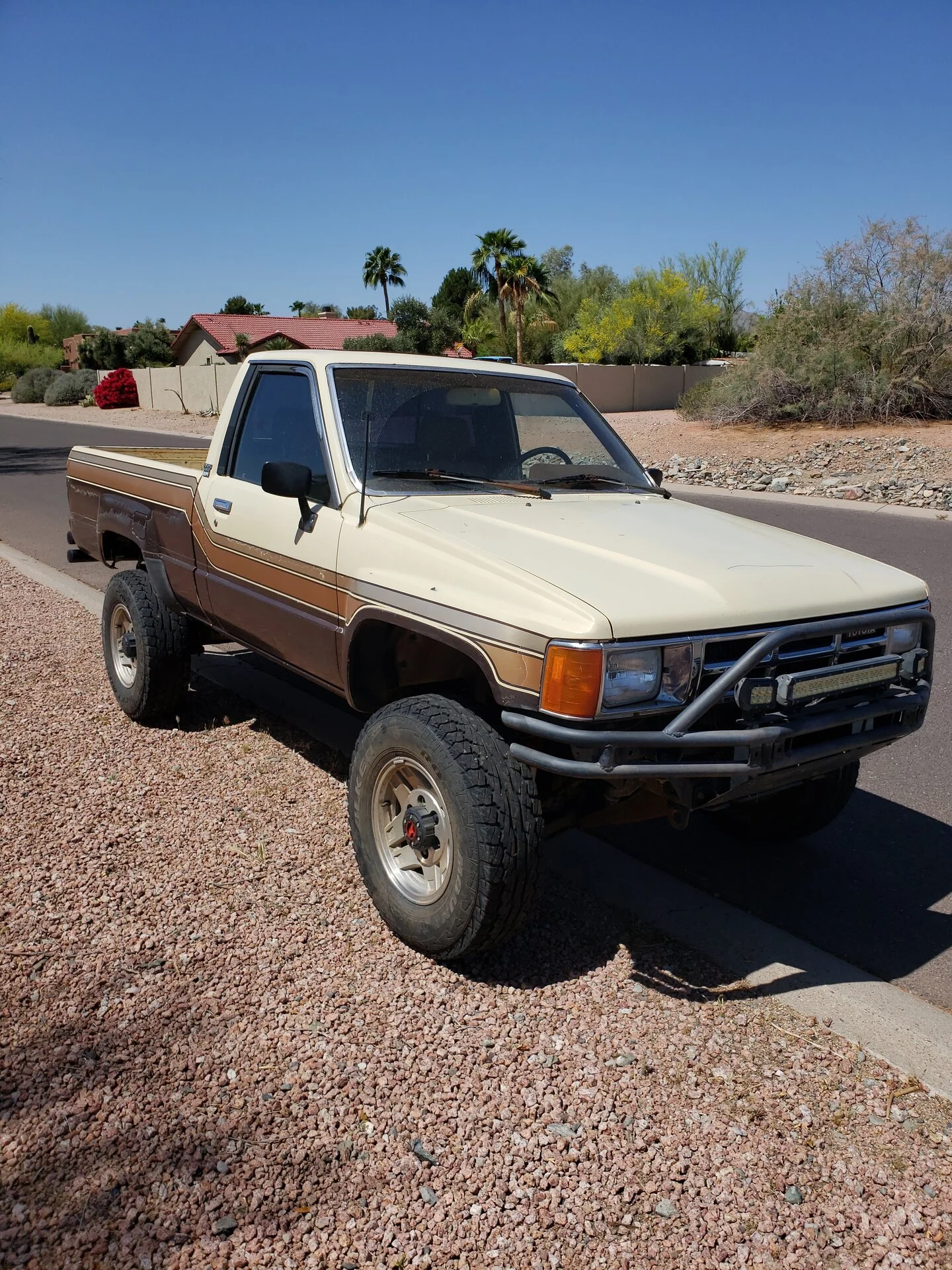

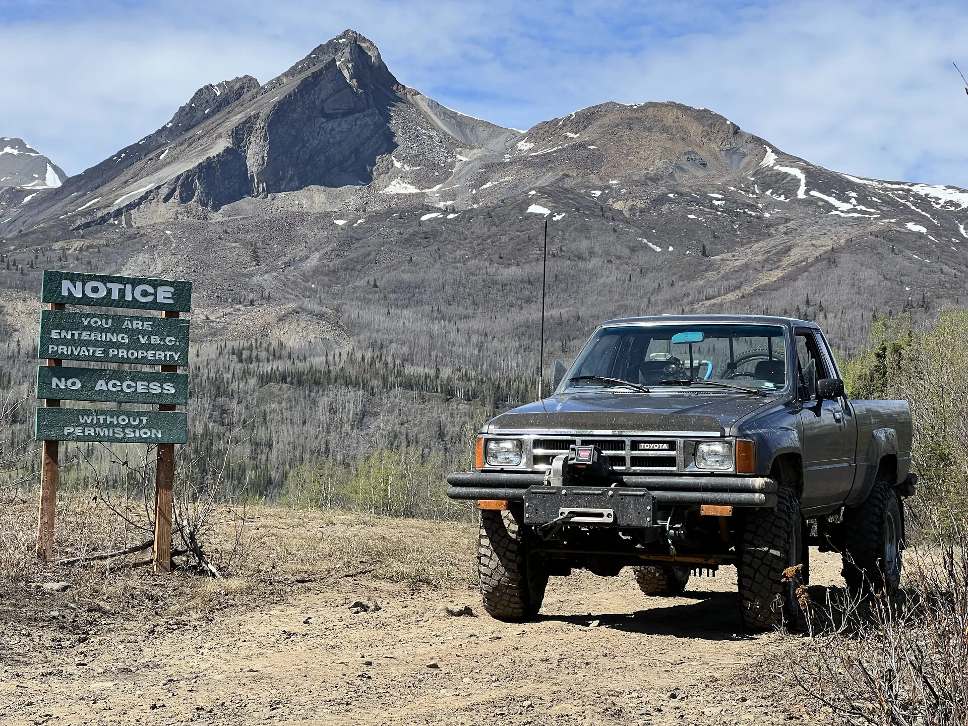

I’m looking for front turn signal opinions/suggestions. I didn’t consider them when building the winch bumper. My “temporary” solution for the past year has been pretty… hillbilly.

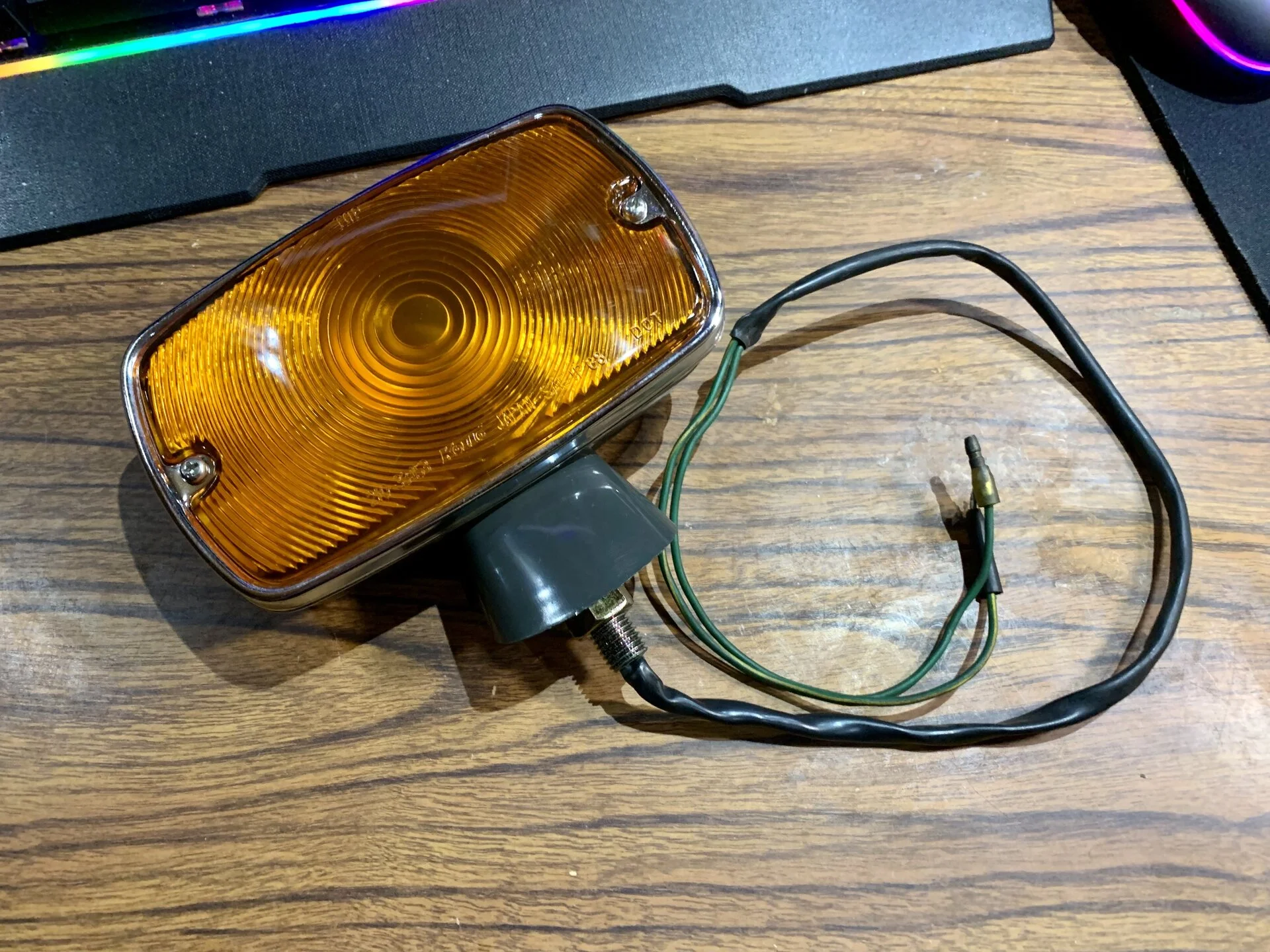

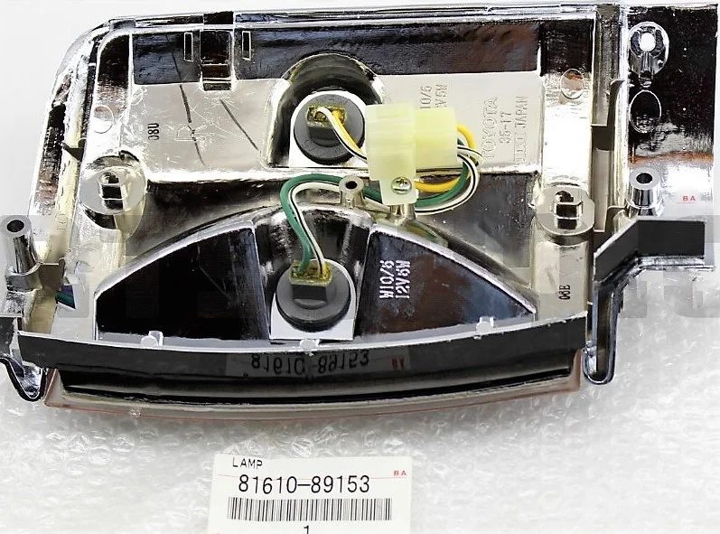

You could also pick up some of these. You can get aftermarket on Ebay. They are not plug and play and you will need to bubba wire them up. The Ebay lights don't have sockets. OEM does.

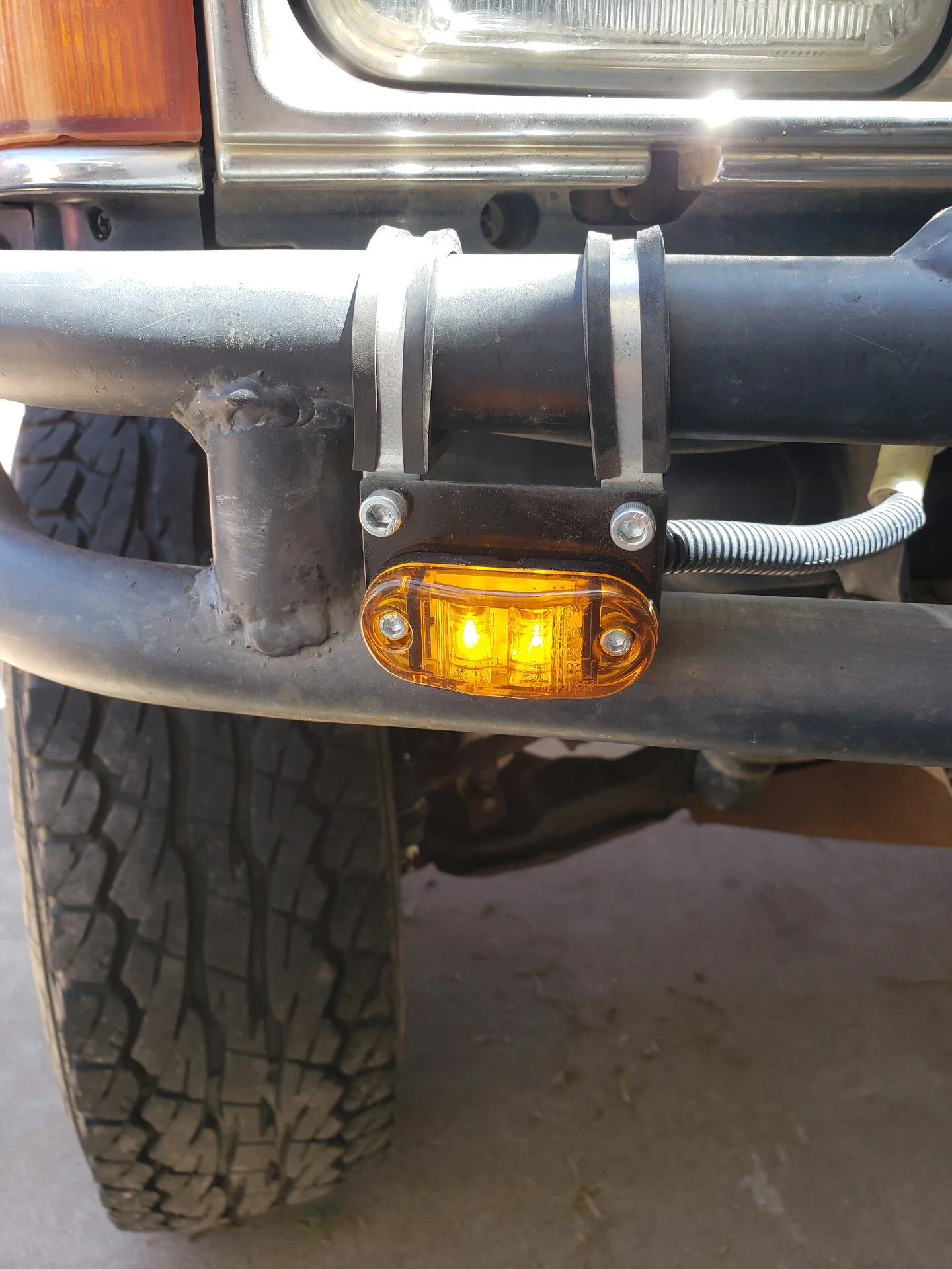

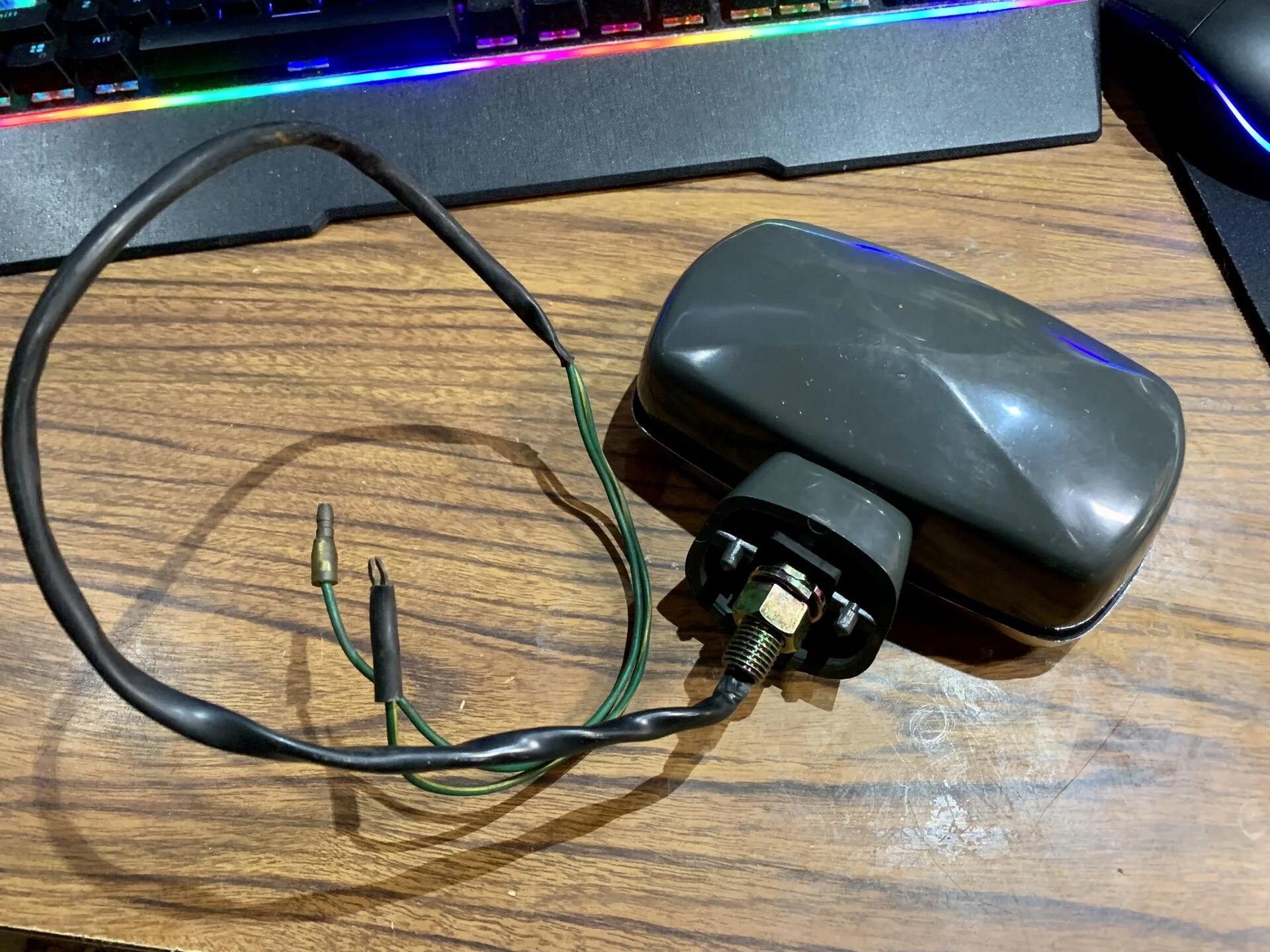

Way better than what I came up with but they at least work. The LED lights are from Low Range Off Road. Used the OEM connector from a bad set of front turn signals, wired the LEDs into them so as to not compromise the stock harness. Sure they flash fast because I haven't gotten around to adding a resistor to the lights, but they work. Yes I know you can get an LED flasher but where's the fun in that?

Kinda rough but cool

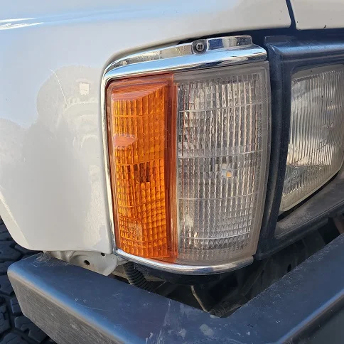

Does someone have a picture of a hilux that came equipped with the lights ToyotaMatt referenced?
I haven’t had any luck on google yet.
Thanks for the responses!
The lights Matt pictured are from a mid-year FJ40. I run them on my 1969.
the little sub harness with the 2 sockets is NLA .......fyi

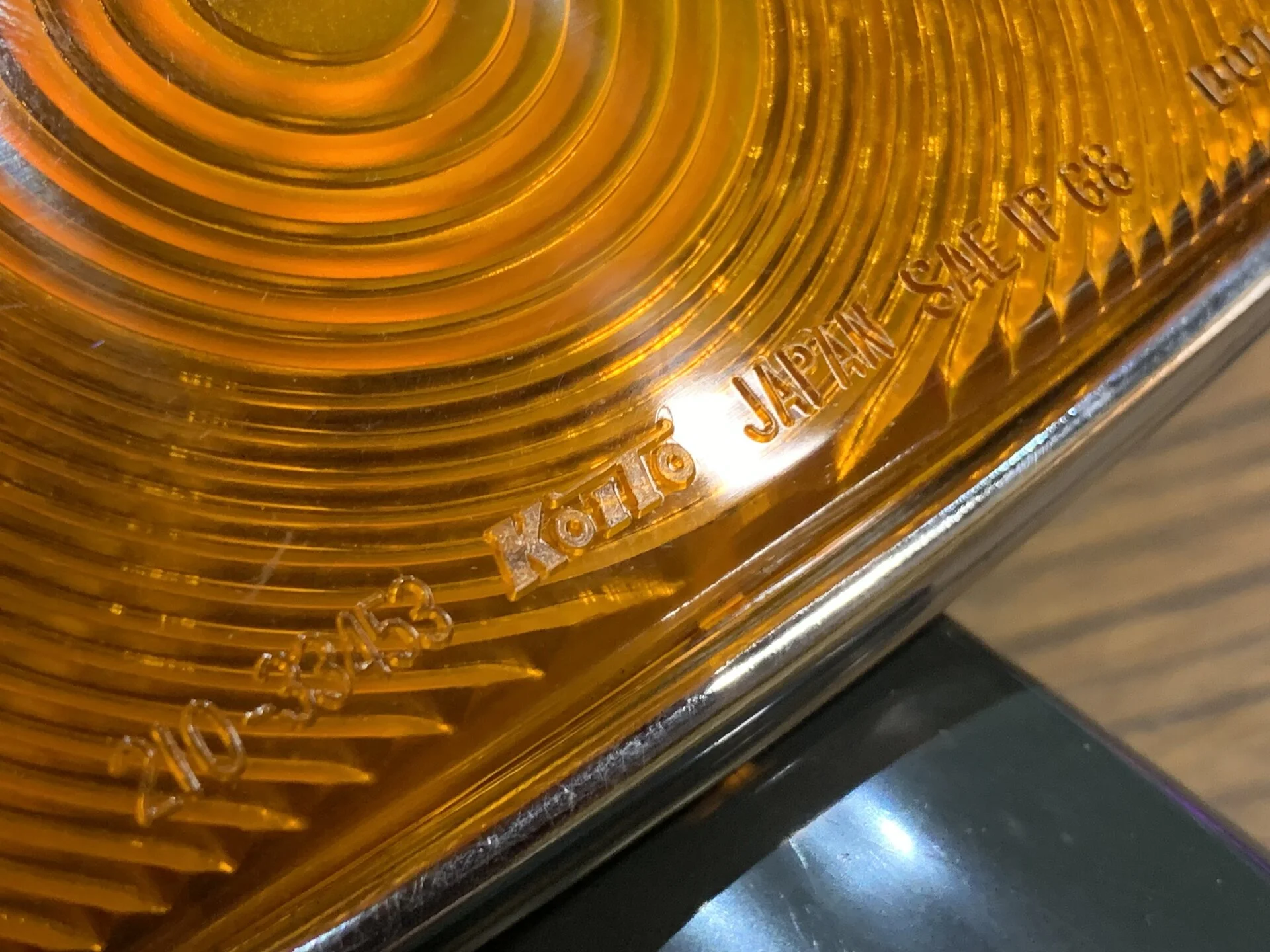

are these a NON USA lamp ?
i think so indeed
The lights I pictured from Toyota came with the pigtail. It does take come bubba wiring. They are not plug and play. I sourced the necessary connector at the boneyard and made an intermediate pigtail to tie into the existing wiring, without cutting the existing wiring.
The ebay aftermarket equilivant do not come with pigtails/sockets. As I recall, your existing socket can be used on one side, then you need to boneyard the second for the turn signal and wire them in. Or, maybe Matt can source the socket.
Pappy do you have a pic of the back side of these?
Definitely rough but worked at the time with the obviously homemade tube bumper. I just needed something to go blinky blinky in the front.
